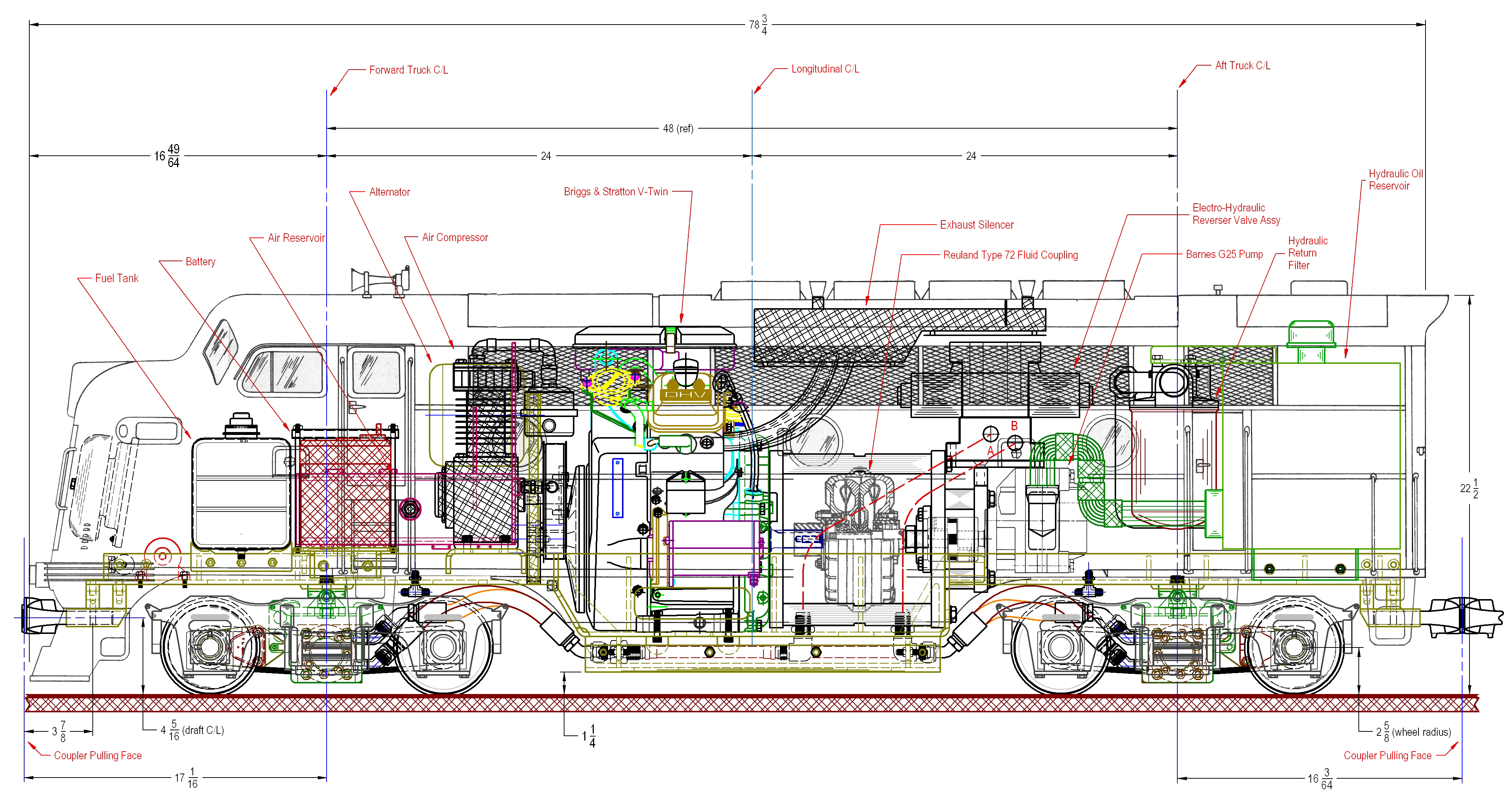

I have hundreds of photos that I took during the build process, but unlike the POC project, I haven't organized them into a website or anything. However, I'll upload a side view of the main drawing that I created as I was doing the design work so you can an idea as to what the finished unit will look like. The file is quite large, so please be patient as it downloads.

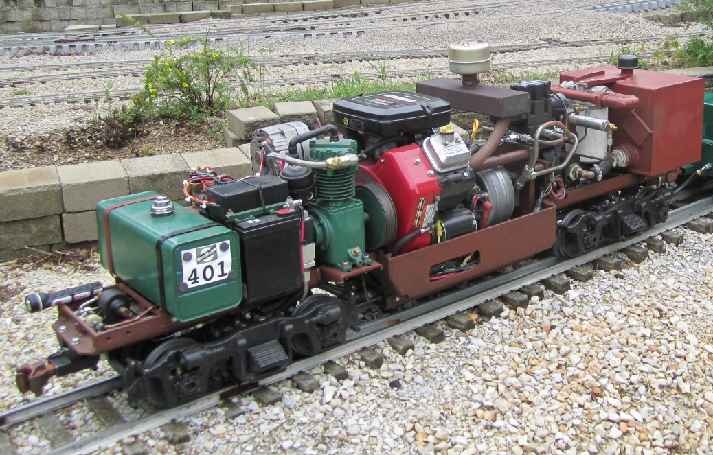

Some of it is off-the-shelf commercial stuff (e.g., prime mover, traction motors, etc.). Some is fabricated using off-the-shelf parts as the basis for the finished component (e.g., the brakes, which are built around industrial disc brake calipers). The rest of it I fabricated from raw materials (e.g., the frame). Modeling is all about taking readily available stuff and changing it into something that fits the application. For example, the fluid coupling is actually a part used in industrial conveyors. I was able to get the manufacturer to supply one with an output shaft machined to my specifications. Here's a picture of the unit without the body, taken during some testing at the railroad.
File comment: F7 wo/Body During Testing

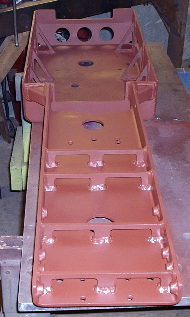

It depends a lot on how resourceful one is. I'm very handy with machine tools, can weld and can fabricate. Over the years, I've been able to get my hands on some machines for my shop (including a 250 amp industrial MIG welder), so I'm able to accomplish a lot of fabricating tasks without having to pay someone else to do the work. Most of the cost in the locomotive is in items such as the prime mover, fluid coupling, traction system, etc., as I can't make things like that. Some stuff, like the frame sections, I had a local shop laser cut the steel and form it to my drawings. I then completed the frame buildup in my shop, using a jig I built to align everything. Here's a picture of the partially completed frame on the jig plate after welding.
File comment: Partially Completed Frame
There are about 7500 dollars (US) tied up in the unit. I guess that if I had to pay someone to do everything in it I'd have three times that much money invested.
Sweet! Thanks for the peek! :D

PostPosted: Tue Nov 13, 2012 6:10 pm
Your welding looks like squirrel poop BDD...
But I am in awe at your overall proficiency.
Squirrel poop? The welds are fairly large because that whole frame is fabricated from quarter-inch hot-rolled steel. The picture doesn't help any. I'll see if I have other pictures that give a better view.
 Post subject: Re: TAKING A BREAK
PostPosted: Tue Nov 13, 2012 6:24 pm
Well, considering.... If you are using flux core wire for your MIG welder this must be OK then. But I've had many years experience in exhaust work with MIG welders using Argon and Oxygen gas and the results are way superior.
EDIT: Let me correct that, been more than a few years since I did exhaust work, since all manufacturers switched to stainless steel and I had to leave that line of work. So my immediate memory was lacking in my previous comment... For welding, I believe we used Argon along with the MIG welders. For the cutting torches we used Oxygen and Acetylene. And this was work done on everyday vehicles on the road.

Posts: 808
Location: Croatia
How do you bend the steel to get that U shape chassis, it is 1-2cm thick after all. Or do you order it that way?
