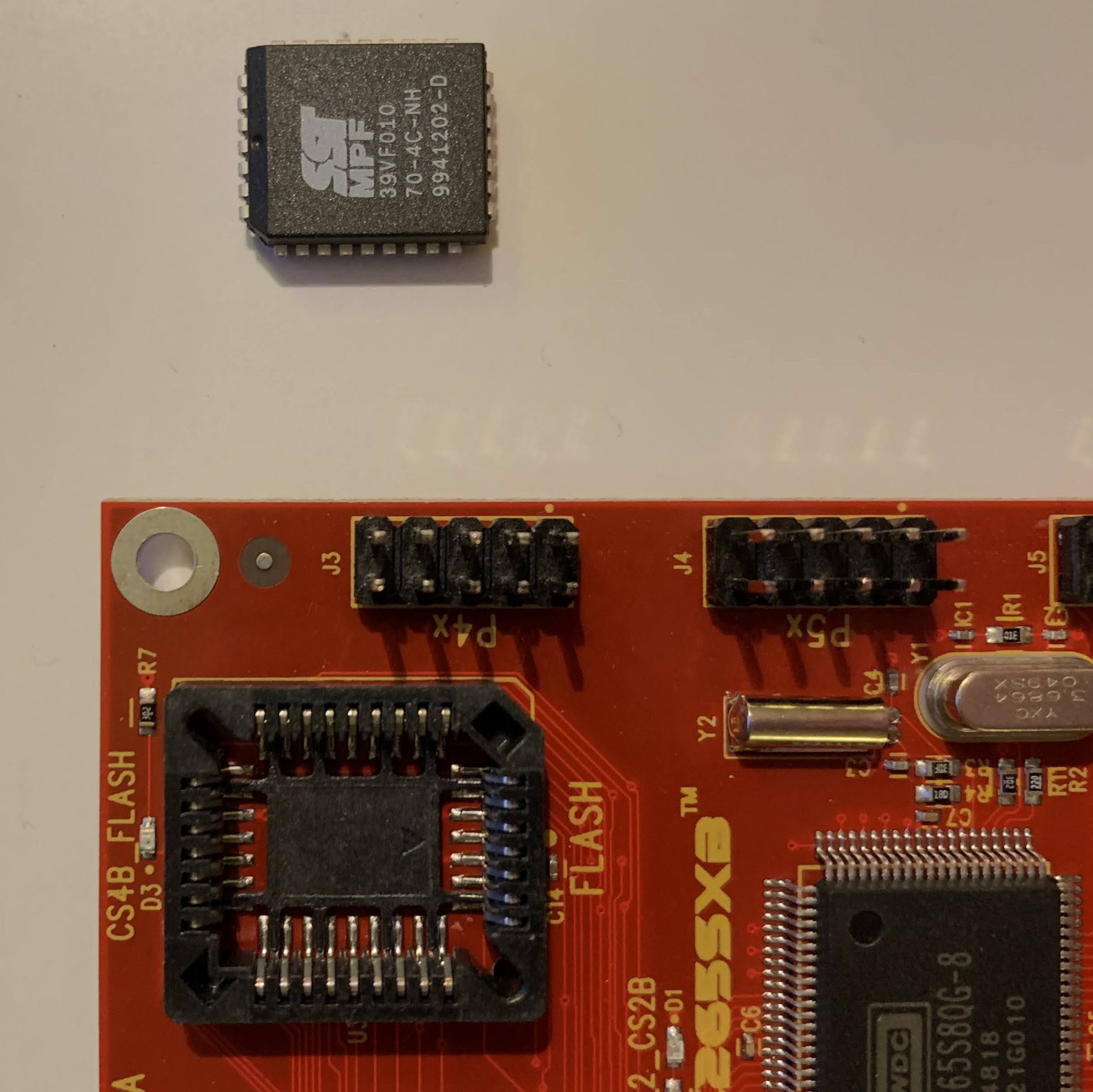

Hi, I have a very n00b question, so sorry for that. I have my new W65C265SXB board and a 128k flash chip. I have never come across a 32PLCC socket so I am a bit unclear which way around I need to insert the chip into the socket.
File comment: board and flash chip
The chip has its notch on the top left corner (the photo shows rotated 90° counterclockwise). However, the socket has the notch on the bottom right corner. Will I have to insert the chip with the writing upside down, that is, 180° rotated from the orientation on the photo?
Thank you,
-- Olav
 Post subject: Re: W65C265SXB
PostPosted: Mon Jan 30, 2023 6:39 pm
Posts: 983
I was confused because the forum software decided to show the picture on its side... the only way that chip will fit in that socket is with the chamfer top right on the forum image; bottom right for the original picture.

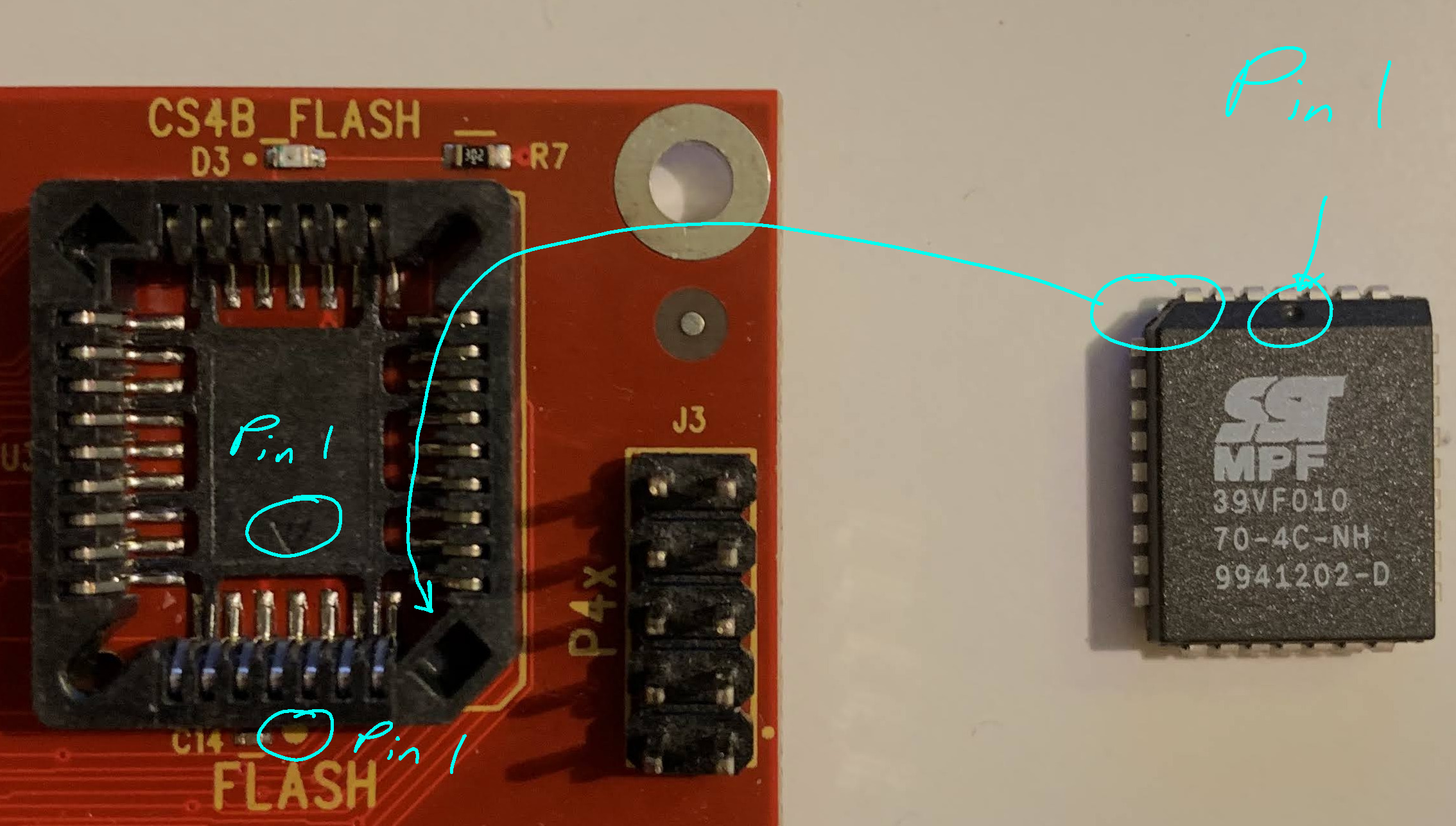

PostPosted: Mon Jan 30, 2023 6:49 pm
Posts: 255
PLCCs have pin1 in a weird spot - it's in the middle of one of the sides. The IC has a dimple, the socket has an arrow, and the silk screen on the PCB has a dot to show where pin 1 should be. The angled corner helps make it so you can't fit it in the socket backwards. Your intuition on how it goes into the socket is correct.
File comment: Pin1 locations on PLCC, socket, and PCB
PostPosted: Tue Jan 31, 2023 2:56 pm
Joined: Sun Nov 27, 2022 5:53 pm
Posts: 3
SamCoVT wrote:
Thank you very much. In fact, before connecting the board to USB, I noticed that I had indeed managed to insert the chip the wrong way round.
— Olav
