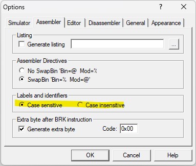

puta: .MACRO A
.DB $DB,<.beta,>.beta
.RS A
.beta:
nop
.ENDM- Sun Mar 08, 2026 1:10 am
- Forum: Emulation and Simulation
- Topic: Problem with the .MACRO function in Kowalski Simulator
- Replies: 10
Re: Problem with the .MACRO function in Kowalski Simulator
OK, if the Case Sensitive option is enabled, there is no error message. With case-insensitive selected, I see the same error message.
I'll take a look at the code when I get some time.
thanks for pointing it out!
Daryl
Daryl
