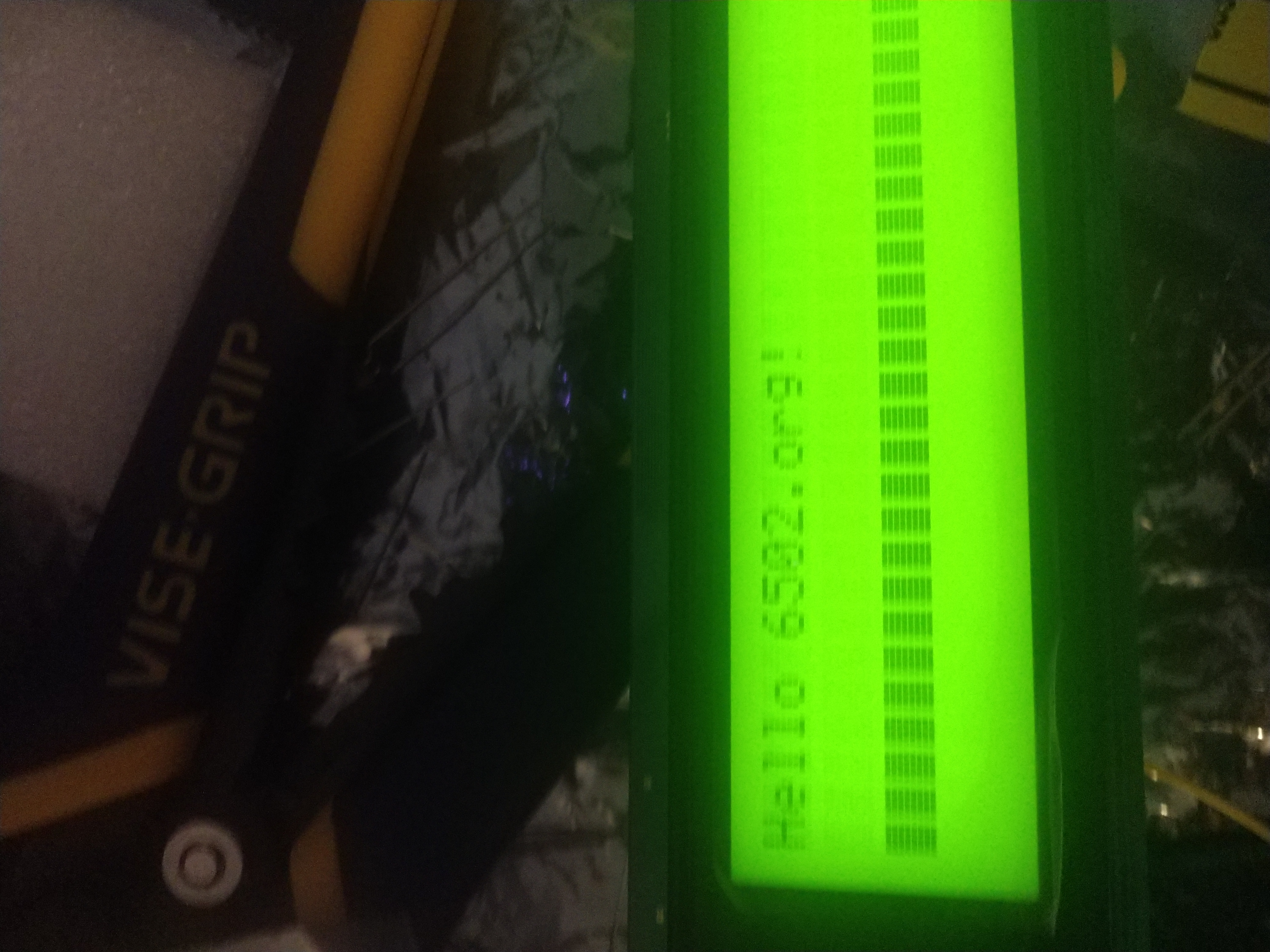

- Mon Mar 25, 2019 5:41 pm
- Forum: Programming
- Topic: First build 65c816 based machine programming
- Replies: 28
Re: First build 65c816 based machine programming
As promised. The surprise is here:
EDIT: sorry for rotation, and bad quality, my phone apparently didn't like my surprise
