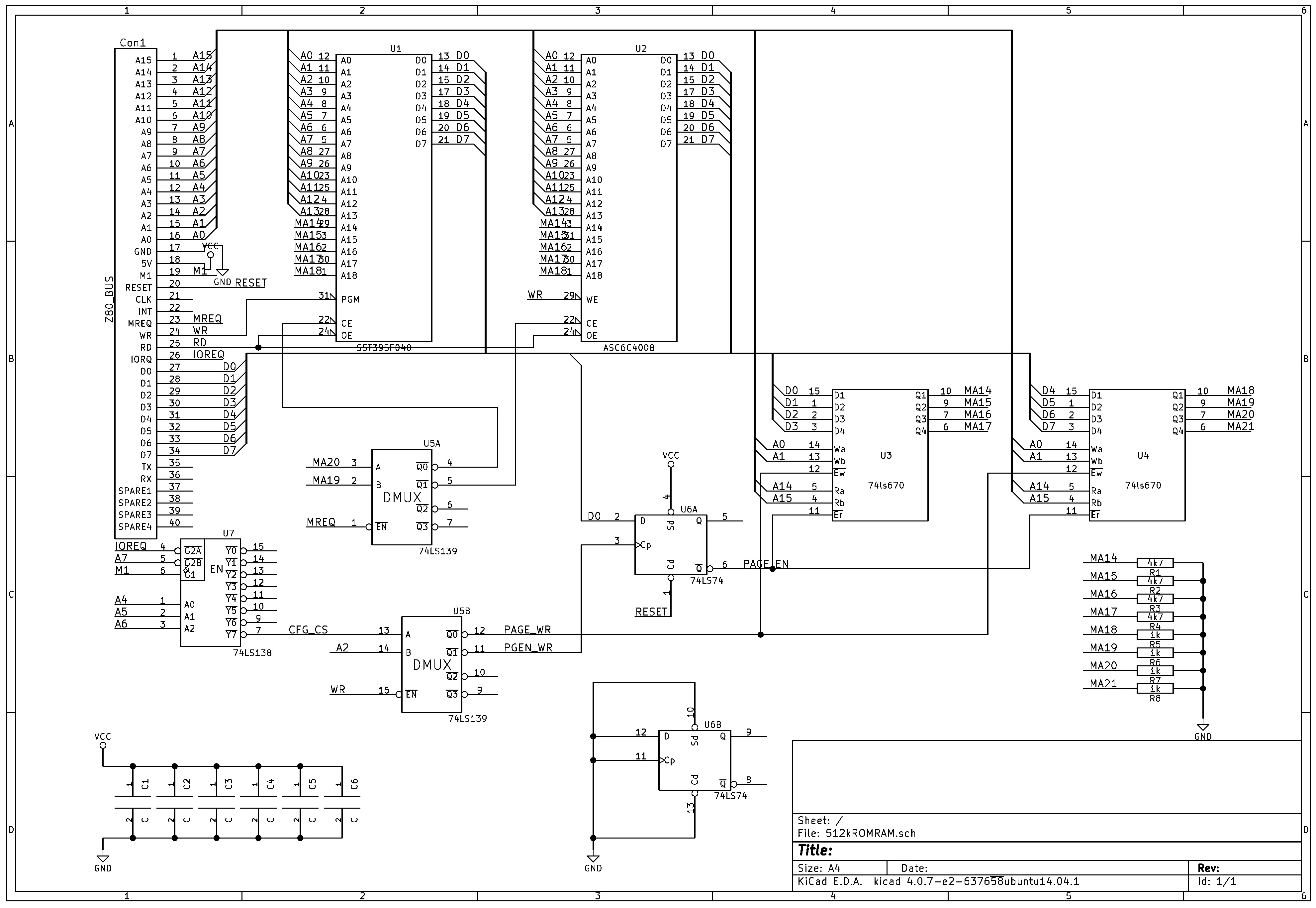

Just an thought... the RC2014 Bus project has a 512KB RAM/ROM card which uses a pair of the '670 register chips.
There's also the Fuzix project that supports the memory expansion and has a 65C02 port as well as the normal Z80 CPU used on the RC2014 series of boards.
Attached the PDF schematic ...
