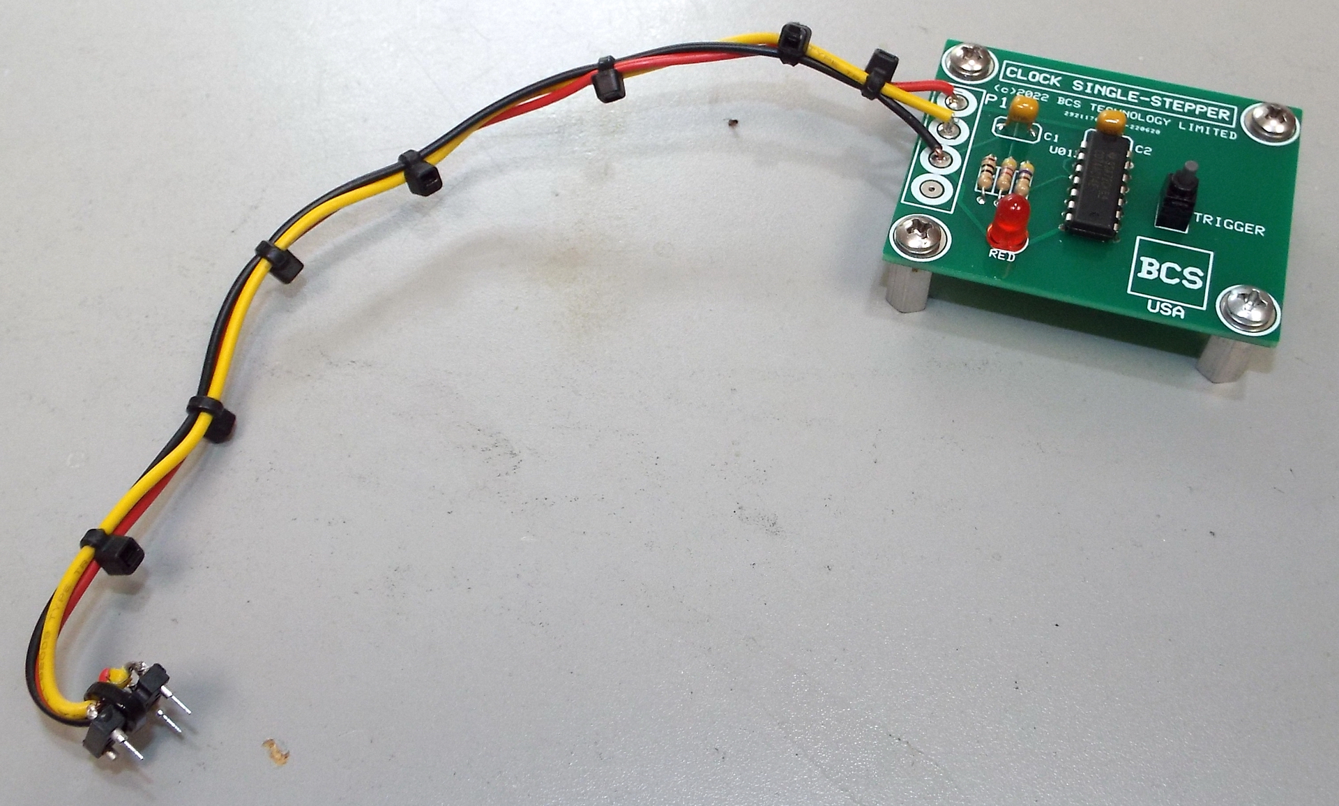

I have used several brands of SRAM in my contraptions and have, at times, used the clock stepper gadget to single-step a program.  In one case, I was working on that when I got called away and was not able to return to what I was working on for several days.  When I did get back on it, things continued without an issue.  In other words, the SRAM (and the 65C816) was truly static.
Clock Stepper Gadget
