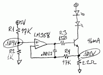

I like figure 2 the most there, except that I would turn it around if the only power supply available is 5V, because the 741's (and similar, like the LM358's) inputs don't operate within 1.5V of Vcc, and the output won't operate within 1.2V of Vcc, whereas they do operate all the way down to ground.  (The output's pulling-down current falls way off when you get below 0.6V; but if you don't need much current, like a few µA, it'll go down to a few mV.)  So here's my revision (drawn on the back of a literal envelope I pulled out of the trash in front of me):
The IC is one section the common LM358 dual op amp.  It's similar to the '741.  The transistor's hfe hardly matters.  The values shown will give you about 46mA, with the exact amount depending mostly on parts' tolerances and the op amp's input offset voltage error.  R3, R4, and the capacitor are there to prevent putting another pole in the transfer function and losing the phase margin and getting an oscillator.  It may not be necessary, kind of a belt-plus-suspenders thing, but experience causes me to automatically just put them in for applications of this kind.  I still prefer just the simple resistor recommended further upthread though.
