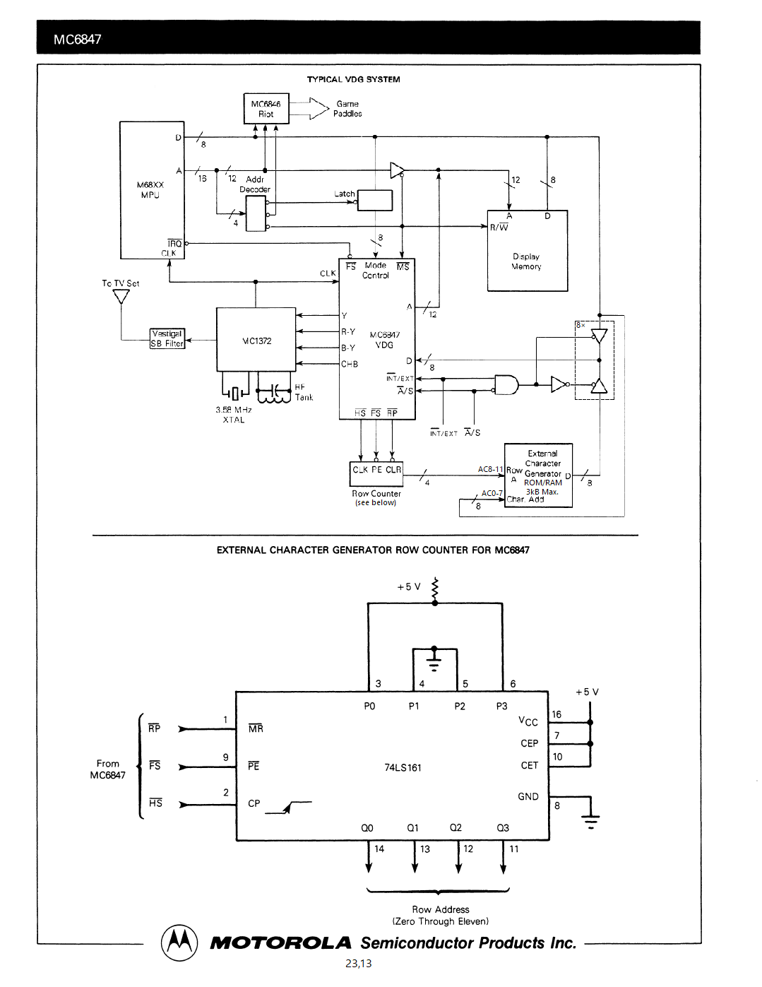

Looking to use a 6847 on a project, and wanted to try to use the external ROM for characters noted in the datasheet. But, I am confused about how to feed some of the character ROM address lines (the 8 that appear to be coming from the Data bus, but that does not make sense to me)
Anyone ever used the external ROM on the 6847?

I have used the 6847 before, but not with an external character ROM. I assume you are referring to the schematic figure 23 in the data-book? It may be a little confusing but data lines coming from the display memory need to be connected to the address lines of the character generator. The address lines from the VDG are feeding the display memory to select the memory cell containing the character to display. Then having the character to display on the data bus, it is used as an index into the display ROM. There are tri-state buffers to isolate the CPU data bus from the output of the generator ROM.

Thanks, but I already pored over the data sheet (downloaded). However, Rob Finch's comment about the data from the regular memory (which is addressed by the VDG) being used as the top 8 bits of the address for the external ROM makes sense to me. I was trying to determine why data lines would be used as address lines.
Thanks, that made it click. I was trying to determine why data lines would be connected to address lines. It makses sense now.

I think it is more likely that the lower address bits are connected to the counter, and address bits 4 to 11 of the ROM connected to the data bus. That way the first row of a bitmap is at address 0, the second at address 1, etc. Each character would use 16 consecutive bytes then. The FF might be to control one of the other signals on the 6847 like the alpha vs graphics signal. Or to disable the external ROM.

Note: As far as I know the advantage of using the data byte from the display memory for the lower address lines (0 through 7) of the character generator and the counter output (the 161) for the upper address lines (8 through 11) is that when using the maximum of 256 different characters, all data in the character generator memory is contiguous and the size of the generator memory is only 3 KB instead of 4 KB with intervals of four unused bytes in between every twelve bytes (when using the counter for address lines 0 through 3 and the data byte for address lines 4 through 11).

Putting the counter on the upper bits is a decent idea. It would work well if the display memory is used to store the glyphs and the glyphs are copied there from ROM. One thing to consider is finding or writing a piece of software that will allow editing character glyphs and save them in a binary format compatible with the way the ROM is organized.
