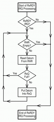

I got familiar with the NXP 26- and 28-series UARTS back in 1990 and never looked back.  Although NXP has since discontinued those series, Exar and TI continue to be second sources for the 26C92 and 28L92.  I consider the 28L92 to be superior to anything in the 16--- family, especially since the 28L92 has the sub-microsecond counter/timer (C/T).  Both Kevin and I use the C/T to generate a jiffy IRQ for timing purposes—it’s very stable.
FIFO usage isn’t at all difficult once you understand the principles—it’s a simple looping operation in assembly language.
Receiver Access During IRQ
Transmitter Access During IRQ
The 28L92’s FIFOs can be configured to be 16-deep and the device can be set up to interrupt at one of several fill levels.  I have my receivers set to interrupt when there are 12 or more datums in the FIFO, which tactic minimizes the risk of a data overrun (as does use of CTS/RTS handshaking).  I have the transmitters set to interrupt only when the FIFO is empty, which makes it possible to load 16 datums into each transmitter in a single interrupt and then go on to something else.  Can you say “greatly improved transmit throughput?”  :D
Judicious use of the FIFOs will substantially reduce interrupt activity and enhance overall system throughput.  I can simultaneously run all four serial ports on POC V1.3 at 115.2 KbpS in both directions without bogging down the machine, even at the relatively slow Ø2 rate of 4 MHz (usually, Ø2 is 16 MHz).  Efficient eight-channel serial I/O using the 28L92 (four of them) is possible in a system running at 8 MHz or better.
