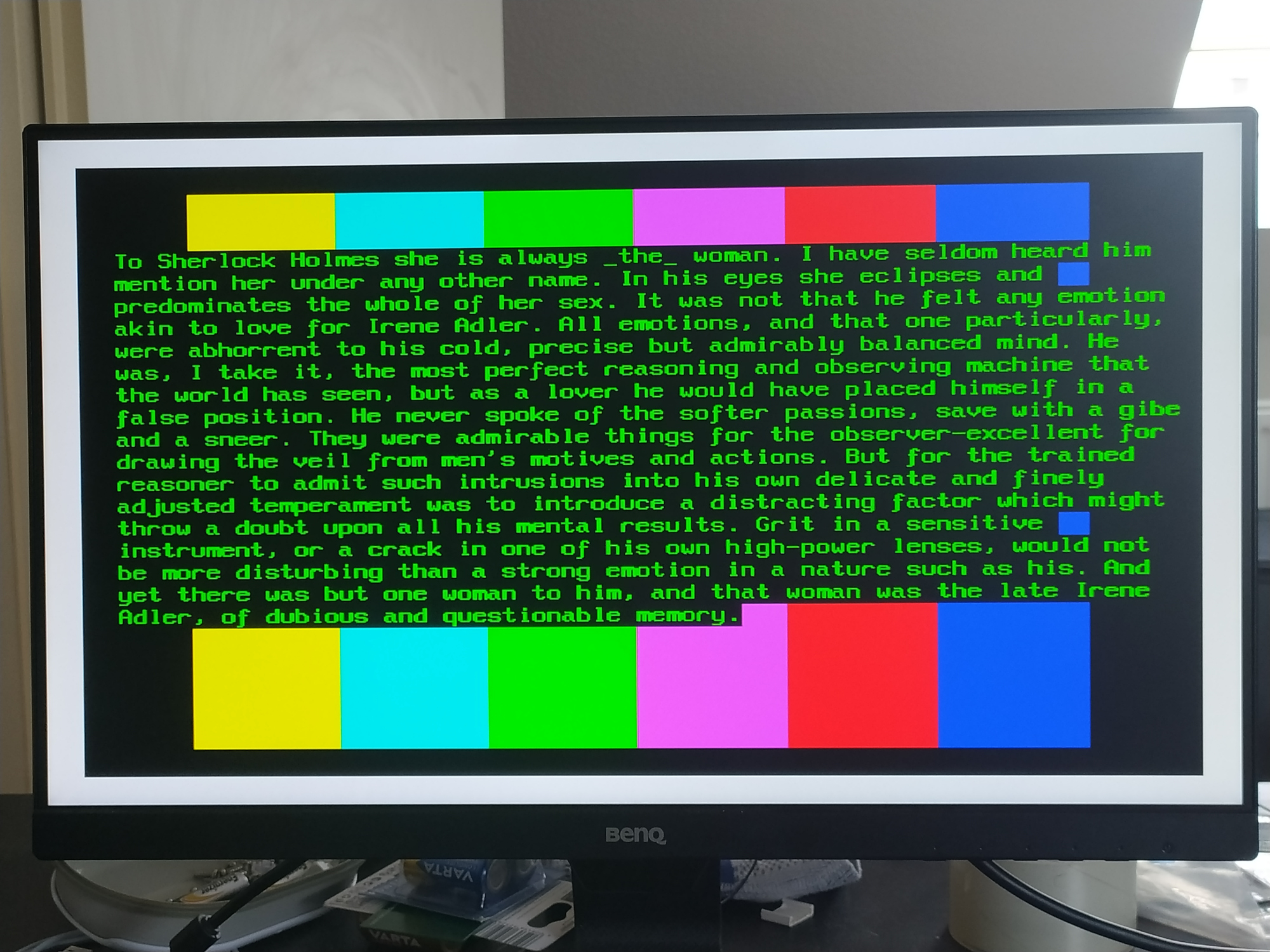

I'm following Troy's graphics controller chip series with interest and have been persuaded by the PIO module to move from the STM32 and Nucleo to the Pi Pico - specifically because it has a lot if internal memory and can generate 640 x 480 VGA in 4-bits per pixel without too much trouble.
Immediate requirements were to find a tool-chain that worked. Because the official getting started approach didn't/doesn't work with my Linux Mint setup (it couldn't download MS Visual Code, and apparently couldn't work with a pre-installed flatpak version of same) I looked at other approaches. The CLI approach appears to work, but one needs to keep a careful eye on one's working directory, or the damn thing compiles everything in your directories - which took half an hour.
Also, I wanted to work with C, not Python. I'm not fond of a language which can return '1', "1", or "Tuesday" and still be syntactically correct, and nor do I appreciate the effects of invisible white space...
So as a hopefully temporary approach I ended up with Arduino. I don't particularly like the UI, and the way it handles included files is truly appalling, but I can live with it.
This is a dot display just being used as a character display for now. But I have a number of further steps/issues to resolve:
  • The arduino ide does not include the pio assembler. I have located one online here which appears to work: https://wokwi.com/tools/pioasm from which assembled .h files can be included. But...
  • I have as yet no idea how to implement the interface between the 6502 bus and the rp2040. I am planning some small number of registers, but some of them may require multiple writes to fill a buffer which in turn is written to the screen.
  • On the other hand I can copy my existing ps/2 translate() routine and the ps/2 input is just a shift register, so should be easy.
I started with a build here: https://github.com/Pancra85/VGA_graphics which is itself a rewrite of Hunter-Adams' college course. It took a little work, in particular to uncouple the second buffer and get the full 480 line output (for some reason, I don't appear to be outputting line 479 so still investigating).
However, I have the immediate task working - though I need to find a better font file than the two I have, I have some video working (unfortunately after taking this pic I pushed the auto button on the monitor and it has irretrievably moved everything six inches left... I'll sort it later.)
More to follow when it happens...

Meanwhile, this morning's efforts:
- changed the font for one a bit more elegant (https://github.com/viler-int10h/vga-tex ... ADABL7.F16 - though given the way the display spreads the pixels it might be worth looking for a skinnier font)
- got rid of some naughty utf-8 characters in my Sherlock Holmes extract
- zoomed in past the beer

Currently deciding whether a text scroll - which requires about 150k memory moves - is fast enough to avoid the need to maintain a separate virtual tty screen and copy each character from that. Which of course still requires a lot of memory access...
Phase one is to make a basic 'any char to screen' tty (from the serial port for now). Phase two is to handle things like BS and TAB; phase three is to implement some subset of ANSI to allow colour selection and cursor positioning. Somewhere in there, probably, a flashing cursor (or maybe a vertical bar tied to the gaps between characters).
Only then do I get onto actually joining it to a bus; from there I can handle ps/2 and serial...

True, but it requires a continuous process of building the display based on the tile map, whereas at the moment a character need only be rendered once, until it needs moving. I also want to keep the option open to generate some sort of graphical display, which again would be difficult to render on the fly (the processors inside are going to be doing other things too :) )
I have considered - but not implemented - a half-way house where text-as-ascii is stored in an 80 x 30 array, and rendered from there to the video buffer only when something changes, but only those parts that change (i.e. I don't need to redraw all 2,400 characters -> 150k pixels every time I hit a letter, only if I do a scroll). Scroll will definitely be faster than a redraw, with memmove().
Swings, roundabouts... I might know later today whether the scroll speed is adequate.
