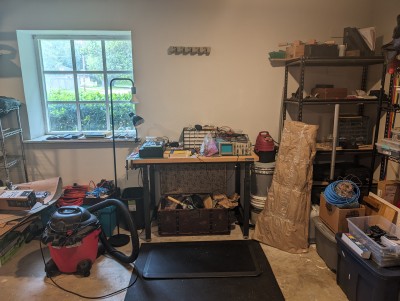

Our new house has an outbuilding in the back yard, which our landlady has given me permission to finish and turn into a workshop. This is a fairly pricey project, however, since the outbuilding is totally unfinished and not climate controlled, so I'm saving that for the fall. In the meantime, I've converted a corner of the garage into a makeshift workshop and partially unpacked my tools and supplies.
