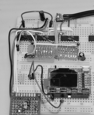

Short: it works with jumper cable but fails with jumper wire and I am confused
Long:
I am trying to read PS/2 keyboard and I would like to read each byte in paralel similar to Ben Eater.
I wired something on breadboard, and it did not worked. I realized, that for my PS/2 keyboard are pullups necessary. I put the connector and pullups (3.3 kOhm) on universal board for mechanical stability and got some results.
Then I rewired all the Rat Nest Cables with neatly organized U-wires and it stopped to work. After some testing and debugging (with the Rat Nest style again) I found, that all works when there is one specific cable and changing it to wire makes it to fail. And it can be repeated.
The idea is simple, put data to shift registers. As the clocks start by falling edge, invert it to start with rising edge, like 595 likes. Make another clock with little delay (2xNOT) to fetch register for displaying. See, if it works, then try more following steps.

I added two 10 uF condensators to power lines and three 66nF condensators over chips (best I have at hands at this point), also I grounded the chain of unused NOT gates to minimise noise, but no visible difference.
All I have are Gabotronics XScopes XProtolab - slightly better than nothing.
There is some software for it, which enable mouse setting parameters, but the screen is pixel to pixel perfect copy of the miniLCD, just drawn in smaller pixels, so no added information and I did not snap it.
The voltage shown is either zero or 5V, Channel 1 is Clock, left wire (black), top line, Channel 2 is Data, right wire (red/grey), bottom line, Trigger is on Data fall edge, moved to left part of screen.

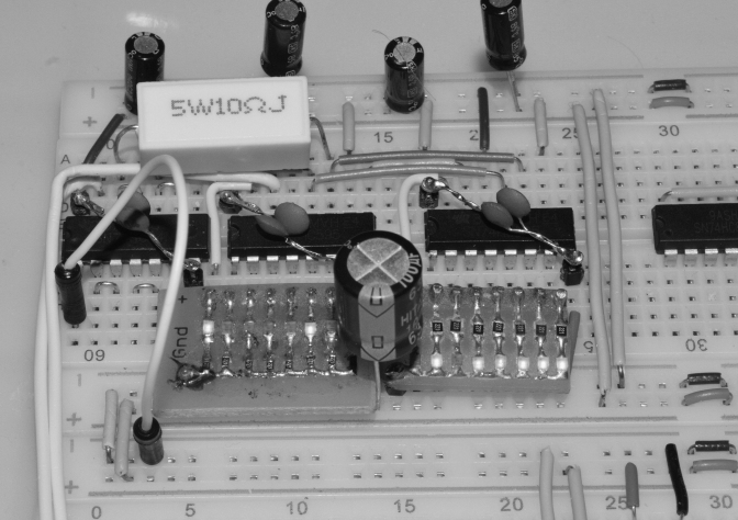

I tried to improve power filtration - made pair of caps for each IC (120nF), also I made the power for PS/2 to go right along the Clock and Data lines and put grounded wire accross the LEDs input lines, but it did not help
max filtration
max filtration
Here are the caps, also see, that the wire is the same width as the cable (right bottom for comparation).
caps, wire, cable, power line
The power is transferred to the breadboard from this cheap laboratory source - so it is 5V and 0.1-0.2A depending on number of LED shining (and it limits the current, so it is sefa from shorts). I made my own connectiion to the board 2x3 pins + LED (left bottom-center) in my photos it is usually on the top, near the ICs (thick cable for 240V - flexible and low resistance)
The wires (stripped from one long ethernet cable) should not be problem too, as PC/s is 10-16.7 kHz and I buid this 3MHz with them and no problems with bad connections (some problems with power distribution, so I will make external power bus to each breadbord line later)

I tried many improvements, but with better connections and filtrations it all went only worse, so I came to idea "what if the wire is not too bad, but too good?" which make sense for me (the "wire" connections are usually more reliable, then the "cable" one) and switch the "problematic wire" for random resistor (3k3 was the nearest to grab] - and it worked! I then shorted the resistor and it came bad again. I halved the resistor by placing other one in paralel, still worked. So I tried more resistors, worked with anything I had at hand - so I ended for now with the lowest value (and biggest footprint, but it fits nice there) - 10 Ohm - and it works regardless filtration or not
10 Ohm resitor works regardless filtration or not
So the schema is now this way
This schema works, lets wait for Schmitt-trigger
I suspect, that as the fall and rise edges of PS/2 are slow, that there are some "spikes"/noise when the NOT gates convert it to digital 0/1. My scope is not able to see that, it would need another magnitude of quality/price tool for it.

Yes, I totally agree. But here the breadboard is for prototyping, before I will move it on PCB.
So far I found out, that PS/2 need pullups, that I made mistake in my design and that there is real problem with noise (and I will see, if it can be fixed by the Shmitt-triggers). And there is also something I would like to test about SW part. (So far I saved 3 iteration of PCB, which are both money and time like month or two)

On the start of this discussion I found out, that this circuit works with cable, but does not work with the wire (more short and tight jumper) and called the place "problematic wire".
Later I found, that this problem is repeatable even when all kinds of power improvement was taken. (Like bypass capacitor, routing, ...)
Later I found, that the problem is, that the wire is just "too good connection" and that it can be simulated by placing resistor there (3k3, 1k6, 220, ... just any I had in reach), so I ended with the lowest I have here now - big white ceramic "5W 10 Ohm" one. On the scheme it is the one just under the title "This works" with sad emoticon near it, as I am not happy with this solution.
Also this one (random and improvised resistor) fits to the place naturally and is visible reminder, that there is some really problematic, which have to be improved later. (And that it is this one exact place/connection)

- fast edges or glitches causing malfunction, for example SRAM chips can be quite fussy about input signals
[SOLVED] HW problem on breadboard - can somebody help to exp
Posted: Fri Mar 15, 2024 6:54 pm
by gilhad
Today arrived 74HC14 Schmitt- trigered NOT chips, so I changed it with the 74HC04 NOT and it worked even with the "problematic wire" and without any capacitors and power enhancements at all - so the problem was in the slow edges of my PS/2 vs. fast gates with large "forbiden/grey areas".
Also I found and fixed error in the schema (RCLK vs. RSCLK) and improved it (not little delay, but other phase instead - way more reliable and sufficient for the usage), so I can do next step and try decode it in CPU and if it will work (it should), then next step will be to finally do stable PCB :)
As for pre-cut wires - they fit the right lenght as I pre-cut them on the breadboard, where they are planned to be :)
