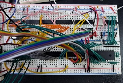

This is not strictly a 6502 circuit, though it is designed to work with my 6502 computers - however I thought it might be of interest anyway, and I apologise if it's off-topic or otherwise not interesting.
As I mentioned in another thread, I wanted some basic VGA output for one of my computers, and wanted to build something much simpler than my past video circuits which have all been graphical. This is what I came up with, using some GAL SPLDs (ATF16V8) to reduce the chip count:
The circuit has three ATF16V8 PLDs, two 74HCT590 8-bit tristate counters, three 74AHC574 8-bit tristate registers, a 71256-SA12 32K SRAM module of which 4K gets used, an AT28C256 32K EEPROM module of which 4K gets used, a 74HCT166 parallel-in serial-out shift register, and the VGA oscillator (25.175MHz). It fits on two rows of breadboard:
It is black and white only, with no support for character attributes, but I may add this later. The font is one of the standard VGA fonts, 8x16, in a 640x480 resolution mode - this existed on PCs but was not so common, they usually used 9x16 characters in a 720x400 resolution mode instead. So we get 80x30 characters on the screen:
Regarding its operation, I'm not sure how much detail to go into, but I'll write what comes to mind and do ask if anything is unclear.
At a high level it reads a byte from RAM once per eight VGA pixels, and shifts it out through the shift register. Hence it does this at an eighth of the pixel clock frequency, which is about 3MHz. The RAM is plenty fast enough to do write operations in between these reads, when they are necessary. Unlike my previous circuits, this one is not tied no the same clock as the CPU - I let them run on separate clocks. Any writes from the CPU are captured in storage registers, forming a 1-deep FIFO, and processed by the video circuit when the time is right. It's up to the software code to not write more frequently than the circuit can support, but this would actually be quite hard to do with a 6502, you'd need a very fast clock speed and a very simple data stream.
The "control" PLD controls the timing signals for the various components, within each block of eight horizontal pixels - it tells the counters and RAM when they can output to the buses, tells the shift register when it should load the next 8 bits of data, and watches out for writes from the computer and, if one is pending, it arranges for the storage registers to output to the buses instead of the counters, and sends the RAM a write-enable pulse at the right time.
The "horizontal" and "vertical" PLDs work in tandem with one of the counters each, to generate the sync signals for the monitor, as well as the reset signals for the counters and an "on" signal which shows when the monitor is not in a blanking period, hence we should output visible pixel data.
In more detail, here's the code for the control PLD:

Talking of output-enables, an important factor in this circuit is that the outputs from the 74HC590s are used to determine the next states for the PLDs, but these outputs are also not always enabled - they are only enabled when COE is low. This means that it's important for the horizontal and vertical PLDs' clock inputs to have their rising edges during that period. For the horizontal one that's straightforward enough, but for the vertical one it's less obvious because its clock signal comes from the horizontal one. As the horizontal one is clocked by the end of the COE signal, this means COE is not asserted when the vertical one is clocked. However I delayed the XOE signal by one clock tick so that, at this point, the bus would at least float, which is sufficient. I ought to go back and find a better way to do that really.
There is also a bug, it seems, with write operations where sometimes - maybe one it a hundred - they don't go through, or perhaps write the wrong data. I don't think they are writing the wrong addresses. It appears mostly worked-around by making the software execute write operations twice, which I guess reduces the chance to one in ten thousand that it fails! I haven't worked out what actually causes it yet though, there are several places it could be going wrong en route from the computer to the video RAM, and if the problem persists then I will look into it more.
You can also tell how much trouble I had with a circuit by how many passive components it has in it. There are quite a few decoupling capacitors in this one, and there's even one straddling across the shift register. This is because the shift register was giving me a lot of problems. I think this one is actually broken because if I connect its pin 1 (serial input) high then it seems to bleed this into the other data, even though it should be getting loaded before this value has time to propagate to the output; similarly if I connect it low, everything goes black. It is an input so I didn't want to leave it unconnected, and I found that connecting it high through a large resistor seemed to work.
I also had trouble with the clock edges, even though it is physically right next to the oscillator. I added parallel termination to the clock line at the shift register's clock input pin - I think this is 220 ohms, it is a value I've used before for this exact same purpose and it fixed a lot of flickering and sparkling around the text.
At some point I would like to add colour support, and perhaps get rid of the ROM and let the font definition live in RAM with the framebuffer. I have a scheme in mind to hit the RAM four times during the eight pixel cycle, to do this - once to read the attribute byte, once to read the character index, once to read the line of pixels to from the character, and potentially a fourth time to write new data into RAM. This would involve three different possible sources for address data for the RAM, rather than just two, but I think it should be fairly practical to achieve and maybe a cleaner solution than having a separate RAM IC for storing attribute data.
I also thought about some kind of hybrid text and graphics support, but haven't fleshed that idea out properly yet - I'd only want to do it if it can be done without too much complexity.
In any case it looks like the circuit as it stands should satisfy my immediate needs, so I don't know if/when I'd come back and make those changes.
