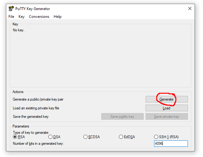

Click Generate
and wave your mouse around until the green bar is satisfied.

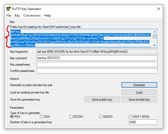

Once the key is generated copy the Public-key text...

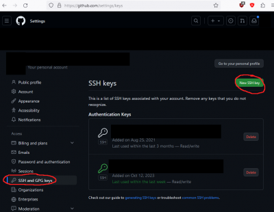

...into a new GitHub SSH Key. This can be found under your Account Settings, SSH and GPG keys:
And paste the Public-Key text into your new GitHub SSH Key
Add SSH Key and we're done on the GitHub side of things.
Back in puttygen copy the Public-Key text again, paste it into a text editor and save it somewhere useful with the .pub extension. E.g. C:\MyKeys\MyKeyName.pub Do not use the Save Public Key button from puttygen unless you know what you're doing. We're saving the OpenSSH Public-Key text just-in-case.

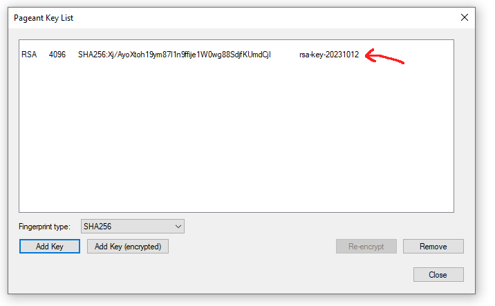

Finally open Pageant from the task bar by double clicking its icon (it should have started running when Putty was installed).
And add your newly saved PPK.
If everything has gone correctly you should see your new PPK in Pageant:
And you can now talk to GitHub using Putty via SSH!
