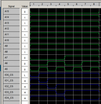

gfoot wrote:
Edit: Here's a simulator-input file for your case, which works fine with the all four PLD code fragments you posted:
Thanks for this - I just couldn't understand how to do the simulation at all. I opened your file, clicked "Simulate" and got the output in the attached image - 1 warning, no errors and a "Simulation successful" message. Do I have to do anything more?
If not, the output looks right to me - exactly how I expected it to look. Can you point me to somewhere to learn about how to write simulation input files like this, please? - that is so useful!
However, overall, no joy. I've moved the chip to a different area on the breadboard AND rewired to address the potential A5 issue - it is producing an output as if that pin wasn't working. I have even used a different ATF22V10CQZ.
Could it be then, that I'm just a shoddy coder and my verification program for the Arduino Mega2560 is the problem? Embarrassingly for me, the answer turns out to be a resounding "Yes". "C" is not my main language and the loop that sets the inputs was wrong...

Re: ATF22V10CQZ Address Decoder Not Working As Expected
Posted: Thu Aug 17, 2023 6:44 pm
by gfoot
That's enough to run it. I'm not sure what the warning was. I don't do it through the awful, unstable GUI though - I use the command line instead. I don't know the command to run the simulator on its own, but there's an option to the "compile" command which causes it to automatically run the simulator after compiling.
This is the main reference I use for everything in WinCUPL - it has a section on the simulator and various syntaxes in the cupl file: https://ece-classes.usc.edu/ee459/libra ... erence.pdf
Oops! It happens. :) It is often worth verifying that your test harness is actually working, and when a test fails, being open-minded and considering everything in the path from known conditions to the test outcome - including the test harness itself. Things like this can also be tested without any extra hardware, just by hardwiring pins to certain values, and that can be a good reality check when a test fails and you can't see why.
Now I believe there's also meant to be an option in minipro to run these simulator tests on the parts, but I don't use the official software so am not sure if it really exists. It definitely has options for testing 74-series logic ICs though so possibly might have this option too.
