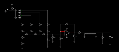

Hi,
I've been working on a VGA DAC for my upcoming CPLD graphics project. I wanted it to be more accurate than the usual quick-and-dirty resistor ladder arrangement, mostly as a fun challenge, as I have never worked with analog circuitry before.
In my research for a suitable opamp buffer, I came across the LT1260 triple amplifier which seems purpose made for driving RGB signals and is available in DIP, though a bit expensive at 7€ (https://nl.mouser.com/datasheet/2/609/1 ... 123073.pdf). So, I designed the following circuit around this IC. It uses pre-made 4-bit R2R ladders, with a multiturn potentiometer on each channel allowing me to calibrate the outputs to 0.7Vp-p as required by the VGA signal.
Even though I was only able to find 4-bit R2R ladders, the intent is to use this circuit with a RRRGGGBB palette, I'm only including the additional bits because they're free.
The color signals have proper 75ohm output impedance, and I added 75ohms (because it simplifies the BOM) source termination on HSYNC and VSYNC, though I'm not sure if that's useful. The gain and feedback resistors are 1.1k as recommended by the datasheet.
The negative power supply is generated by a MAX1044 (https://www.analog.com/media/en/technic ... AX1044.pdf) which is a charge pump, so probably not accurate enough for this? I'm struggling with how to generate this negative power nicely.
As mentioned, I'm not really an analog guy, and would love to hear any feedback you may have.
I also created a simulation on circuitjs

I would put the trimmer at R1 or R2 instead of where you show it.  This will adjust the gain of the op amp circuit, and keep the R-2R ladder nicely balanced.
The charge pump will be fine for the negative power-supply voltage.  Ideally the op amp's output voltage will depend only on the signal inputs and the feedback network, as long as the power supply voltage is great enough to reach the desired peak output voltages.  The only problem might be that at the higher frequencies like your charge pump would work at, the PSRR (power supply rejection ratio) might be poor; but particularly if the op amp is taking very little current relative to what the charge pump is capable of, the ripple shouldn't be a problem.  If you notice any artifacts in your video, they'll probably be cleared up by increasing the capacitor values in the charge pump.

I'm not sure you need that negative voltage. As far as I know the VGA RGB signals are 0V to 0.7V. It's possible that the LT1260 can be run off +5V positive and 0V negative but I only think that from a quick scan of the datasheet - don't trust me until you've tested it.
You might not need the LT1260 at all. If you haven't seen them then James Sharman's videos are a pretty good reference: DAC Test - VGA from Scratch - Part 10.

Thanks! I came across this useful app note from Analog Devices showing the best ways to implement gain adjustment: https://www.analog.com/en/technical-art ... cuits.html. Based on that and your advice, I've now moved the trimmers.
For the charge pump, I was worried because it shows a significant drop in output voltage, 1V between 0mA and 20mA which is what the three opamps would typically use. However, I since realized I had already purchased a MAX739 a long time ago for a DRAM project, so I updated the power supply to be based on that. It is a regulator and should be more stable in the range I'm using it, although it needs a few more passives.

Thanks! I watch James' videos religiously, and his approach is sound. What's missing from his presentation is the effect of current on the R2R ladder. If a bit of current flows through the cable, or you have signal integrity problems due to the impedance mismatch and not driving it at 75 ohms, then I would argue that it could generate errors comparable to the 1% tolerance of resistors, especially noticeable in 8 bits of resolution. I have not measured this though, so maybe I'm overstating it. Still, using an opamp buffer is an approach that should fix that and a learning opportunity for me!
On the power supply issue, they do recommend +/- 5V, but also say it could run with a single supply. I'm not sure how to interpret the datasheet to see how much error there would be at 0V in a single supply circuit? And I'm also not familiar at all with DC biasing and filtering to make the opamp work in a better range, maybe that's for a future learning project.

For the charge pump, I was worried because it shows a significant drop in output voltage, 1V between 0mA and 20mA which is what the three op amps would typically use. However, I since realized I had already purchased a MAX739 a long time ago for a DRAM project, so I updated the power supply to be based on that. It is a regulator and should be more stable in the range I'm using it, although it needs a few more passives.
An op amp does not require the plus and minus voltages to match, nor to be regulated.  Because of the PSRR mentioned earlier, the ripple noise coming from the charge pump could be a bit of a problem that shows up in the video display; but a regulated charge pump will still have the ripple unless the regulator is a good linear one following the charge pump, IOW, that the regulation is not done by turning the pump switching on and off.
Another closely related thing however is that the digital noise coming from the power supply, and ground bounce, on whatever feeds the R-2R ladder is no less important.  I imagine you'll have to keep your nose really clean on that part.  Myself, I don't have any experience in video to know the extent of the potential problem; so I can only talk about this stuff from a theoretical standpoint.
The LT1260 does not have a RtR (rail-to-rail) output.  According to page 6 of the data sheet, the output will not come within 0.5V of the negative rail.  The simplified schematic on the next page shows why.  So yes, you would need the negative power-supply voltage to get the output down to 0V.
If a bit of current flows through the cable, or you have signal integrity problems due to the impedance mismatch and not driving it at 75 ohms, then I would argue that it could generate errors comparable to the 1% tolerance of resistors, especially noticeable in 8 bits of resolution. I have not measured this though, so maybe I'm overstating it. Still, using an op amp buffer is an approach that should fix that and a learning opportunity for me!
For eliminating reflections, the cable really only needs to be terminated with its characteristic impedance at the receiving end.  In the case where the signal is only supposed to go one direction, having the receiver at the end of a 75Ω cable to be 75Ω is enough.  If it's not 75Ω though, or if there are discontinuities in the cable that would cause reflections back to the transmitting end, then yes, you might want the transmitting end to look like 75Ω as well so the reflections don't echo back yet again (and again...and again...and...).  Other than that, the impedance of the transmitting end will only affect the level fed into the cable, like a voltage divider.  If I did the math right (if I didn't make a mistake in the chain of Thévenin-Norton conversions), and if your digital inputs will truly be at 0V and 5V, the max output from the R-2R ladder, with no load, is a little under 3.6V, which is way above your 0-.7V target, and then your op amp will further amplify it (and may clip).  Some changes may be needed.  Again, since I don't have experience in video, I should probably stop here.

As pointed out above, the video output from a VGA port is 0.0 to 0.7v, as measured into 75 ohms built into the display. So open circuit, you should expect to see 1.4v at peak white (er, peak rgb).
Note that this means the black level is sat on the supply zero which might have implications if your local ground is insufficiently stiff - though with a bi-rail op-amp this shouldn't be a problem. Op-amps which work to 'ground' rarely actually make it without distortion as they approach the rail.
