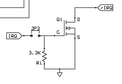

As the interrupt on the 16C550 is active high, all you need is a simple mosfet and a resistor. Attach a 3.3K resistor from the interrupt out line to ground. You can use a BS170 mosfet for the invert switch. Just as long as you have a pull-up resistor on the 65C02 IRQ line, you can directly drive the IRQ from the mosfet. I also use a jumper on the mosfet gate input, just in case you don't want that device using interrupts or have debug issues. Attached is a schematic clip from my CF-Card adapter, as IDE devices also have their interrupt line active high:
Ah, thanks for this! Studying it (along with searching up some additional materials) finally let me understand how MOSFETs work and their uses, I think. Let's see if I've got this right.
This looks to me as if it's serving as a pull-down for when the jumper is open, to ensure that the gate is at the same level (GND) as the source, right? So really, we want to make sure that the resistor is not just on the interrupt output, where it would be out of the circuit if the jumper is open, but on the MOSFET gate, right? And we wouldn't need the pull-down if we didn't have that jumper, because the 16C550 is always providing GND or VCC on its INT output, correct?
So what's happening here is that with the jumper open, or the jumper closed and the 16C550 INT output low, the voltage on the gate is the same as on the source, GND, and this being less than a 0.8V difference between the two means that the MOSFET does not conduct between the source and the drain (or the drain and anything else). Thus whatever the drain is connected to will be at whatever level it is, which is Vcc because you've got a pull-up (not shown in you schematic) on the 6502's /IRQ line.
When the 16C550 raises its INT output to Vcc that overpowers the pull-up and brings the line to Vcc. This creates a voltage difference between gate and source that's more than the 0.8 V that would make the MOSFET start conducting between source and drain. In fact, it's more than the 3 V that causes the MOSFET to go to minimum resistance between source and drain (no more than 5 Ω at most). That shorts the /IRQ line to ground, which overpowers its pull-up and thus asserts /IRQ on the 6502.
Is this all correct?
And a 2N7000 should work just as well, since the only difference between that and a BS170 is that the former has only 200 mA current-carrying capacity between source and drain, as opposed to the 500 mA the BS170 can handle, right? (The pull-up on /IRQ is presumably something reasonable, such as no less than 1K, and so there should be no more than about 5 mA going through the MOSFET when it pulls that line low.)

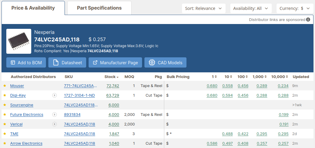

AndrewP wrote:
But once you've found the exact part number using Mouser's website then do a general Google search for the exact part number (say: 74LVC245AD,118) and see if it is cheaper on Digikey or somewhere local etc... Good luck, Mousering definitely takes practice!
Welcome to my world. I do this for work every day. I actually prefer Digikey's site (they were the first to do this kind of web site - Mouser has only caught up with them about 3 years ago), so I usually go there first because I am used to its quirks.
Once you've determined the part number you want, you might want to try octopart.com - it maintains an up-to-date database of who has how many of what for electrical components (assuming you're ordering from large distributors). One word of warning for hard to find parts is to stick to the distributors that you know. There are several that are listed that "pretend" to have stock, but all they do is take your order and then turn around and order from the one that really has it - it will often be cheaper if you order directly from the one who actually has them. For small hobbyist quantities, though, who has the lowest minimum order and lowest shipping to your location is probably more important than the piece prices.
Here's an example of 74LVC245AD,118 with the list sorted by available stock:
Octopart.com example search for 74LVC245AD,118
For hobby purchases, you'll only be interested in places with a Minimum Order Quantity (MOQ) of 1. Arrow appears to have the best price for small quantities here, but you'll want to check minimum order requirements and shipping costs. When ording multiple parts, you also get to play the fun "Can I buy them all from the same place to save on shipping?" game.
