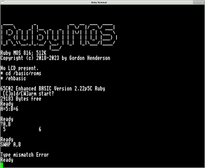

I think I found and fixed a bug, but before declaring it done, I'd just like for all you beautiful people to just look it over and see if I've missed any subtleties.
; perform SWAP
LAB_SWAP
      JSR   LAB_GVAR          ; get var1 address
      STA   Lvarpl            ; save var1 address low byte
      STY   Lvarph            ; save var1 address high byte
      LDA   Dtypef            ; get data type flag, $FF=string, $00=numeric
      PHA                     ; save data type flag
      JSR   LAB_1C01          ; scan for "," , else do syntax error then warm start
      JSR   LAB_GVAR          ; get var2 address (pointer in Cvaral/h)
      PLA                     ; pull var1 data type flag
      EOR   Dtypef            ; compare with var2 data type
; BUGFIX:  SWAP would only swap a string with a number otherwise it would generate an error!
      ; BPL   SwapErr           ; exit if not both the same type
      BNE   SwapErr           ; exit if not both the same type
; End of bugfix.
; perform SWAP
LAB_SWAP
; End of bugfix.
Hm... Not a great fan of diving into ehBasic, but I've had a quick look..
The test is for a string type vs. numeric type. String type is $FF, numeric is $00.
So number EOR number: $00 eor $00 -> 0 (positive)
String EOR string: $FF eor $FF -> 0 (positive)
Number EOR String: $00 EOR $FF -> $FF (negative)
I actually think the branch ought to be (or was intended to be) BMI rather than BPL, but BNE here works too. (So a logic swap waaaaaaay back)
It also makes me think that no-one has ever used the SWAP command...
Swapping a number & string is ... interesting:
I patched my version (the Floobydust 2.22p5C version) with BMI and it works as it ought to.

So far I'm pleased that this little bugfix seems to be agreed with.
Now, as to why someone wouldn't spot this bug, I think its down to SWAP being a very uncommonly used command that isn't implemented on that many versions of BASIC and so wouldn't affect all that many people.
