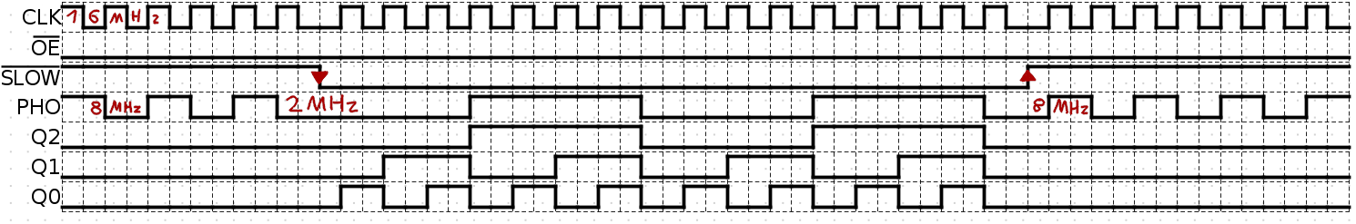

Here's my idea:
- GAL20V8 operating in registered mode, master clock (16 MHz, comes directly from oscillator) drives GAL's CLK line, GAL is permanently enabled.
- GAL controls PHO ("Phase Out") output as register, which goes to 6502's PHI2.
- If /SLOW is asserted, GAL serves as 3-bit counter and flips PHO on overflow: f(PHO) = f(CLK) / 16 = 1 MHz
- Otherwise, GAL flips PHO every cycle: f(PHO) = f(CLK) / 2 = 8 MHz

; If /SLOW is asserted, this works as 3-bit counter: [PHO (MSB), Q1, Q0]
; Q0 (LSB)
Q0.R = SLOW * /Q0
; Q1
Q1.R = SLOW * /Q1 * Q0 + SLOW * Q1 * /Q0
; Q2 (used for debugging only)
Q2.R = SLOW * /Q2 * Q1 * Q0 + SLOW * Q2 * /Q1 + SLOW * Q2 * /Q0
; Output clock
PHO.R =
    ; Fast mode, f(PHO) = f(CLK) / 2
    /SLOW * /PHO
    ; Slow mode (3-bit ocunter, PHO as Q2), f(PHO) = f(CLK) / 16
  +  SLOW * /PHO *  Q1 * Q0
  +  SLOW *  PHO * /Q1
  +  SLOW *  PHO * /Q0
DESCRIPTION
PHO = CLK / 16 if /SLOW is asserted or CLK / 2 otherwise
Simulated timing diagram:
