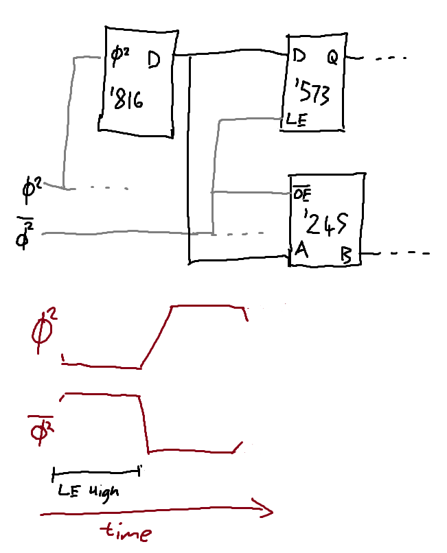

Posted: Wed Apr 05, 2023 2:40 pm
by AndrewP
The best way I can think of describing how to latch the bank address from the D pins is: just keep the '573 LE high the entire time PHI2 is low.
Initially as PHI2 falls the '573 will start latching "garbage" (whatever was already on the data bus) but it will latch the bank address correctly when it appears. The address is also "garbage" (whatever it was previously) as PHI2 falls but soon correctly appears.
Then stop the '573 latching by bring LE low as PHI2 rises. This means it takes half a clock cycle to latch the bank address. VDA and VPA are completely separate concerns and have nothing to do with correctly latching the bank address; they indicate what is in the address the '816 is fetching (opcode, program, data or nothing). VDA and VPA and the bank address will change once per clock cycle during an instruction. Although sometimes VDA, VPA and BA will change to the same value they already had.
To get a nice clean PHI2 and /PHI2 run your clock at twice the frequency through a D-Type flip flop and use Q and /Q as PHI2 and /PHI2. That will give you a perfect instantaneous inverse for PHI2. If you don't want to double your clock frequency then you could run your clock into a buffer to get PHI2 and into an inverter to get /PHI2. That will still give you a better inverse than just using an inverter on it's own but depending on your timing characteristics it might not be important.

Re: Latching the bank address the right way
Posted: Wed Apr 05, 2023 11:48 pm
by BigDumbDinosaur
That is what I am doing in POC V1.3. /LE is gated by Ø1 and when the latter goes low, the latch closes before the 816 has “turned around” the data bus...and we’re off to the races. :D Works fine at 16 MHz, using only discrete logic—no PLDs at all.
One could qualify the gating of /LE with VDA || VPA, but I’ve concluded from observations with the logic analyzer that it is unnecessary. The bank bits will have stabilized in plenty of time before Ø1 goes low, and are a “don’t care” during “dead cycles,” since the main glue logic should be qualifying chip selects with VDA (and optionally, VPA).
