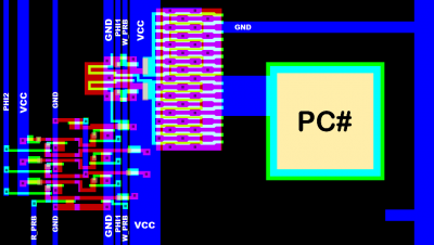

5c) PC# output is "open collector" with pullup to VCC.

5c) PC# is a push/pull output.

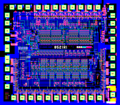

A picture of the 8521R1 silicon, with the interesting areas marked.
Just as a reference, another picture of the MOS 8521R1 silicon without the markings.

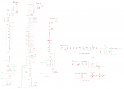

8521R1 cheat sheet:

1a) PHI clock generator
Nothing special here.
The external high_active PHI2_in clock signal goes into an inverting super buffer,
which gives out the low_active PHI2_in# clock signal.
PHI2_in# controls a RS flipflop.
The RS flipflop is built from two NOR gates,
the output of every NOR gate is boosted with a non_inverting super buffer,
the super buffers emit the chip internal non_overlapping high_active clock signals PHI1 and PHI2.
Also, PHI2_in# goes into the "2) CS#, R/W#" circuity for generating
the low_active read/write control signals RD# and WE#.

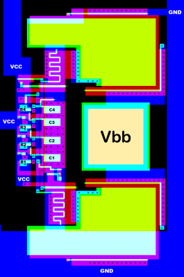

1b) bias generator
//8521 bias generator is completely different from 8520 bias generator.
Basically we have a ring oscillator, buit from five inverters.
In the signal path of the oscillator, R1\C1..R4\C4 set the frequency.
At the output of the oscillator, we have an inverting and a non_inverting driver.
The output of every driver goes through a big capacitor and into a
bridge rectifier which is built from four FETs working as diodes.
The output of the bidge rectifier then gives us the negative bias voltage.

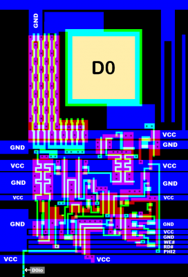

3c) D0
Layout of the D0..D7 buffers/drivers is pretty identical, so we just focus on D0.
The D0 pad connects to the external data bus.
D0io is the internal databus inside the chip.
To make it simple:
"read" means that the internal D0io..D7io signals are placed on the D0..D7 pads.
"write" means that the signals from the D0..D7 pads are placed on the internal D0io..D7io bus.
At the "write" side, the signal from the D0 pad goes through an inverting super buffer,
is sampled at PHI2 by a transparent latch, and then goes through two more inverters,
and from the inverters into two NOR gates controlling a driver which places the signal on the D0io bus.
The low_active WE# write enable signal which is generated in "2) CS#, R/W# circuitry"
is delayed before it goes into the two NOR gates controlling the driver.
If the low_active write enable signal WE# is LOW, the driver is enabled.
At the "read" side, the signal from the internal D0io bus goes through a non_inverting super buffer,
then through an inverting super buffer and an inverter, controlling two NAND gates
which set/reset a RS flipflop built from two NOR gates which have push/pull outputs.
The outputs of the RS flipflop are controlling the driver FETs which are switching the D0 pad to GND or VCC.
Means that said driver FETs do non_overlapping switching.
Now for the trick:
The low_active RD# read enable signal which is generated in "2) CS#, R/W# circuitry"
goes through an inverter, then into both NAND gates.
So when RD# is HIGH, the outputs of both NANDs are HIGH, forcing both outputs of the RS flipflop to LOW,
what disables the driver FETs which are switching the D0 pad to GND or VCC.
Conceptually, the game is similar to what we had in the 8726 dissection.

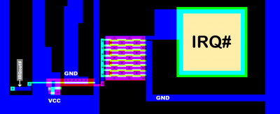

3d) IRQ#
The low_active IRQout# signal is generated in "10) ICR".
It goes into an inverting super buffer, which drives a FET that switches the IRQ# pad to GND.
Means that when IRQout# is active, the IRQ# pad is switched LOW.
The other end of the IRQ# pad is supposed to be connected to a pullup resistor (to VCC),
and to the IRQ# interrupt input pin of a 65xx CPU.

5c) PC# pad
PC# is a push/pull handshake output, which generates a LOW pulse in the PHI2 cycle
after a PORT B data register read or write cycle.
//in the 8520, PC# is an "open collector" output with no pullup FET.
//in the 8520, there is a two PHI2 cycles delay between PORT B data register read/write and pulse output.
R_PRA (PRA read enable signal) and W_PRA (PRB write enable signal) go into a NOR gate,
which feeds the inputs of a shift register which is built from transparent latches (controlled by PHI1 and PHI2)
and inverters.
A NOR gate attached to said shift register controlls the driver which switches the PC# pad to GND.
Basically, PC# logic works like an edge detector for 'R_PRA OR W_PRA'.
My guess is that the designers wanted to limit the length of the PC# pulse,
like when it comes to read/modify/write cycles on PRA or PRB,
or when the PRA\PRB read/write is stretched for multiple PHI2 cycles while the CPU is hold by RDY.
