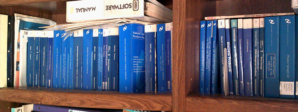

I have about 50 shelf-feet of electronics data books, catalogs, manuals, etc.. The ones I refer to most often are the National Semiconductor (NSC) data books from about the late 1980's to 1995. In spite of their age, the logic ones do cover up to 74F, 74FR (almost twice as fast as 74F, 2.5 times the speed of 74ALS), 74ALS, 74AS, 74ABT, 74ACT, 74ACTQ, 74FCT, 74LVT, 74LCX, 74LVX, 74LVQ, 74LVT, 74LVXC, 74LVX3V3, 74VHC, 74VHCT, and of course the older 74xx, 74L, 74LS, 74HC, 74HCT, 74C, and 4000. I refer to the NSC analog ones a lot too. These blue books are all NSC:
Before I pony up my hard-earned beer money I'm curious to know which ones stand out as particularly well done.
I'd say my most useful logic data book is the thick CMOS Logic one. Mine is from 1988. It covers 74HC, 74HCT, 74C, and 4000 (but note that 4000-series parts are too slow for most of what you probably want to do; I use it for slow 12V stuff). It has a lot of great ap. notes in it too. When you want faster parts, you could use the online data sheets just to look up the speeds and drive capabilities, but keep this book handy for the pinouts, descriptions, truth tables, logic diagrams, logic waveforms, etc..
I got these before we had the internet and manufacturers gave out their data books like AOL CD-ROMs (remember those?) to engineers in the industry, hoping that they'd design the parts into their products and make for a lot of sales. So I didn't pay for any of these. (TI was not nearly as generous or helpful as NSC though; so guess whose parts I used!) I don't know where you would get these books today. It might be a used-book store, library sale (including from technical schools), someone retiring and getting rid of much of their stuff, etc.. You'll probably just have to keep an eye out for them. I haven't looked on eBay or Amazon.
I totally agree that the paper is friendlier. Dave Jones of the EEVblog went kind of hard on this, saying, "Why would you keep all those old books taking up space when it's all online now." The books are great for making your own notes in, posting your yellow stickies, etc., and are faster to flip to desired parts, and don't require you to keep changing windows on the screen. Further, NSC spun off their logic stuff to Fairchild, and later, TI acquired NSC and said, "Oh, we have this part too, with data sheets, so we can dump NSC's data sheets" (and Fairchild was acquired by ON Semi); but NSC's were more clear and had better application information than TI. I'm very glad I kept the old ones!! TI acquired and ruined several other companies too; and its technical customer service is lousy compared to what NSC's was. On the modern stuff, I always have to print the data sheets I'm going to be getting into heavily. On a complex microcontroller or Bluetooth module, that might be two or three hundred pages or even more; and then I put them in a loose-leaf binder, which doesn't handle as well as a normal soft-cover book.
