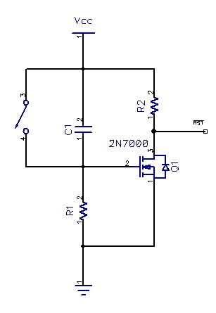

DS1813's are getting pricey. They are 1/3 of the cost of a W65C02 these days. The DS1233-15 is a more reasonably priced device. However, a small cap, a couple of resistors and a little MOSFET like a 2N7000 can provide a nice reset circuit for well under $1.

I've seen some awfully noisy, bouncy switches, including pushbutton. (They get worse as they age; so just because it works nicely when new doesn't mean it always will.) If you happen to get one of these and don't realize what's going on, it could be awfully discouraging. There's often (usually?) a spare gate section somewhere on the board, and especially if it has a Schmitt-trigger input, you can use it for a reset circuit with a few discretes that altogether cost a few pennies. I show such circuits on the reset page of the 6502 primer, at http://wilsonminesco.com/6502primer/RSTreqs.html .
BTW, the DS1813 does have an internal pull-up resistor which the data sheet says is typically 5.5K, and may be quite a bit lower. I don't think there's any point in adding an external one.
