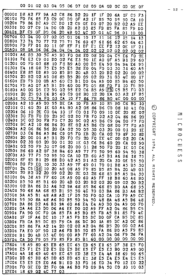

http://retro.hansotten.nl/6502-sbc/kim- ... re/#mchess
where I document Microchess for the KIM-1, original manual and articles..
Has source (in TASM format!) that delivers an exact binary as from my dumped original audio tape.
