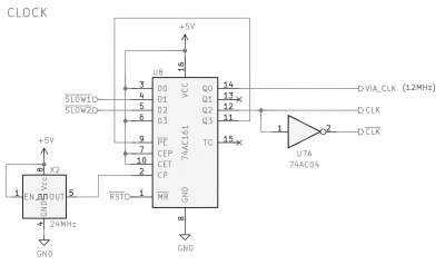

I've come across this design for clock stretching that I've slightly adapted from the Plank project to have a variable clock divider, depending on the state of SLOW1 and SLOW2. CS decoding and the SLOW outputs would be generated with an ATF22V10 EEPLD (or ATF16V8), according to the limitations of the addressed I/O.

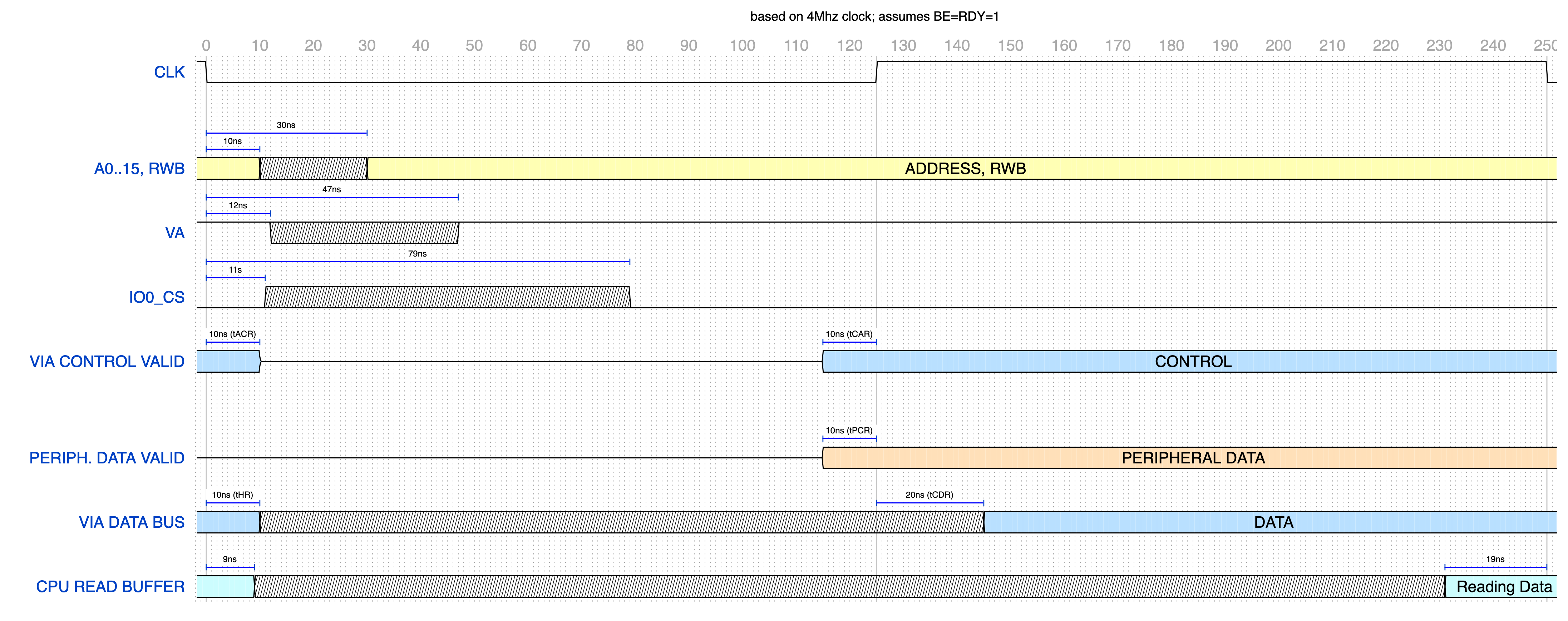

As an example, this is a timing diagram I recently built for the VIA in a read cycle. It shows when the VIA expects its control signals to be valid, and the time it takes for those signals to propagate based on my design. Then it shows when the VIA reacts to these signals, and when the CPU needs the signals reaching it to be valid as well.
You can then mentally compress this clock cycle and find the limiting path. In this example, I could shorten the cycle quite a bit: the control signals section shows that the minimum half-period of my clock is 79+10ns, so 1000/89/2 = 5.61MHz would be the maximum for this section. The data bus section shows that the minimum half-period would be 20+19ns, so 1000/39/2 = 12.82Mhz for this section. All in all, in this diagram the control signals are the limiting factor, specifically my address decoding which is relatively slow.

Are you saying that clock stretching in this fashion is not the best implementation to access slower devices? Is there a better way? Or wait states would be the way to go?
