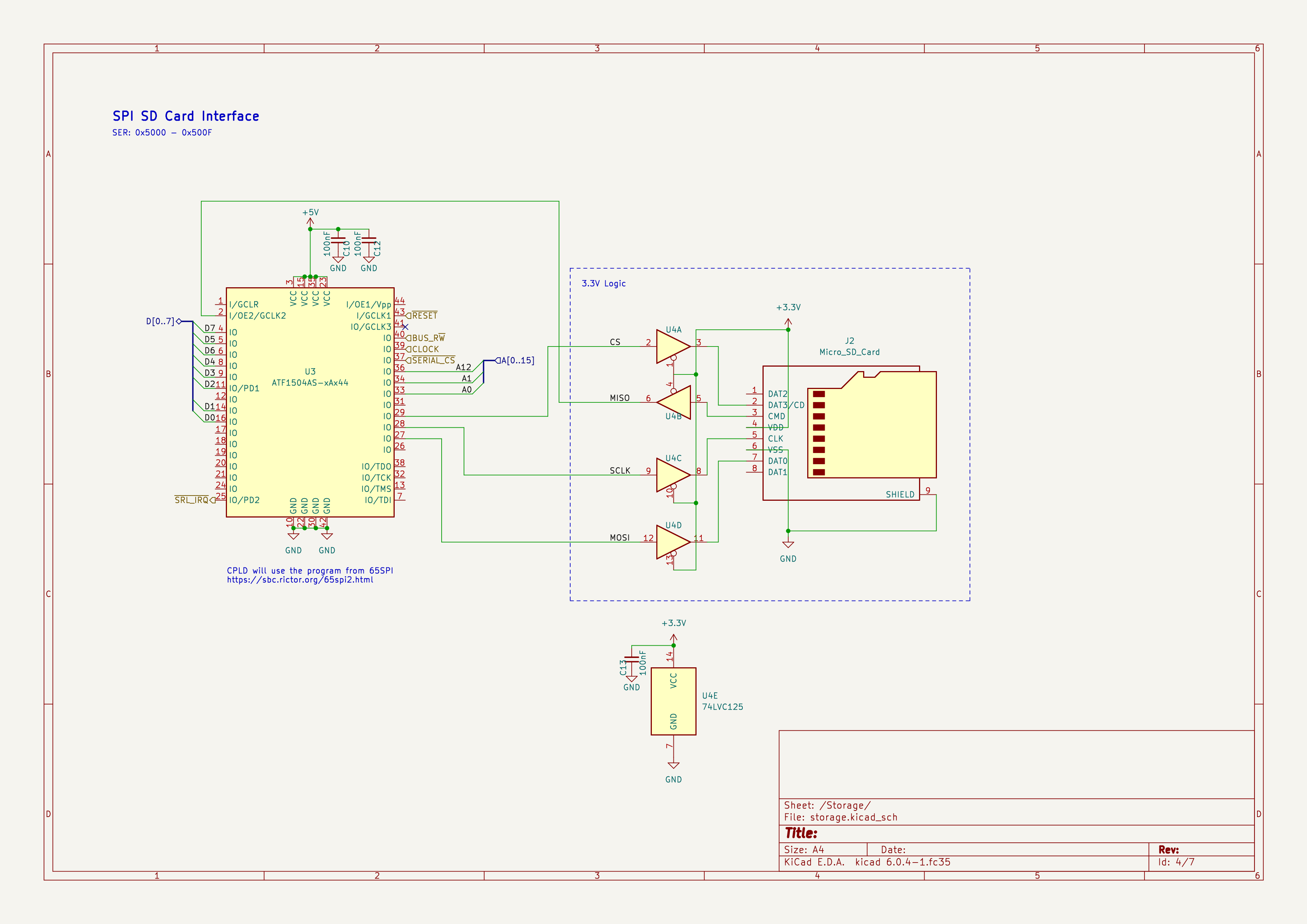

Update
Using the 65SPI CPLD design (https://sbc.rictor.org/65spi2.html), I've come up with this.
Buffer takes care of the 5V to 3.3V conversion.
Re: Reviews for my 6502 SBC design
Posted: Sun Apr 24, 2022 6:29 pm
by GARTHWILSON
I don't know which buffers you plan to use, but the circle at the control input suggests you'll have to connect that pin to ground rather than the high voltage in order to enable the buffer.
Posted: Sun Apr 24, 2022 8:16 pm
by zrthxn
Ah yes silly mistake :P!
By the way, the CPLD used in this 65SPI project, the Atmel ATF1504 is turning out to be a bit hard to find. Do you think the same program could be replicated on a Lattice CPLD? (thinking of M4A3-64/32)
