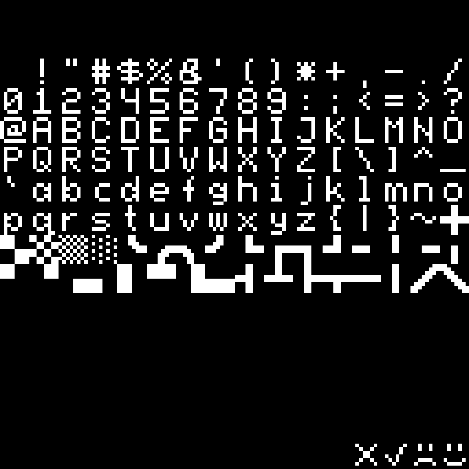

PS: If anyone knows of a good looking 8x8 font that I can use, I would be very grateful for a pointer to it. Though I am happy that I was able to find a free one to use, it doesn't look great in either 40- or 80-column mode!

This is the 8x8 font I use:
https://unicorn.drogon.net/systemFont.h.txt
I'm sure it would be easy to mash that into anything you like - the important bit is that the vertical bars are double width where possible which makes it very visible on TVs (not that that's an issue for you, here though - read this for some details: https://retrocomputingforum.com/t/8-bit ... esign/1097)
I'm just getting into the world of FPGAs myself, so this is all very interesting and relevant to me - thanks!

Thanks, Gordon! Your font looks tons better. Cheers!

for an ASCII compatible character set i have just been using this:
either way i hope to see more experimenting you do with this board, maybe you could try a sound chip, since i've never seen a CPLD based custom sound chip for 65xx systems before

Thanks for the font! I will give it a go. I'm still a bit unsure about what to do for sound, TBH—I've been putting that off till the end while I was trying to figure out the rest, and video seemed like a harder nut to crack (and it was… I've been trying to build a video interface using discrete logic for months!). My current thinking is to use some kind of MCU; there are some from Microchip that come with dual DACs and enough memory to make a synthesizer possible. With a CPLD, I would be worried about having enough room to store wavetables, though the MAX II does come with 1kiB of flash RAM, so it might work in the end.

A final update on this project: I have added support for reading the video RAM and for blanking interval detection/interrupt. This makes the interface with the host computer bidirectional and allows for smooth animation.
I still plan to create an advanced version with a customizable palette and support for sprites, but I'm going to call this version of the project complete for now—if for no other reason that I have used all but one of the available macrocells in the CPLD :-)
The interface works really well, incidentally. I was able to test it with my SBC running all the way to 20MHz and it's nice, responsive, and completely glitch-free (though, in all fairness, my code isn't yet fully optimized).
Just for fun, here are a couple shots of the card plugged into the SBC, and some 80-column text output from the SBC to my VGA monitor, using Gordon's most excellent font (thanks again, Gordon!).
