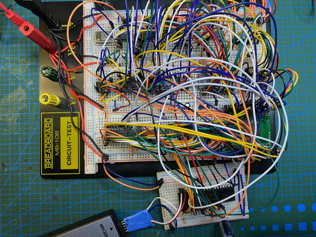

Here's what this circuit looks like on a breadboard. Behold the nest of rats! (Bonus PIC18 hanging at the bottom because I ran out of space.)
I'm sure this can be simplified a great deal, and I would love everyone's feedback on improving it, but it seems to work quite well overall; the picture is very stable, and there is only a minimal amount of jailbars that I'm not too worried about. I haven't really sorted out the SBC interface yet, but here's a video of the PIC driving it (apologies for the poor quality… it really does look pretty good in real life):

First, I would love feedback on the design (including feedback on the schematic itself… it's the first time that I share one with anyone, and I would like to get proficient at making them well-organized and readable).
Second, there are two nagging bugs that I'm struggling to figure out, and could really use some advice on which strategies to pursue.

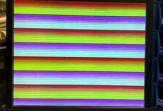

Bug One is that the first three rows of the display are shifted to the left by a few pixels (this is really evident in the videos). It's as though the monitor has to catch up for a few lines before it's properly synced, but I think that I'm sending the sync signals and resetting the counters at the right times; besides, if the sync were off, I would expect it to be consistently off and the entire picture skewed.
Bug Two is that memory updates cause some random, spurious extra pixels to be written. You can see this in particular if you look at the Moiré pattern demo (the last one in the set), where some very obviously extraneous white pixels show up in the middle of the screen. I am quite puzzled by this, as the PIC's timing is quite slow compared to the 25ns SRAM chip, and when the PIC is writing to the memory it has full control of the bus. What's really confusing is that the number of spurious pixels shrinks (though never entirely) if I make the /WE pulse longer… which makes very little sense. I think it's clear I'm dealing with some kind of synchronization problem, but I'm not quite sure where to look for it.
I've had something very like this in the past, and I would suspect that it is indeed due to not resetting the counters properly at the end of the frame. The monitor is kind of OK with it but takes a few scanlines to resynchronise. If you use counters with synchronous reset, you need to send this reset signal from the ROM one pixel earlier, on the last "pixel" of the 800x525 frame. In my own latest designs though I use counters with an asynchronous reset, so I have to put the reset signal one "pixel" later in the RAM - at least as far as I remember. It was certainly an issue that had very similar symptoms to what you see here.
Another option is to change the order of things in the ROM so the reset happens during the vertical blanking period rather than at the end of it. Ideally you'd fix the sync issue anyway, but if not, at least this way it would not be visible.
I'll have a closer look at this later on, I've certainly run into this sort of issue a lot in the past! To prevent spurious writes it's important that you drive the address bus a certain amount of time before enabling WE (and ensure the counters stop driving that bus early enough and quickly enough), and potentially that after disabling WE you still hold the address and data buses in the right state. Bus capacitance won't work to hold the address steady if you immediately let the counters drive the address bus after WE goes high.
I was actually thinking about this last night after I wrote my post… I did verify that the reset bit is being flipped on the last pixel, but it's occurred to me that the sync ROM operates at 1/8th the clock speed, which means that, as far as the monitor is concerned, the count restarts seven pixels too early, so I wonder whether that might be the problem. I will try to reset at the beginning of the lines instead and see if being one pixel too late a similar effect in the other direction.
I have had a bit of trouble sourcing 74AC163s, btw… very hard to find unless you want to buy 1,200 of them :-)
