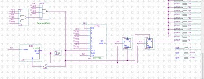

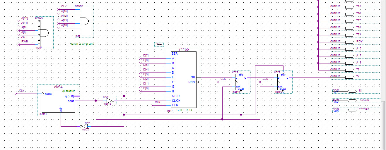

The serial transmitter is located at $E400. It is basically a TTL 74165 parallel-in serial-out shift register with few more logic to implement serial protocol's START bit circuitry. A divided-by-64 counter reduces the 7.37MHz system clock to 115200 baud. When "STA $E400" instruction writes to the serial port, the divided-by-64 counter is reset, 74165 is loaded with a byte of data, and the START bit register is reset to 0. Transmitter starts after the negation of the write.
The attached schematic show the entire circuitry including ROM, 7-segment display, and transmitter. A screen capture of the transmitter output is attached. This is a simple example of ROM program in CPLD. A larger CPLD ROM program can load data into RAM via serial port and program a EPROM without having a programmed EPROM in the first place. I'll describe such EPROM programmer later. The take away is CPLD + CPU can do many things

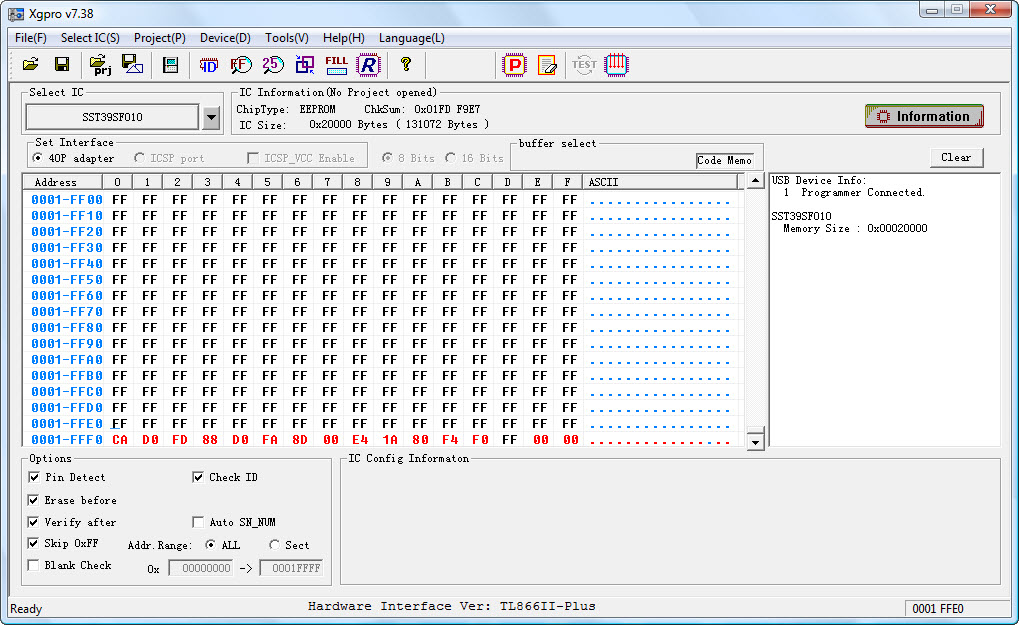

Enough of booting out of CPLD, today I will add RAM and EPROM to the board. Below is a simple decode logic for RAM, EPROM, and expansion I/O such that
* EPROM is $F000-$FFFF
* Expansion I/O is $E800-$EFFF <-- Expansion I/O is for devices on RC6502 connector
* Internal (CPLD) I/O is $E000-$E7FF
- Simple Transmitter is still located at $E400
* RAM is $0-$DFFF
I will test the external EPROM with the same CPLD program of the previous post. So I copied the same 16-byte binary from the previous post and manually fill it in the TL866II and programmed a SST39SF010.
In CPLD design the internal ROM is removed, the RAM/EPROM/Expansion decodes are added, and the Simple Transmitter is retained. The CPLD design is attached below.
Turn on the power, and we got the same display. So moving ROM code from internal CPLD ROM to external EPROM produced the same result, as expected. We'll test the RAM next time.
