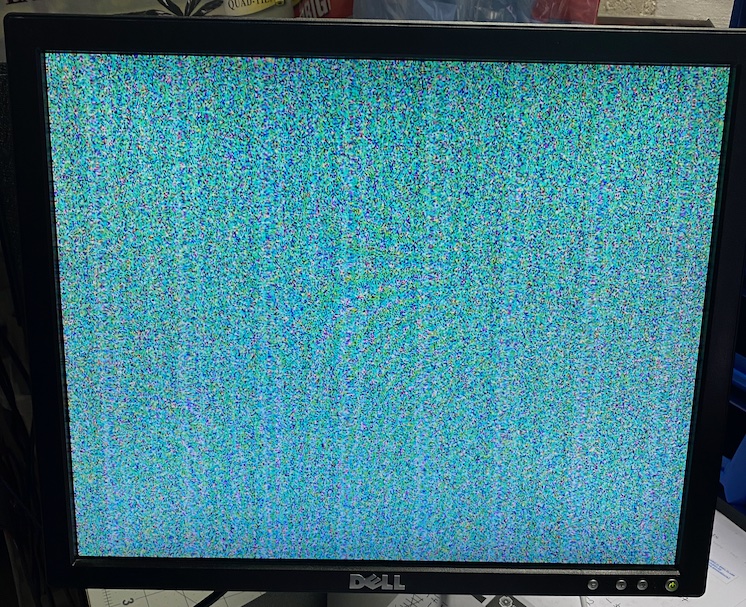

Hey Jeff—I am trying to build a VGA interface for my SBC. So far, I have built the “video” side of the interface, which has its own memory chip and seems to work (at least in the sense that I see a stable image on my monitor—it shows garbage, and I'm hoping it's the garbage that's in the RAM :-) ).

Thanks! As I told my friend a couple days ago, I've never been happier to see garbage on a screen :-)

Very good news! And I love that pic of "garbage", beautiful indeed :) I went back and looked at why you'd want a pull-down resistor, and I also now see why that's important. I need to learn too! Thanks.
