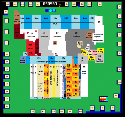

A picture of the 6509 silicon, with the interesting areas marked.
The dark green areas in the picture went covered by the previous 6509 dissections.
Just as a reference, another picture of the 6509 silicon without the markings.
Bus systems inside the 6509 CPU core:
(omitting instruction register and peripherals)

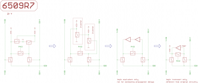

In my opinion, it all was intentionally build that way to minimize chip space.
It is normal to have the FETs of a single logic gate "spread over half of the chip",
and it is normal that it turns out to be an AND/NOR combination gate.
It is normal to have transparent latches and NOR based RS flipflops which don't appear as such at first sight.
It also is normal to encounter logic design tricks like that one:

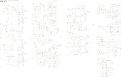

First a small picture, to tell what in the cheat sheet goes where.
Note, that the location of the functional blocks in the picture does not directly correspond
with the physical location of the functional blocks in the silicon.
Now for the big cheat sheet: be warned it really is big.
It has some intrinsic beauty, but be warned that staring at it for too long is unhealthy: please take a break from time to time.

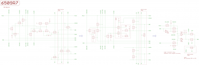

2) Y register
Y register is located East from the A0..7 latches\drivers in the silicon.
Y register cells are half_static (and very compact).
The Bits are refreshed during PHI2,
and read/written during PHI1# =0 (what is different from PHI2 =1).
Note, that PHI1 and PHI2 are non_overlapping clock signals.
//unlike the 6502, the 6509 has no internal clock generator.
And that a FET pulling an internal bus line to GND also has to sink
the current through the pullup resistor (FET) inside the register cell to GND.
So trying to figure out what exactly happens during "illegal" NMOS 6502 instructions
when more than one register might connect to to a bus line may give you some more grey hairs,
because you would have to take the resistance of all the pullup resistors (FETs)
plus all the FETs switching to GND at a bus line into account.
In my opinion that's not a clean design, but it sure saved some chip space.
Also, when stretching PHI1 for too long, the data in the register is getting lost.

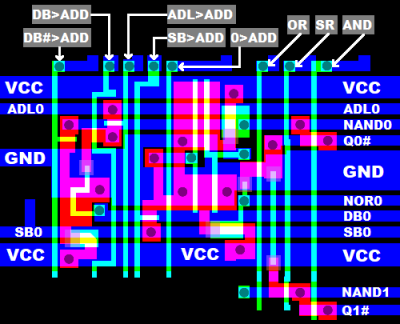

5) ALU_in
ALU_in is located East from the Stackpointer in the silicon.
For understanding how the ALU works, it was necessary to break it into three parts.
For convenience, I had named the part where the bus signals enter the ALU just ALU_in.
What isn't exactly correct, because it also handles things like AND, OR, shift right.
Three bus signals enter ALU_in:
ADL, the internal A0..7 address bus,
DB, the data bus from/to the "15) data latches" (which connect to the external data bus),
SB, the special bus.
One ALU input is either ADL, DB, or inverted DB.
The other ALU input is either SB, or 0.
ALU_in generates NAND (open collector with pullup) plus NOR (open collector with pullup)
for both ALU inputs, these signals are used later for the ALU carry chain, the BCD detection\correction,
also for "9) V evaluation" (overflow detection that is).
The ALU result bus Q# is low_active,
FETs controlled by 'AND' are switching the NAND output signals on the Q# bus,
FETs controlled by 'OR' are switching the NOR output signals on the Q# bus.
Shifting/rotating right just switches the NAND output signals in a different order to the Q# bus,
except for Q7# which is pulled to VCC.

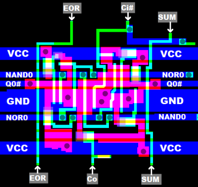

ALU carry chain is located East from ALU_in in the silicon.
The ALU carry chain features the usual inverted/non_inverted carry scheme for binary adders.
For more details, start reading here.
FET switches controlled by 'EOR' place an XNOR (open collector with pullup) of both ALU inputs on the Q# bus.
FET switches controlled by 'SUM' place the inverted adder sum on the Q# bus.
6) ALU carry chain, Bit 0,2,4,6:
low_active carry input, high active carry output.
The NAND from "5) ALU_in" generates a carry, if both ALU inputs are 1.
The NOR from "5) ALU_in" kills carry propagation, if both ALU inputs are 0.
Note, that "8) BCD detection" reads the high_active Bit 4 input carry from inside the carry chain.
7) ALU carry chain, Bit 1,3,5,7:
high_active carry input, low_active carry output.
The NOR from "5) ALU_in" propagates a carry, if one or both ALU inputs are 1.
DC3 is an additional carry input of carry chain Bit 3, generated by "8) BCD detection".
