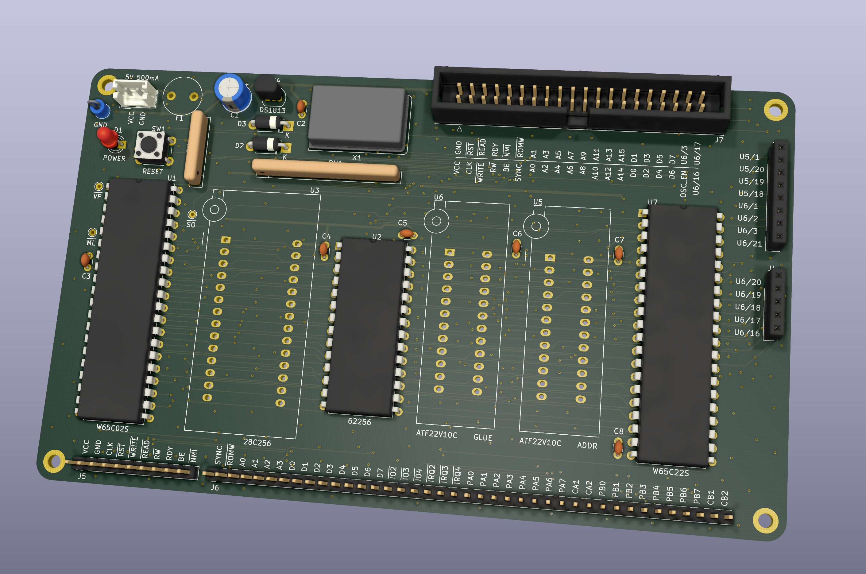

Hey all,
While I'm still working on my 65C816 videos, those take time and the design doesn't happen as fast as when I'm working on my own. So I wanted to have fun and design a new motherboard for my 6502.
This is the current board I designed. You can find more info on it on my Github:
It works pretty well, but it is a bit cramped. I also wanted to move to SPLDs for the glue logic, and add the VIA directly to the PCB. So, enter this new board:
Here is the schematic
I made a few updates to the design:
- It is still using pin headers to plug into the breadboard, but this time only headers, not sockets, and with rearranged pins (don't need the full address bus, added the VIA ports instead)
- I switched to two ATF22V10 with ZIF sockets for the glue logic. It would fit in 16V8s but this is what I had on hand. The 22V10s are also more featureful (you can tri-state individual pins). I exposed the unused pins in the header on the right so I can play with them later
- I also added a new "debug" or "dma" IDC40 connector, which contains all the CPU signals, plus a couple of unused SPLD pins. I plan on using this for a bus monitor, or alternatively something based on Ben Eater's VGA card.
- The power section is slightly improved, with a non-reversible connector and a fuse
- the RDY and RST pins are now wire-ORed with a diode, to protect the components in case I decide to tie them high to VCC with a jumper or something (which already happened once on the old board)
- the built-in oscillator is 4Mhz, and can be three stated by the debug device by pulling down the OSC_EN pin. So I can drive the clock with an Arduino for debugging
Finally here is the routing. I made so much progress with routing things cleanly since the previous board, I'm pretty pleased with the result. Board is 4 layers with 2 inner ground planes

Hopefully, you find this interesting! Any suggestions before I send it to the fab?
Not anything that should affect your PCB layout, but I suggest you reduce resistor network RN1 to 3.3K. Use of 10K will make the attached circuits noise-sensitive.

Interesting! I did notice you were using 3.3k in your projects, but I wasn't sure why. What is it about 3.3k that makes it less noise sensitive?

You don't need the pull-ups on signals that are driven, like the R/W, /Read, /Write and /Rom_WE ..
Looks good though - hope it works well!
The higher the resistance, the easier it is for low-going noise to pull down the affected circuit and possibly trigger an unexpected response. In general, the lower the value of the pull-up resistor, the more noise-immune the circuit will become. Also, in the case of wired-OR circuits such as /IRQ, the lower the resistor, the smaller the circuit's R-C time-constant. A large time-constant will result in a circuit that is slow to return to the quiescent state, and in the case of /IRQ, may result in a spurious interrupt.
Obviously, going too low with the resistor will overburden any device pulling the circuit low. For many applications, 3.3K is a good compromise between reduced noise and current draw when the circuit is being driven low. In a 5 volt system, 3.3K will produce about 1.5 mA when the circuit is being driven low, which is safe with almost all devices. If your wired-OR circuits are being driven by 74AC or 74AHC logic, 1.0K is good and gives extra noise margin. Examining the sinking current rating of the device(s) connected to the pull-up resistor will help in selecting a suitable value.
I noticed that but didn't think to comment.

R/W is tri-stated by the CPU when BE is taken low. Similarly, I will tri-state /Read and /Write to allow the DMA device to generate its own pulses. In my case, my VGA card (based on Ben Eater's) relies on being able to set /Read after stopping the CPU. Which means there will be some interval when they will not be driven. I don't think it would be safe to leave them without a pull up? Or am I mistaken?
For /Rom_WE, this one is not being driven at the moment, so I want to pull it up but keep the ability to build a ROM programmer later.
That makes sense. I have to check the current ratings for the wired-OR RDY and RST inputs. Right now I'm using 1k because that's what gives me a fast return to 5V (measured around 30ns in my 65C816 videos).
For this board I already ordered the quite atypical 12 pin 10k resistor network so I'll solder it in, but I'll keep this suggestion in mind for the next one :-)
Strange as it may seem, momentary floating isn't quite as deleterious it it would seem. The circuit's parasitic capacitance can cause bus state to persist for tens of microseconds, and sometimes longer (Garth discovered that whilst testing his memory modules). That said, pull-ups cause no harm—they only cost you in board space and power consumption when the circuit is driven low.

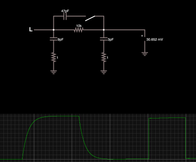

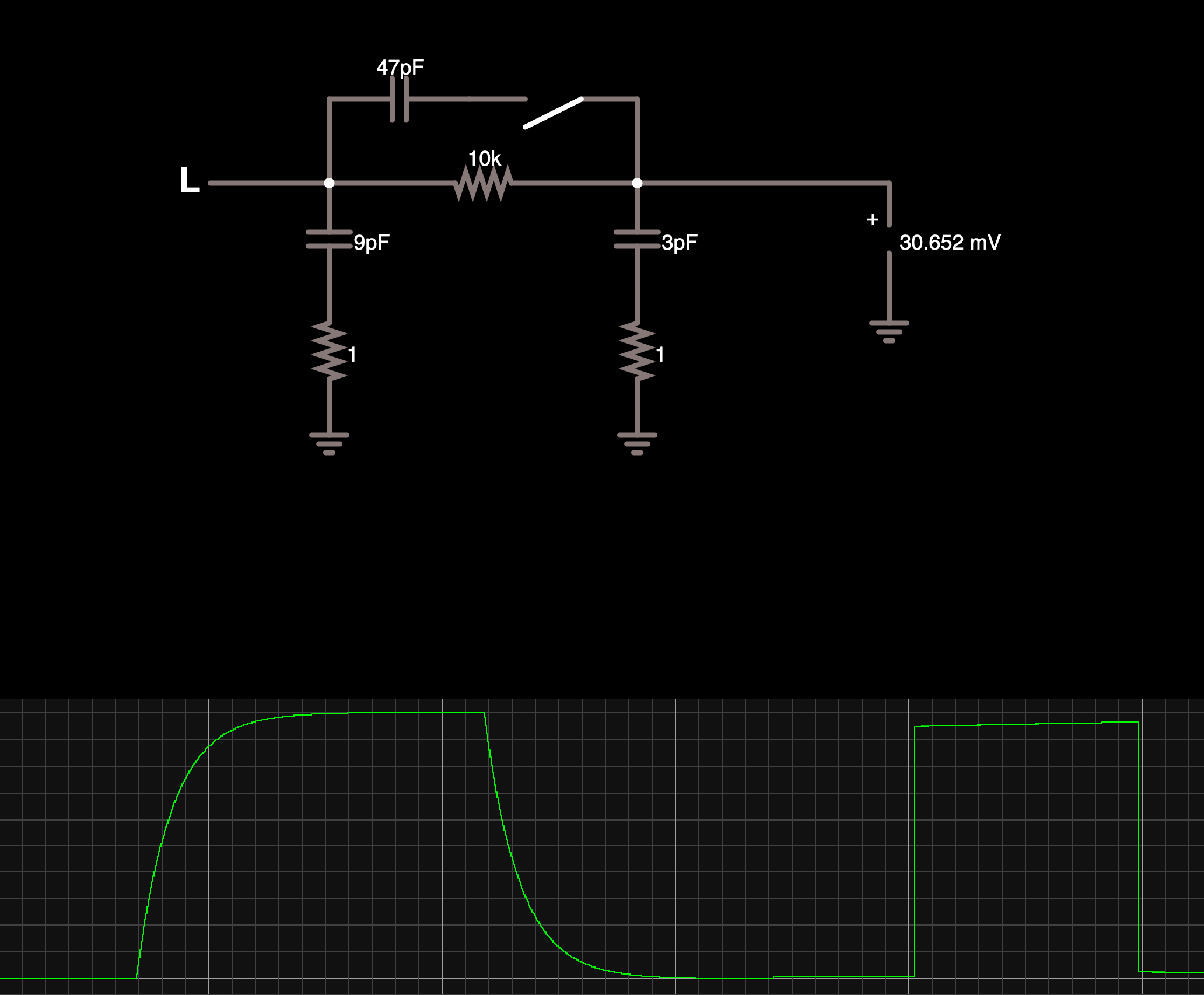

Thanks! I was curious to see this in action so I made a simulation in CircuitJS
I took some values for the output and input capacitance of HC gates from TI's Designing With Logic.
The beginning of the trace is without the shunt capacitor, when the input switches, and the end of the trace is with the capacitor added. So looks like it works! Magic! :D
