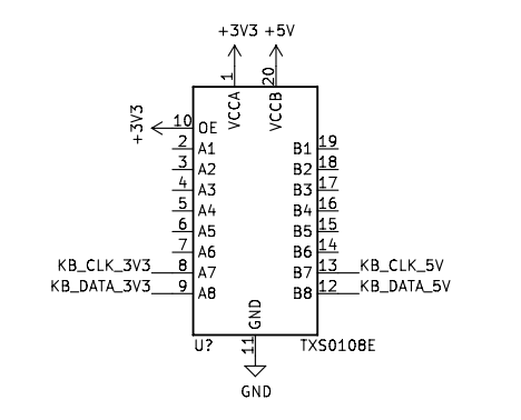

In my board, I have an MCU (an ESP32) that performs some I/O tasks, one of which is interfacing with a PS/2 keyboard. The MCU runs at 3.3V, while the PS/2 interface runs at 5V, and so I've had to add a level shifter in between the two. Originally, I just had a couple MOSFETs (one for the clock line, and the other for data) with a 10k pull-up resistor on both sides.
This worked well, but it took up a bunch of space on my board, so I decided to try my hand at a proper bidirectional level shifter, and landed on the TXS0108E (which seemed to be like a good fit, particularly given that, at some point, I also want the MCU to talk to the 65C02 side of the circuit, which also runs at 5V). My circuit looks a little like this:
(Note that the TXS is on a breakout that also includes decoupling capacitors.) I don't have any pull-up resistors here, because my understanding is that the TXS has them built in—and, indeed, the lines are high on both sides when there is no activity.

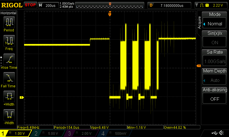

Now to my problem: for some reason that I do not understand, the signal on both lines looks like this:
This is the data line, as the keyboard is trying to send data to the host. You can kinda see the transmission happen, but it's dirty and causes all kinds of spurious readings at the keyboard end. If you zoom in to the solid-yellow areas, they turn out to be some kind of very tight sine wave at ~2x the clock speed of the keyboard.
This only seems to happen if the keyboard is connected to the TXS breakout board. As far as I can tell, is happens regardless of whether the MCU is connected at the other end. (FWIW, the MCU's pins connected to the lines are both set to inputs.)

That's an interesting part!
Try tying the unused A pins to VccA & unused B pins to VccB.
Use your 'scope to measure each of the IC pins. Are Gnd & VccA & VccB present & clean?
Thanks—I think you may actually be on to something. I did check the voltages at the chip itself (with some difficulty… the thing is tiny!) and everything looked okay.
However, now I have one of these breakout boards providing an actual interface between the ESP32 and the rest of the board with the 6502 bus running at 5V, and everything works as advertised (including a PWM signal running at 10MHz). The only two differences from the keyboard setup is that all the I/O lines are used, and that this interface is push-pull instead of open-collector. So, unless there's some specific exception that applies to open-collector circuits, I think that you may be right, and without all pins connected to something, the chip is up to no good.
Unfortunately, I broke my only good PS/2 connector, so I'll have to wait until I get a new one before testing. I'll report back—thanks again for the suggestion!

Well, I couldn't wait for the new parts to arrive, so I jury rigged the PS/2 port with—I kid you not—a couple paperclips, and connected all the unused lines to VCCa/b as leepivonka suggested, and lo and behold:
So, it seems that that was the problem. Thank you so much for your suggestion! Now for a follow-up: Is this the kind of thing that one is just “supposed to know” based on experience, or is it explained somewhere on the datasheet? I find these documents hard to read, probably because they assume the level of knowledge that makes sense for an EE, but not for someone like me who is just starting out.
@Dr Jefyll: I have deleted that, but it was more or less similar to this one. My understanding of the PS/2 protocol (from what I have read, e.g. here) is that the lines are held high unless pulled low by either the host or the device… so, if I'm reading the datasheet correctly, the TXS should be able to do the job (and indeed, it looks like it can… I had just wired it wrong).

Datasheets are usually very handy, and will reward a close and careful reading.
But it is a fairly regular thing that unconnected inputs on chips will cause trouble - it's maybe slightly unexpected in this case, as the inputs are not regular inputs, but it's consistent really, to tie them off.
