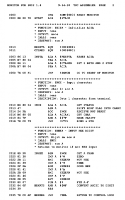

Perhaps a little O.T.: I have no 6800 experience, but all the 6800 code I've seen put the A or B on the end of the mnemonic, with no space, making it four letters, as in BillG's post at viewtopic.php?p=78469#p78469 and all the subsequent posts in that topic ("6502 vs 6800")

I thought I felt my ears burning...
I have been programming the 6800 since 1979. Though early Motorola documents showed the "split" instruction format, every assembler I have used allowed the alternative "merged" form as well.
Code listings in literature were about half and half. I never liked the split format. In those days of slow and small storage devices, that added space was wasteful.
It is insightful that the split format was deprecated in documentation for the 6809 and more notably, the 6801/6803 which sported some extensions of the original instruction set but was otherwise source and binary compatible.
https://www.lucidtechnologies.info/6803_instr.pdf
Lance Leventhal shows both forms in his book, e.g., LDAA and LDA A. When I learned MC6800 assembly language in 1975, the crossassembler I was using (running on an IBM S360 mainframe) only recognized the xxAA or xxAB formats. The documentation for the assembler stated that the fourth character that identified which accumulator was being acted on was part of the mnemonic, not the operand, and that it could not be placed in the operand field. Also, see the below, which uses the LDA A style, but clearly does not place the accumulator symbol anywhere near the operand field.
6800 Assembly Language Excerpt.
