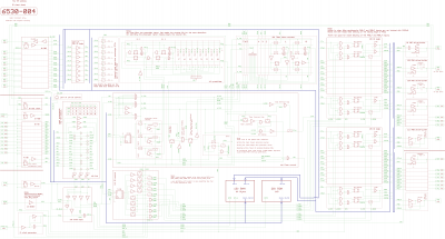

0) cheat sheet
A very simplified schematic to give an overview about what came out during the dissection.
Note:
Latches labeled FSTL are fully static transparent latches (built around a RS flipflop).
Latches not labeled FSTL are dynamic transparent latches (just a FET switch plus some trace capacitance).
A picture of the 6530 silicon, with the interesting areas marked according to the cheat sheet.
Don't worry because the RAM and the ROM lack any details in the cheat sheet and in this picture,
we are getting there later.

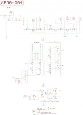

1) clock generation
Nothing special in there.
However, it should be noted that PHI2_in also directly and unbuffered drives quite some circuitry on the chip.
6530 PHI2_in has 30pF typ. input capacitance, for a NMOS 6522 20pF typ. would be normal.
When using multiple 6530 (or 6532) chips in a system,
it probably would be a good idea to keep an eye on the total capacitive load of the 6502 PHI2 output driver
(and on the 6502 propagation delay PHI0_in to PHI2 output, which might be different for rising and falling edge of the clock).

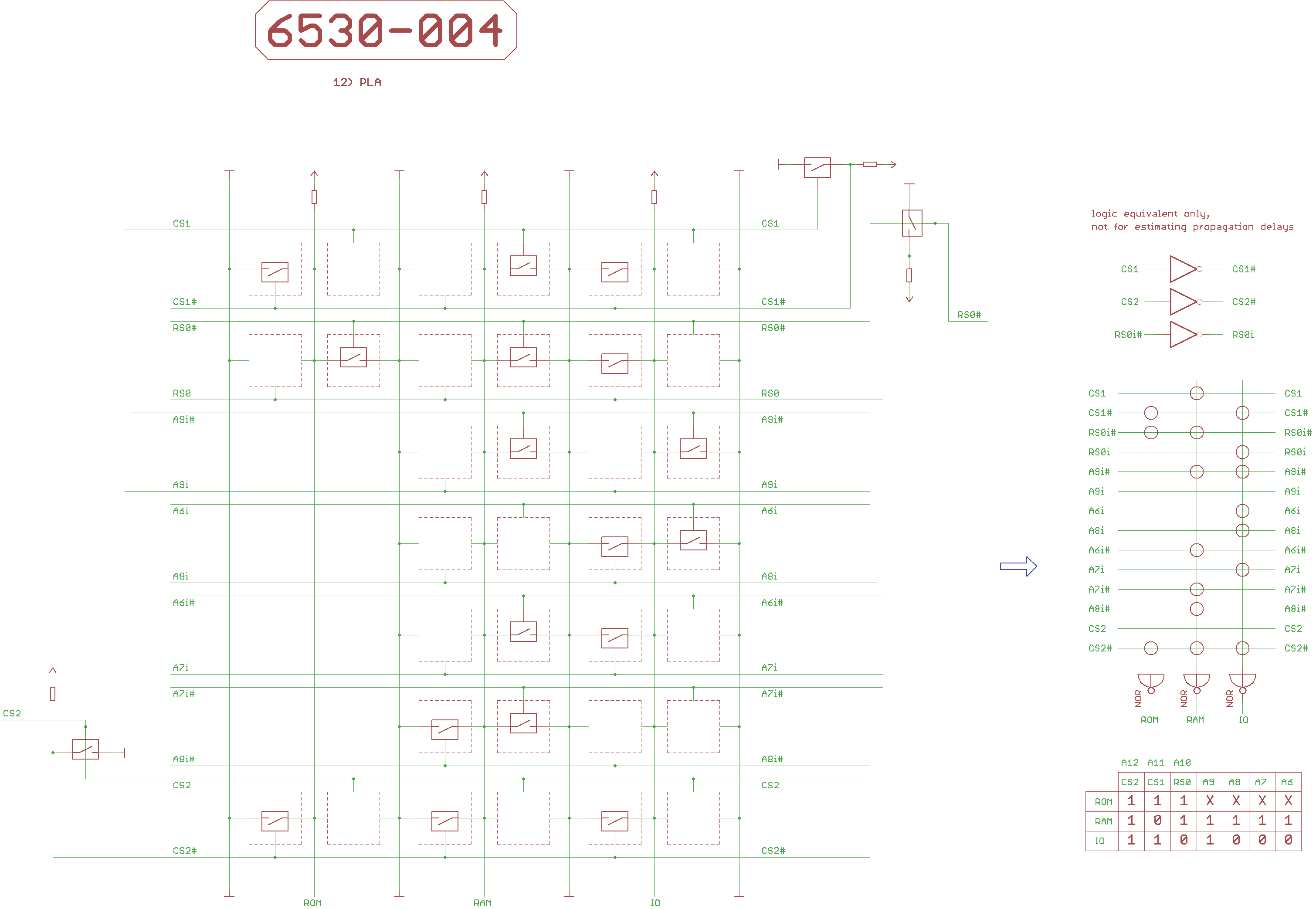

6) CS1 latch
The CS1 latch is a fully static transparent latch, which samples PB6 at PHI1,
and gives out the high_active CS1 signal to the address decoder PLA.
Similar to the CS1 latch,
the CS2 latch also is a fully static transparent latch, which samples PB5 at PHI1,
and gives out the high_active CS2 signal to the address decoder PLA.
Both latches are located between the RES# pad and the RAM block.

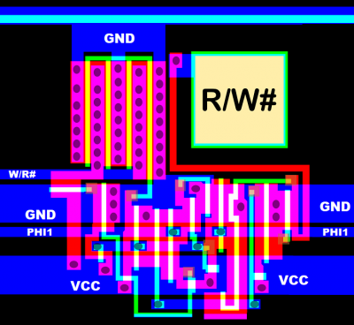

7) R/W#
R/W# (high=read, low=write) is sampled with PHI1 into a fully static transparent latch,
which feeds a push/pull driver generating W/R# (high=write, low=read).

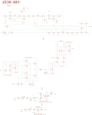

8) DB7
Overview:
DB0..7 external data bus pads (high_active).
Internal write data bus D0..7w# (low_active) when writing registers.
//Internal write data bus D0..7w (high_active) is generated by super buffers located South in the IO logic block.
Internal read data bus D7r# (low_active) when reading registers.
//The read data bus is precharged during PHI1 with FETs located South in the Timer block.
Layout for the DB0..6 circuitry is pretty similar to DB7, so we only take a look at DB7.
On the input side, the high_active DB7 pad is sampled with PHI2_in into a fully static transparent latch,
which feeds a push/pull driver generating the low_active D7w# signal for the write data bus.
//Note, that the PHI2_in signal controlling the DB0..7 latches comes directly and unbuffered from the PHI2_in pad.
On the output side, the low_active OE_DB# control signal enables the inverting DB7 push/pull driver
which takes the low_active D7r# signal from the read data bus and emits it in high_active form
on the external DB7 data bus pad.

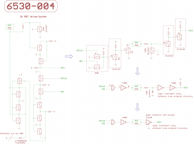

9) PB7
PB7 is an open drain IO port signal, which lacks a pullup resistor.
In addition to being an IO port signal,
it also works as a (low_active) Timer overflow interrupt output,
supposed to be tied to the IRQ# pin of a 6502.
The PB7 pullup resistor (FET) is present in the chip layout,
but the diffusion layer between the pullup and VCC is cut.
I think that's because if the PB7 pads of multiple 6530 chips are tied to IRQ#,
and every 6530 would have a PB7 pullup resistor,
the resulting impedance of all the PB7 pullup resistors in parallel on the IRQ# line
would be too low for a 6530 PB7 output driver to pull down IRQ# to a logic low level.
Not much to say on the output side:
if PB7o# is high OR IRQ is high, the output driver pulls PB7 low.
//For logic high level, you need to add an external pullup resistor between PB7 and VCC.
In the IO logic block, PB7o# is the output of a NOR gate fed by data bit PRB7 and data direction Bit DDRB7#.
If PRB7=0 (data Bit low) and DDRB7=1 (PB7 is output), PB7o# is high, and PB7 is pulled to GND.
The high_active IRQ signal is generated in the Timer control block.
//IRQ can be enabled/disabled with A3 during Timer reads/writes.
If it's enabled AND if the Timer Interrupt flag is set, IRQ is high, and PB7 is pulled to GND...
...by ignoring the PRB7 and DDRB7 Bits.
On the input side, the PB7 pad signal goes through two inverters, becomes PB7i and goes to the IO port logic,
IO port logic places it in inverted form on the D7r# read data bus when reading data register PRB,
Note, that the PA0..7 and PB0..PB7 input signals are not latched at PHI1, the CPU reads them directly,
we are getting there later, too.
Re: 6530 dissection
Posted: Thu Jul 29, 2021 10:36 am
by ttlworks
10) PB6
PB6 pad also feeds CS1 latch, PB6 pad also feeds CS2 latch,
CS1 and CS2 are used in the (mask programmed) address decoder PLA of the chip we had dissected,
and as a mask programmed option the metal trace between PB5,PB6 pad and PB5,PB6 driver is cut.
//You don't want the chip to be able to remove itself from the system by disabling its own chip select.
PA1..7 and PB1..6 pad circuitry is pretty similar to PB7.
They are open drain outputs with pullup resistor (FET).
So we just focus on PB6:
On the output side, if PB6o# is high, and if the metal trace wouldn't be cut, the output driver would pull PB6 low.
In the IO logic block, PB6o# is the output of a NOR gate fed by data bit PRB6 and data direction Bit DDRB6#.
If PRB6=0 (data Bit low) and DDRB6=1 (PB7 is output), PB6o# is high.
On the input side, the PB6 pad signal goes through two inverters, becomes PB6i and goes to the IO port logic,
IO port logic places it in inverted form on the D6r# read data bus when reading data register PRB,
Note, that the PA0..7 and PB0..7 input signals are not latched at PHI1, the CPU reads them directly,

11) PB0
PA0 and PB0 have a pullup resistor (FET),
but unlike PA1..7 and PB1..7, PA0 and PB0 have true push/pull output drivers.
PA0 and PB0 are meant to source 3mA for driving darlington transistors and such.
PA0 and PB0 circuitry layout is different to make better use of chip space,
but electrically they are identical, I checked.
So we now focus on PB0.
On the output side:
PB0 output driver is enabled by DDRB0=1 (when PB0 is configurated as an output).
PRB0# which goes into the output driver is the low_active output signal of the PRB0 data register Bit.
When DDRB0=1:
If DDRB=1 and PRB0=0 (PRB0#=1), the output driver pulls PB0 low.
If DDRB=1 and PRB0=1 (PRB0#=0), the output driver pulls PB0 high.
And that's all there is to it.
The input side is more complicated:
There is a danger that the voltage at PB0 doesn't reach logic high level
when the PB0 driver has to source a lot of current.
That's why we have sort of a 2:1 multiplexer controlled by DDRB0 (data direction register Port B).
The multiplexer generates PB0i, which goes to the IO port logic,
IO port logic places it in inverted form on the D0r# read data bus when reading data register PRB,
If PB0 is configurated as an input, PB0i is generated from the PB0 pad.
If PB0 is configurated as an output, PB0i is generated from the data register Bit PRB0.
//I'm simplifying things a bit here.

12) PLA
(mask) programmed logic array (PLA), also known as "the address decoder".
Mask programmed as in "customer specific".
It decides, where ROM, RAM and IO (including Timer) show up in the 6502 address space.
Located high up North, between A5 pad and R/W# pad.
Basically, we have three NOR gates:
One for selecting ROM: fed by CS1, CS2, RS0i. //CS1#, CS2#, RS0i# respectively.
One for selecting RAM: fed by CS1, CS2, RS0i, A6..9i. //CS1#, CS2#, RS0i#, A6..9i# respectively.
One for selecting IO: fed by CS1, CS2, RS0i, A6..9i. //CS1#, CS2#, RS0i#, A6..9i# respectively.
Where CS2 is supposed to be A12, CS1 is supposed to be A11, and RS0 is supposed to be A10.
//The A0..9 input buffers emit A0..9i (high_active) and A0..9i# (low_active).
We have three inverters, generating CS1# from CS1, CS2# from CS2, and RS0i from RS0i#.
For those who are new to the game:
In the polygonized chip picture, red is diffusion layer, green is PolySi layer, blue is metal layer.
Where ever green crosses red, that's the active region of a FET, and green is the Gate of that FET.
So the PLA was mask programmed by changes in the diffusion layer.
