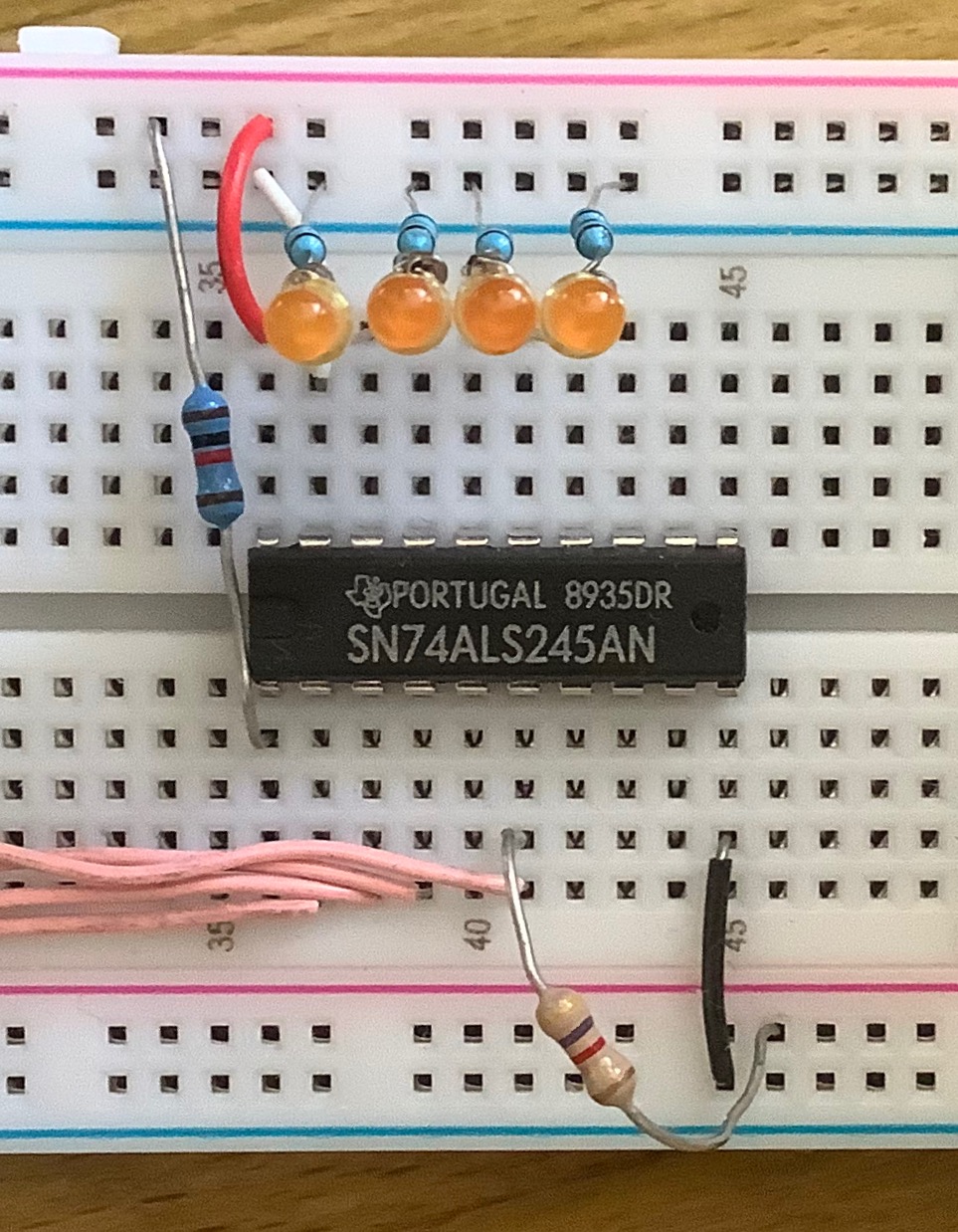

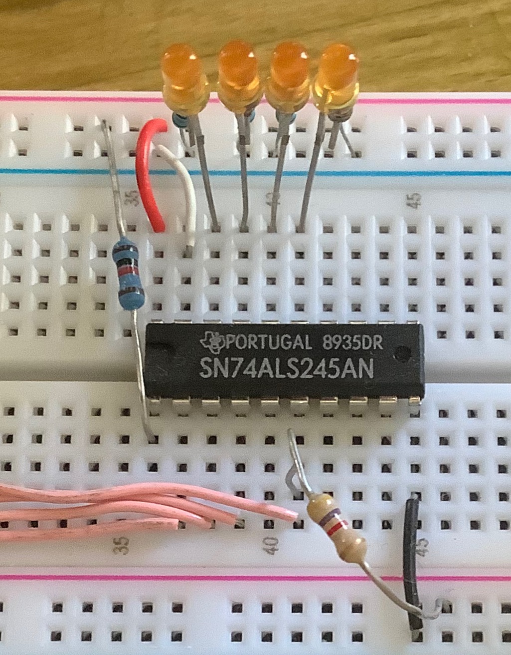

Since Sep 2020, it has been apparent to me that I have unconventional ideas about numerous technical topics. This includes my approach to hardware construction. I would like to share a minor innovation which is very probably unoriginal but has been hugely beneficial to my own efforts. Specifically, I have made about 20 5V tolerant, reversible LED indicator modules.

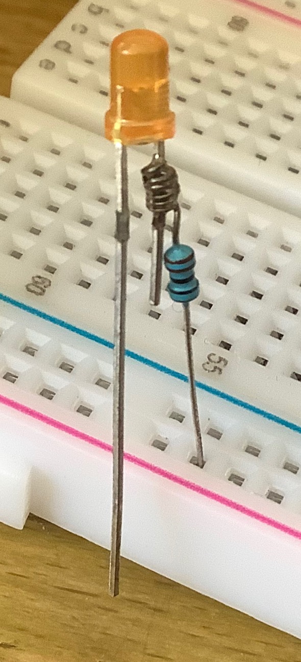

As a lazy programmer, my laziness extends to not bothering to calculate the value of a current limiting resistor for use in conjunction with an LED. Instead, I use two LEDs in series. This works best with 2.7V red LEDs. You are strongly dissuaded from using 3.3V gallium green/blue/purple/pink LEDs because the result may be dim or ineffective. (Hmmm, I wonder why 3.3V circuitry often uses blue power lights?)
In a further example of laziness, I cannot be bothered with the polarity of LEDs. I am therefore glad to confirm that it is possible to arrange two pairs of LEDs back-to-back and make a reversible indicator. This is a simplified application of Charieplexing. In this case, any two of the four LEDs glow when there is sufficient current.
In a final non-act of laziness, I have found that it is possible to get a 4*4 scrap of 0.1 inch prototyping board and insert a ring of 5mm LEDs which can then be soldered so poorly that I laughed at my own work. (Hey, I've not soldered for more than one year.) Although it is possible to arrange the same circuit on a 5*3 scrap board, the symmetry of 4*4 has better center of gravity. It also facilitates the choice of the best opposite corners to attach the fly leads. With the most symmetric board, there the most options to avoid your own soldering disasters.
As my health allowed, I spent about six hours over three separate sessions making 25 indicators. I was shocked that the first 10 worked flawlessly. This is especially true given that I laughed at the quality of my own soldering. Of the next 10, one failed to work in either orientation before one of its fly leads fell off. That was easily rectified. Of the next five, two were unsalvgeable and were discarded. (A one pin LED is particularly useless.) It is quite obvious that quality decreased as I became tired. One indicator has subsequently dimmed and this has also been discarded.
Anyhow, the result has been very worthwhile. I have 22 indicators which work like LEDs except that they work either way around, work at 5V and have longer, insulated leads which are less likely to break. When I'm working on a breadboard, I can just grab them from a pool and place them anywhere without thinking. The effort to make these indicators has already saved time elsewhere. Furthermore, this has only required about USD2 of parts and has been far more useful than a multi-meter.
The first task using the indicator lights is to make a chain of 74HC161 binary counters. From this, it was immediately apparent that I would be using indicators almost exclusively in pairs. Therefore, my profligate use of LEDs extends to clusters of eight. The first pair of indicators was used as power lights at each end of a breadboard. This eliminates the ambiguity of the whole board being powered, especially for variants which have split power rails or no power rails. All other pairs have been used from ground to signal and from signal to power. Due to persistence of vision, logarithmic response and the varied angle of indicator lights, it is surprisingly difficult to distinguish a high frequency signal with 1/2 duty ratio from a high frequency signal with 1/16 duty ratio. However, when indicator lights are paired, it is quite trivial to determine if duty ratio is approximately half or significant deviation from half.
I highly recommend making dozens of these indicators - even if it takes you more than one day to complete the task. If you have terrible soldering due to inexperience or a long absence, it is the ideal project to get started. It is not a particularly useful project in itself. However, like a carpenter's A-Frame, it will save you time as a project progresses. I estimate that you may break even after three or four days of experimenting.
