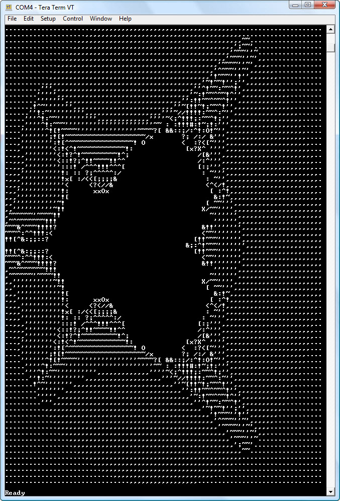

(Small note: you have there the buggy version of the Mandelbrot code. See here.
Re: Salvage computing, new retro computers from used eBay pa
Posted: Mon Dec 28, 2020 3:42 pm
by plasmo
Ah Good, you caught me just in time; I was going to rewire Proto65 to add a compact flash drive. With the correction the mandelbrot looks much better, see picture below.
Lee Davison also had written EhBASIC for 68K and I have ported it to my 680x0 hombrews. The original mandelbrot program running on EhBASIC-68K looks just like the picture below, so the variable names on EhBASIC-68K must be longer than 2 characters. Good, this solves the mystery of why mandelbrot ran differently on EhBASIC 6502 vs 68K.
