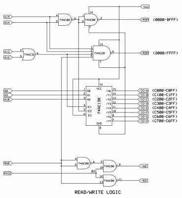

I concur with Ed's suggestion that you go with a coarser memory map and use discrete logic instead of GALs. As this is your first 65C02 build you don't want to get very complicated. A simple memory map that can be configured with a handful of gates will make hardware debugging quite a bit easier. For example:
$0000-$BFFF  RAM
$C000-$CFFF  I/O
$D000-$FFFF  ROM
The above can be established with a circuit such as the following:
65C02 Memory Mapper
65C02 Memory Mapper
The above will give you plenty of contiguous RAM (48KB), as well as plenty of contiguous ROM (12KB). Furthermore, there are no more than two gate delays between any chip select and the address bus, which will allow the circuit to run as fast as your ROM will allow. Obviously, you can use anything you want—it's merely a suggestion to get you started.
Speaking of ROM speed, adding wait-state circuitry to the above is easy—Jeff's circuit that you linked to should work fine. You'd trigger a wait-state when the ROM's chip select is asserted. However, I recommend you not do wait-stating in your first build. The idea is to build something that won't overwhelm your ability to troubleshoot should it not work properly on the first try.
Along with building the hardware, you will need to write some basic firmware to make it go. A book we recommend around here for anyone learning the 6502 assembly language is Programming the 65816 Including the 6502, 65C02, and 65802 by David Eyes and Ron Lichty. This tome starts out with the basics and gradually works you into writing and testing small programs. Key concepts are explained and there is a detail write-up on every instruction. I highly recommend you get a copy and keep it handy.
one thing i noticed about the FT240X is that the datasheet says that it reacts to the falling edge of the WE signal...
The /WE behavior is common. Which brings up an important point.
In a 6502 system the Ø2 clock is what regulates bus activities. You should not write to RAM or I/O while Ø2 is low, as the data bus is not guaranteed to be stable during that time. Therefore /WE must be qualified by Ø2. My example circuit includes a read/write generator for use with the RAM and ROM you are wishing to use.

I don't usually disagree with BDD and Ed, but I'm a dyed-in-the-wool fan of GALs and wholeheartedly support your use of them.
They are:
- FAST
- re-programmable, allowing you to fix problems with, or update, your logic easily.
- reduce chip count (I think you can do all you need with just one)
- allow for flexibility in PCB layout
- cheap
- simple to use
- easy to find - even old Lattice ones are abundantly available
I see no downside to them and I'm not sure what Ed and BDD have against them. To me, they are a lot more pleasant to use than wiring up 3 or 4 (or more) 74XXXX chips and their cumulative PD - especially if you got something a bit wrong.
Right, and this rule doesn't seem to be followed in the circuit in the lead post.
Also, I have doubts about the snippet shown below.
  • Isn't CS_ROM an active-low signal? Also,
  • be aware that RDY means what it says; ie, the high (True) state means "go ahead." (High doesn't mean "do a wait state.")

This is already a lot? the desigtn is already a lot simplier than what i originalled planned with the FPGA.
And I agree with BillO, GALs are just better than discrete logic ICs in basically every way.
i used discrete Logic ICs when i first did a Z80 breadboard build, but quickly switched to GALs and never looked back.
I could be more lazy with the IO Decoding so it could fit into the same GAL as the Memory decoding. but i don't know... it would leave copies of the same devices in the Memory map unless i fully decode the addresses.
It's the same exact circuit you showed. this is just the power up state, if you look a bit more closely, as soon as PH2 is set to 1 the output will also be set to 1 and stay there until the CS_ROM or IO_EN get set low.
so it would only pull the RDY pin low for half a clock cycle.
and yea i did some readjustments for the Decoding:
i somewhat kept the Map of the orginal post, but i can easily change the decoding by just reporgramming the GALs even after the computer is built.
RAM: 0x0000 - 0xDEFF (55.75kB)
IO: 0xDF00 - 0xDFFF (256 Devices, only 2 used at the time, the FT240X and the Status of it)
ROM: 0xE000 - 0xFFFF (8kB, should be enough for this one, though as said i can always adjust these numbers even after the PCB is made)
and yea i can just leave out the RDY Circuit and use a slower CPU.
This should be better, even though it's almost the same thing.
DerTrueForce wrote:
That's a thing worth noting: Some of the members here are colour-blind, and these people are some of the more experienced members, so it's best to post schematics and such in monochrome.
oh sorry i didn't know that, i just use Logisim because it's convenient and allows me to directly test the circuit as well.
i tried to edit the image to have a higher contrast, but it also made the text a bit less readable.
I asked the Dev of "Logisim Evo HC" to add color controls for the program, which should make it useable for basically all colorblind people. though it will take some time for him to actually add it.
