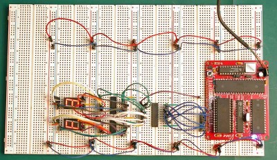

I also have a couple of new projects that might be of interest. One you can have the PCB for the price of shipping. It's a real simple and tiny design with an expansion bus that can be used in a solderless breadboard and other configurations. It has performed well up to 19+ MHz, uses only 5 chips and fits in the palm of you hand. Here are some shots of it in various projects that are underway.
The other is a motherboard type design, but uses a 4-layer board so I'd be a bit hard pressed to give it away. It runs at 16 MHz and through a memory register can address 128K ROM.
PM me if you are interested in either.

by barrym95838
That Jaguar sure is a beauty, Bill! (... and I think you meant MHz, not mHz ... :wink:
