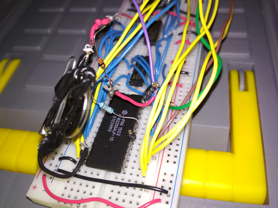

Posted: Wed Apr 03, 2019 1:55 am
by Solater
So I've been implementing the design:
As you can see, I used a couple of paperclips and some electrical tape as the battery terminal, and I connected an 18k resistor to the CE/ pin as a pull-up resistor.
I can't get it to work, all information is lost when I disable the external power. While disconnected, if I measure the Vcc pin with a DMM, I do get a constant 2.7 volts. If I measure the CE/ pin, however, I get only about 1.3 volts.
I've reasoned that what might be wrong may be any of these things:
I've shorted out the battery with my paperclip connectors a couple of times now, so it might be nearly dead.
I got some pretty crazy resistance values when measuring from the paperclip to Vcc (50k ohms), which may be limiting the current.
Maybe the pull-up resistor value is too high.
At this point, I think my best option is to cut my losses and change the way I connect the battery to the IC. I could buy a terminal, but I have been unable to find one for these coin batteries around here. I was thinking of using a large clip with something that insulates better than electrical tape and also a couple of metal plates. But I don't know what type of metal plate I could use, any ideas? Also, can I simply solder some wires directly to the batteries, or will that expose the acid?

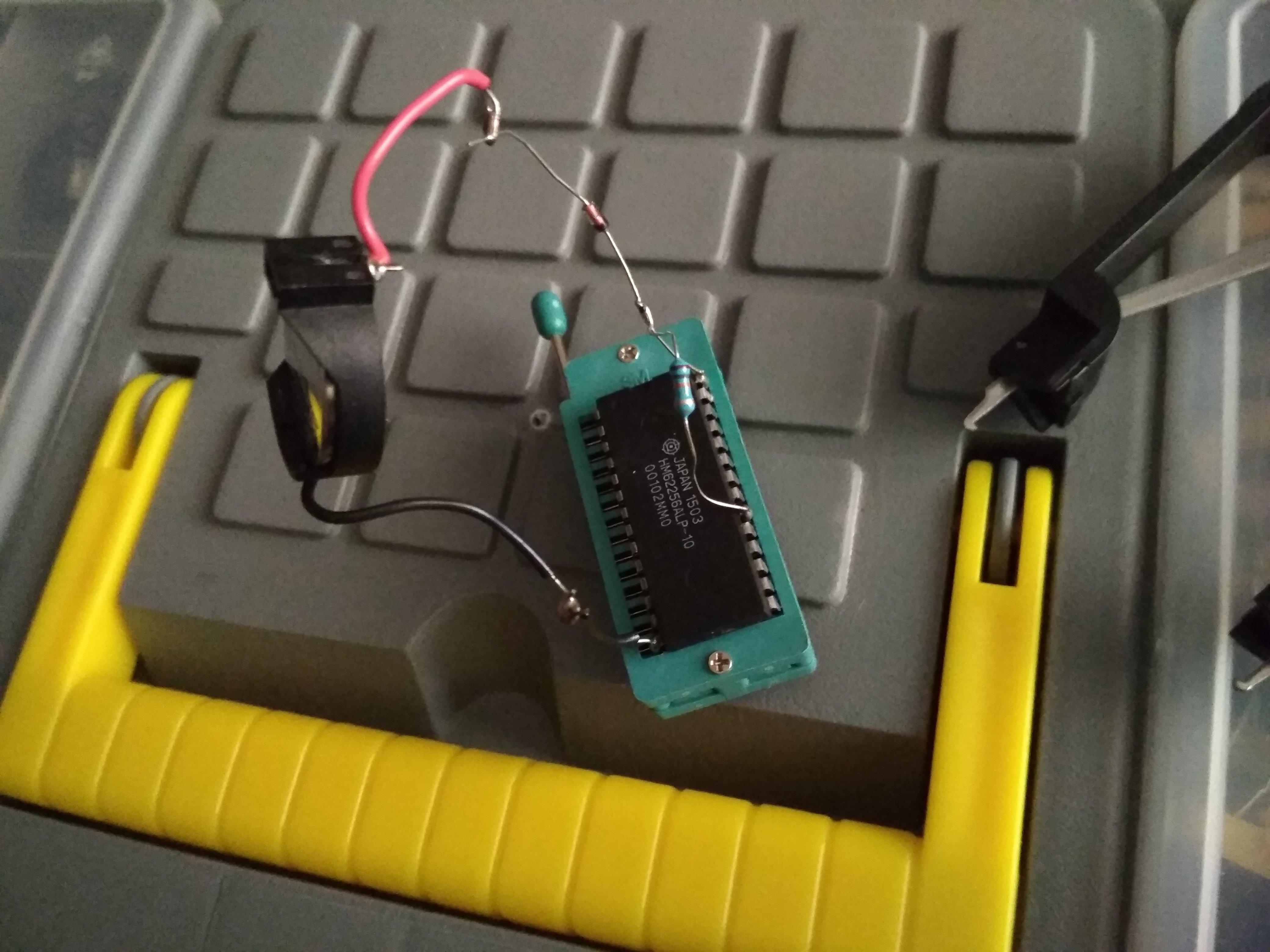

I finally got it to work! I redid the whole assembly, but it looks like the problem was not in the assembly itself. Here is what it looks like now (Note that the ZIF is not part of the assembly and only used here to keep the IC upright for the photo):
It looks like when powering up the arduino and setting some of the pins to outputs it sets them to low by default. This was solved by setting the CE and WE pins to high before setting the pins on the arduino to output.
Here is my code in case it helps anyone in the future:
