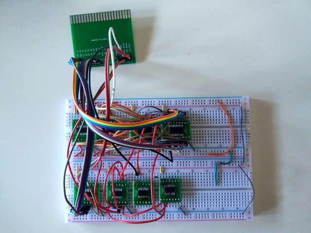

BTW, here's my first contraption :
I'm pretty proud of it... especially since I've also created the Expansion Port adapter, the SOIC to DIP adapters, soldered them myself (My first try at SMD soldering!) and it did work on the first run. Beginner's luck maybe?
Re: 65xx bus timing basics!
Posted: Sat Mar 30, 2019 5:18 pm
by ttlworks
Thanks for posting the picture.
Looks nice.
If you run into trouble with crosstalk between the wires in a ribbon cable when trying to run the design at a higher speed,
making every second wire GND (like with old floppy cables) will fix that problem.
IIRC both ports of the 6526 have open collector outputs.
After you got two registers working (a data register and a direction register),
please take a look at the datasheets of 74125 and 74126
// 74HC(T)125\126, 74AC(T)125\126 etc.
There might be other buffers (or logic gates with open collector output) that might look interesting too,
but when doing a search for them, better check first if they are available as 74AC\74ACT parts.
Posted: Sun Mar 31, 2019 8:44 pm
by daniMolina
Second circuit also worked!
