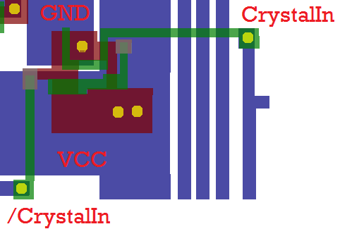

Then we have a superbuffer directly fed by the Crystal input pad:
Which just passes on the inverted oscillator input signal to the Color Clock output buffer.
Note the clock signal /color (inverted color clock), which is tapped from the last stage of the Color Clock output buffer.
It is used for generating the Dot Clock later.

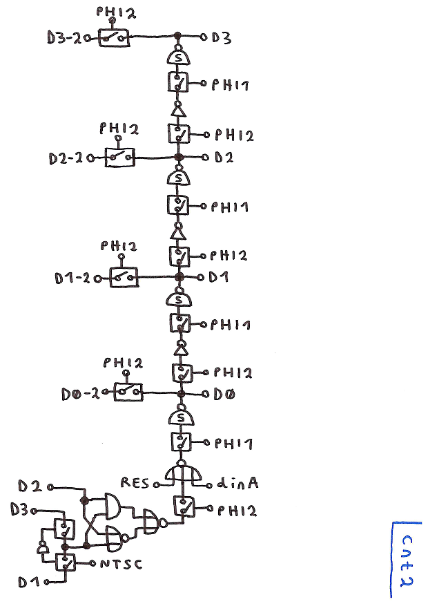

Second, we have a shift register which works as a counter.
Edit: error fixed, there were two latches too many in 8701_cnt2_3.
