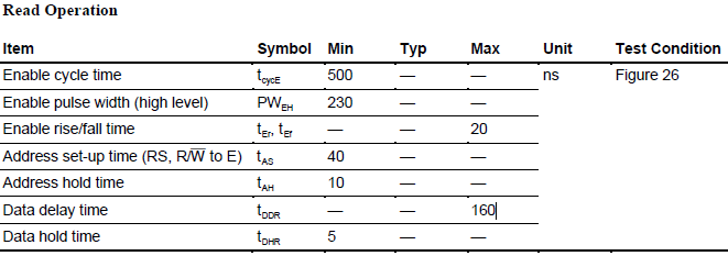

I do not think it is valid to read data after the enable pulse has ended. The data hold time of a HD44780 is specified as 5 ns. Whatever you read 4 cycles later is hi-z and it will be coincidence wether the busy flag still shows correctly (static).
You need to set enable, wait for 160 ns (for which the LDA abs cycles until the input is gated may be enough already), then read the busy flag, then drop enable.

Hmm so I *do* need a timer if PHI2 various/is not set.
[update] Got it working at 10MHz. The issue was caused by the routine that sends commands/data to the LCD still using the old delay40 routine. I replaced the call to delay40 routine with one calling my new BF check.
I still need to test this at 16MHz (max clock my 65C02 GPD design runs at), but don't currently have a 32MHz oscllator can (the 32 is divided by 2 using a D type flipflop to give better rise & fall times). Got an AEL one on order from ebay. If things are still ok at that speed then I'll declare victory on that and start looking trying to implement I2C. To that end, I'll have a reread of Garth's primer.
