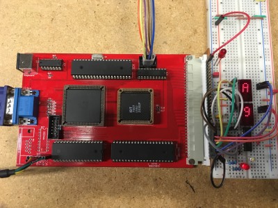

So I finally decided to go the PCB path. After the concepts have been tested with ROMulus the 1st on some breadboards I wanted to build something more durable. ROMulus the 2nd has all the features of the 1st but also has some enhancements. When finished it will (should be) able to emulate an Apple IIe including the double hires mode with 160 x 192 pixels and 16 colors. However due to the design you can convert the system into whatever you want. Everything is "configurable" within limits, that is as long as the CPLD design can be implemented in the CPLD and the given allocation of the PINs fits the design you're save. And as with all the ROMulus there is no ROM, there is only some RAM that emulates ROM, all depends on the CPLD design. It basically features
- A home-brew video controller using a ATmega1284P with 32kbyte dual-port video RAM and VGA output (560x480 pixels, this is due to the fact that I want to use the 7-bit wide original character sets of legacy systems)
- A PS/2 keyboard interface using the ATmega1284P using one of it's USART in synchronous mode
- Initial Machine Load of ROM images through the ATmega (as with the 1st you can have ROM images in flash or download images via XMODEM)
- A ATF1508AS CPLD which holds almost all of the glue logic (a 74HCT14 schmitt-trigger has been added to deglitch the PS/2 signals and a 74HCT573 has been added to support the 32kbyte video RAM via the ATMega1284P, as the CPLD does not provide enough pins)
- 512kbyte RAM
Here is a picture of the PCB
PCB
PCB
as ordered with dirtypcbs.
I'm slowly bringing up the system in several stages. The first stage was to check the CPLD Glue logic that emulates the 74HC166 from ROMulus the 1st
Controller, CPLD and Schmitt Trigger
and also the first color mapping logic which is new in this version of the series. In this stage the internal RAM of the AVR was used as video RAM
Currently I have reached the state where the dual-port RAM and the address latch has been added and a stable VGA signal is created using the dual-port RAM as video RAM
plus Video RAM (DP-RAM) and Address Latch
the only missing parts now are the 512kbyte SRAM and the CPU.
Up to now the process was rather successful, although I had to make same smaller "corrections" to the PCB. But nothing what a Proxxon drill and vero-wire couldn't solve.
More to come

After some more hardware and PCB checks I decided to populate the rest of the essential parts
Fully populated PCB
Fully populated PCB
The missing MAX232 and the corresponding connector is for the RS-232 of the AVR, but currently I'm using a USB-TTL serial adapter and don't need the level shifter. As always software errors are more common than hardware errors and in this case I have to program the CPLD and the bootcontroller (the ATmega1284P) in parallel that makes it even worse. So I added some decent debugging output (in hardware of course) to the bus interface. Now step by step I eliminate the software errors :roll: Fortunately the AVR and the CPLD support a lot of programming cycles.

Seems that there weren't too many errors. The software is still not finished but at least I can load a ROM image and the SBC can take over control. At the moment I was able to load the Apple IIplus ROM image and write programs in Applesoft Basic. PS/2 interface works and 40-column Text Output as well. Now the rest is diligence work. Also so far the two errors in the PCB were really stupid. Both are related to the programming connectors. The AVR ISP interface had MOSI and MISO swapped and the JTAG interface had connected VTG (Vcc Target) to Pin 7 instead of Pin 4.
The following schematic already contains the bugfixes to these errors.

PIN     20  = GM      ; /* Video DAC Green Medium                     */
PIN     29  = RH      ; /* Video DAC Red High                         */
PIN     28  = RM      ; /* Video DAC Red Medium                       */
/* *************** Memory Interface ***********************************/
PIN      4  =!RAM     ; /* Main RAM Enable                            */
PIN     54  =!VRAM    ; /* Video RAM Enable                           */
PIN     30  =!RAME    ; /* Extended RAM Enable                        */
PIN     77  = WE      ; /* Write Enable Video RAM                     */
PIN     80  =!MRD     ; /* Master Read                                */
PIN     79  =!MWR     ; /* Master Write                               */
PIN     31  =!IO65    ; /* 65xx Peripheral Enable                     */
PIN     65  =!IDE     ; /* Disk Enable                                */
PIN     64  =!IOBD    ; /* Another Peripheral Enable                  */
PIN     24  = R16     ; /*                                            */
PIN      8  = R17     ; /*                                            */
PIN     11  = R18     ; /*                                            */
/* *************** PINNODES    *********************/
PINNODE     = Q0      ; /* Language Card                              */
PINNODE     = Q1      ; /*                                            */
PINNODE     = Q2      ; /*                                            */
PINNODE     = Q3      ; /*                                            */
PINNODE     = BK0     ; /* Bank Address                               */
PINNODE     = BK1     ; /*                                            */
PINNODE     = BK2     ; /*                                            */
PINNODE     = BK3     ; /*                                            */
PINNODE     = BK4     ; /*                                            */
PINNODE     = BK5     ; /*                                            */
PINNODE     = BK6     ; /*                                            */
PINNODE     = BK7     ; /*                                            */
PINNODE     = KBD0    ; /* ASCII Keyboard register                    */
PINNODE     = KBD1    ; /*                                            */
PINNODE     = KBD2    ; /*                                            */
PINNODE     = KBD3    ; /*                                            */
PINNODE     = KBD4    ; /*                                            */
PINNODE     = KBD5    ; /*                                            */
PINNODE     = KBD6    ; /*                                            */
PINNODE     = KBD7    ; /*                                            */
PINNODE     = VSHFT0  ; /* ASCII Keyboard register                    */
PINNODE     = VSHFT1  ; /*                                            */
PINNODE     = VSHFT2  ; /*                                            */
PINNODE     = VSHFT3  ; /*                                            */
PINNODE     = VSHFT4  ; /*                                            */
PINNODE     = VSHFT5  ; /*                                            */
PINNODE     = VSHFT6  ; /*                                            */
PINNODE     = VSHFT7  ; /*                                            */
PINNODE     = TEXT    ; /* Annunciators                               */
PINNODE     = MIXED   ; /*                                            */
PINNODE     = PAGE2   ; /*                                            */
PINNODE     = HIRES   ; /*                                            */
PINNODE     = STO80   ; /* Softswitches  Store 80 column              */
PINNODE     = RAMRD   ; /*               RD AUX RAM                   */
PINNODE     = RAMWR   ; /*               WR AUX RAM                   */
PINNODE     = ALTZP   ; /*               ZP, STACK, LC AUX RAM        */
PINNODE     = C3ROM   ; /*               C3-Slot ROM                  */
PINNODE     = CXROM   ; /*               CX ROM                       */
PINNODE     = ALTCH   ; /*               Alternate Character Set      */
PINNODE     = COL80   ; /*               80-column display            */
PINNODE     = L8      ; /* Latched IO Slot Address                    */
PINNODE     = L9      ; /*                                            */
PINNODE     = L10     ; /*                                            */
PINNODE     = TAPE    ; /*  Simulation of TAPE Input                  */
PINNODE     = OA      ; /*  Open Apple Key                            */
PINNODE     = CA      ; /*  Closed Apple Key                          */
PINNODE     = HRES    ; /*  Select between Low-Res and High-Res       */
PINNODE     = GR      ; /*  Select between TEXT and Low-Res           */
PINNODE     = VBL     ; /*  Vertical Blank (VSYNC from Video Ctrl)    */
PINNODE     = IML     ; /*  Initial Machine Load                      */
PINNODE     = IOUDIS  ; /*                                            */
PINNODE     = DHIRES  ; /*                                            */
PINNODE     = I16      ; /*                                            */
PINNODE     = SLOTCK   ; /*                                            */
PINNODE     =  RR16;    /* if deasserted use ROMRD and ROMWR          */
PINNODE     =  VR16;    /* if asserted use PAGE2                      */
PINNODE     =  AR16;    /* if asserted ALTZP is used to assert R16    */
PINNODE     =  CR16;    /* if asserted then directly assert R16       */
PINNODE     =  AUX;     /* RAMWR and RAMRD preselected with RW        */
PINNODE        =  CSHFT6;
PINNODE        =  CSHFT5;
PINNODE        =  CSHFT4;
PINNODE        =  CSHFT3;
PINNODE        =  CSHFT2;
PINNODE        =  CSHFT1;
PINNODE        =  CSHFT0;
PINNODE        =  CLATCH0;
PINNODE        =  CLATCH1;
PINNODE        =  CLATCH2;
PINNODE        =  CLATCH3;
PINNODE        =  CLATCH4;
PINNODE        =  CLATCH5;
PINNODE        =  IOPAGE;
PINNODE        =  SSW;
	IO Map
	C00x	Keyboard / Softswitches
	C010	KBDCLR
	C01x	Status
	C02x
	C03x
	C04x
	C05x	Annunciators
	C06x	Inputs
	C07x
	C08x	Language Card
	C09x	IO65 65xx Peripheral
	C0Ax	IO65 65xx Peripheral
	C0Bx	IOBD Device
	C0Cx	IO65 65xx Peripheral
	C0Dx	IOBD Device 5
	C0Ex	IDE
	C0Fx
	Field Definitions
FIELD  ADDRESS   = [A15..0];
FIELD  IOADDR    = [A7..0];
FIELD  BANK      = [BK7..0];
FIELD  DATA      = [D7..0];
FIELD  CTRL      = [C2..0];
FIELD  VIDEO     = [V7..0];
FIELD  KBD       = [KBD7..0];
FIELD  VSHFT     = [VSHFT7..0];
	Soft Buffer Signal
IOPAGE    = !BK7 & !BK6 & !BK5 & !BK4 & !BK3 & !BK2 & !BK1 & !BK0
          &  A15 &  A14 & !A13 & !A12 & !A11 & !A10 & !A9  & !A8;
	Bank Address Latch
BANK.l    =  DATA.io;
BANK.le   = !PHI2;
	The Keyboard buffer has two functions
	-	During IML it provides the bytes for the boot code
	-	In normal operation it acts as a keybaord input
		where bit7 indicates a key is waiting and can be
		cleared by the CPU by accessing the IO address $C010.
KBD.d     =  VIDEO.io;
KBD.ck    =  WRK;
KBD7.ar   =  IOPAGE & IOADDR:[10] & PHI2;
	Read the video status bits from the CPU
VIDEO     =  [DHIRES, STO80, ALTCH, COL80, HIRES, MIXED, PAGE2, TEXT];
VIDEO.oe  =  RDV;
	Video Shift register
VSHFT.ck  =  CLK;
VSHFT.ce  = !INH;
VSHFT.d   =  VIDEO.io   & !SHLD;
APPEND
VSHFT0.d  =  VSHFT0     &  GR  &  SHLD;
APPEND
VSHFT1.d  =  VSHFT1     &  GR  &  SHLD
          #  VSHFT0     & !GR  &  SHLD;
APPEND
VSHFT2.d  =  VSHFT2     &  GR  &  SHLD
          #  VSHFT1     & !GR  &  SHLD;
APPEND
VSHFT3.d  =  VSHFT3     &  GR  &  SHLD
          #  VSHFT2     & !GR  &  SHLD;
APPEND
VSHFT4.d  =  VSHFT4     &  GR  &  SHLD
          #  VSHFT3     & !GR  &  SHLD;
APPEND
VSHFT5.d  =  VSHFT5     &  GR  &  SHLD
          #  VSHFT4     & !GR  &  SHLD;
APPEND
VSHFT6.d  =  VSHFT6     &  GR  &  SHLD
          #  VSHFT5     & !GR  &  SHLD;
APPEND
VSHFT7.d  =  VSHFT7     &  GR  &  SHLD
          #  VSHFT6     & !GR  &  SHLD;
	Double High Resolution support, together with INH
	every 4-bits the topmost 4 bits are converted to
	a 6-bit colour value as in the icolors table of the
	low-resolution mode.
CSHFT6.ck =  CLK;
CSHFT6.d  =  VSHFT0;
CSHFT5.ck =  CLK;
CSHFT5.d  =  CSHFT6;
CSHFT4.ck =  CLK;
CSHFT4.d  =  CSHFT5;
CSHFT3.ck =  CLK;
CSHFT3.d  =  CSHFT4;
CSHFT2.ck =  CLK;
CSHFT2.d  =  CSHFT3;
CSHFT1.ck =  CLK;
CSHFT1.d  =  CSHFT2;
CSHFT0.ck =  CLK;
CSHFT0.d  =  CSHFT1;
TABLE [CSHFT3..0] => [CLATCH5..0].d {
	Color Mapping Table only produces 6bits. The icolors
	table has RRRGGGBB, we drop the least significant
	bit of R and G.
 'h'0 => 'b'000000;  /* 0x00   Black       */
 'h'1 => 'b'110000;  /* 0xE0   Red         */
 'h'2 => 'b'000010;  /* 0x02               */
 'h'3 => 'b'100010;  /* 0x82               */
 'h'4 => 'b'000100;  /* 0x0C               */
 'h'5 => 'b'010101;  /* 0x49   Grey I      */
 'h'6 => 'b'000011;  /* 0x03   Blue        */
 'h'7 => 'b'001111;  /* 0x1F               */
 'h'8 => 'b'100000;  /* 0x84               */
 'h'9 => 'b'110100;  /* 0xEC               */
 'h'A => 'b'101010;  /* 0x92   Grey II     */
 'h'B => 'b'110110;  /* 0xEE               */
 'h'C => 'b'001100;  /* 0x1C   Green       */
 'h'D => 'b'111100;  /* 0xFC               */
 'h'E => 'b'001110;  /* 0x3E               */
 'h'F => 'b'111111;  /* 0xFF   White       */
CLATCH0.ck = CLK;
CLATCH1.ck = CLK;
CLATCH2.ck = CLK;
CLATCH3.ck = CLK;
CLATCH4.ck = CLK;
CLATCH5.ck = CLK;
CLATCH0.ce = INH;
CLATCH1.ce = INH;
CLATCH2.ce = INH;
CLATCH3.ce = INH;
CLATCH4.ce = INH;
CLATCH5.ce = INH;
	The Video output is limit to 6-bit, 2 bits for each colour.
	The use of bits 7,6,4,3,1,0 as the source comes from the
	icolors table used in ROMULUS1st that had actually 8-bits
	(R:3-bit, G:3-bit, B:2-bit), so we can use the same table.
RH        = !BLANK & !GR & !HRES & VSHFT7
          # !BLANK &  GR & !HRES & VSHFT7
          # !BLANK &        HRES & CLATCH5;
RM        = !BLANK & !GR & !HRES & VSHFT7
          # !BLANK &  GR & !HRES & VSHFT6
          # !BLANK &        HRES & CLATCH4;
GH        = !BLANK & !GR & !HRES & VSHFT7
          # !BLANK &  GR & !HRES & VSHFT4
          # !BLANK &        HRES & CLATCH3;
GM        = !BLANK & !GR & !HRES & VSHFT7
          # !BLANK &  GR & !HRES & VSHFT3
          # !BLANK &        HRES & CLATCH2;
BH        = !BLANK & !GR & !HRES & VSHFT7
          # !BLANK &  GR & !HRES & VSHFT1
          # !BLANK &        HRES & CLATCH1;
BL        = !BLANK & !GR & !HRES & VSHFT7
          # !BLANK &  GR & !HRES & VSHFT0
          # !BLANK &        HRES & CLATCH0;
	System Control and Inputs. Note that these signals are not
	cleared on power up, it is the task of the video controller
	to initialise these system control bits.
[IML, VBL, WE, GR, HRES, CA, OA, TAPE].l  = VIDEO.io;
[IML, VBL, WE, GR, HRES, CA, OA, TAPE].le = WRC;
	CPU data read interface. The CPU can read various
	status bits and the keyboard buffer from the CPLD.
	The status bits can be read via D7 as in the Apple IIe.
	Bits 0..6 are directly connected to the lower 7 bits
	of the keyboard buffer. When IML is asserted the CPU
	just reads the keyboard buffer. This is used to initially
	load the ROM image. In this mode CPU reads always read
	the byte in the keyboard buffer and writes go to the RAM.
[D6..0]   = [KBD6..0];
SSW       =  !A3 & !A2 & !A1 &  A0     & !Q3
          #  !A3 & !A2 &  A1 & !A0     &  Q0
          #  !A3 & !A2 &  A1 &  A0     &  RAMRD
          #  !A3 &  A2 & !A1 & !A0     &  RAMWR
          #  !A3 &  A2 & !A1 &  A0     &  CXROM
          #  !A3 &  A2 &  A1 & !A0     &  ALTZP
          #  !A3 &  A2 &  A1 &  A0     &  C3ROM
          #   A3 & !A2 & !A1 & !A0     &  STO80
          #   A3 & !A2 & !A1 &  A0     &  VBL
          #   A3 & !A2 &  A1 & !A0     &  TEXT
          #   A3 & !A2 &  A1 &  A0     &  MIXED
          #   A3 &  A2 & !A1 & !A0     &  PAGE2
          #   A3 &  A2 & !A1 &  A0     &  HIRES
          #   A3 &  A2 &  A1 & !A0     &  ALTCH
          #   A3 &  A2 &  A1 &  A0     &  COL80;
D7        = !IML & IOADDR:[00..0F] &  KBD7
          # !IML & IOADDR:[10..1F] &  SSW
          # !IML & IOADDR:[60]     &  TAPE
          # !IML & IOADDR:[61]     &  OA
          # !IML & IOADDR:[62]     &  CA
          # !IML & IOADDR:[7E]     &  IOUDIS
          # !IML & IOADDR:[7F]     &  DHIRES
          #  IML                   &  KBD7;
[D7..0].oe = !IML & IOPAGE & IOADDR:[00..1F] & RW & PHI2
           # !IML & IOPAGE & IOADDR:[60..7F] & RW & PHI2
           #  IML                            & RW & PHI2;
	Double Hires Support Flags. This is only for accuracy but not of
	any functionality.
IOUDIS.CE = (IOPAGE & IOADDR:[7E..7F] & !RW);
IOUDIS.CK = !PHI2;
IOUDIS.D  =  A0;
IOUDIS.AR =  RES;
DHIRES.CE = (IOPAGE & IOADDR:[5E..5F] & !RW & IOUDIS);
DHIRES.CK = !PHI2;
DHIRES.D  =  A0;
DHIRES.AR =  RES;
	Latch to hold the last IO Slot ROM accessed.
SLOTCK    = BANK:[00] & ADDRESS:[C100..C7FF];
[L8..10].AR =  RES;
[L8..10].LE =  PHI2 & SLOTCK;
[L8..10].L  =  [A8..10];
	Language Card
[Q0..3].CK  = !PHI2;
[Q0..3].CE  =  IOPAGE & IOADDR:[80..8F];
[Q0..3].AR  =  RES;
Q0.D      =  A0  &  A1
          # !A0  & !A1;
Q1.D      =  A0  &  RW;
!Q2.D     =  A0  &  RW  &  Q1
          #  A0  & !Q2;
Q3.D      =  A3;
	Softswitches
STO80.CE  =  (IOPAGE & IOADDR:[00..01] & !RW);
STO80.CK  = !PHI2;
STO80.D   =  A0;
ST080.AR  =  RES;
RAMRD.CE  =  (IOPAGE & IOADDR:[02..03] & !RW);
RAMRD.CK  = !PHI2;
RAMRD.D   =  A0;
RAMRD.AR  =  RES;
RAMWR.CE  =  (IOPAGE & IOADDR:[04..05] & !RW);
