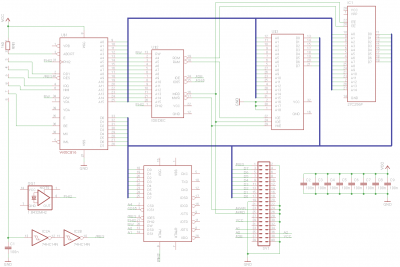

But now to the real subject. I have hear a very strange problem. Strange in a sense that I have no clue how I should further debug the issue. Here some background information.
I have a 65C816 based system and use a CF-Card as the main storage. For this I used normal CF-Card IDE-40 PIN Adapters and connected the IDE directly to the CPU BUS. That is the IDE is connected to A0, A1, A2 and D0..D7 of the CPU. IORD and IOWR are qualified with PHI2 and CS0 is the select signal all these signals are created using a GAL22V10. CS1 is tied to VCC. Very much the same as in Grants Z80 CP/M setup.
Now the strange thing: I have one CF-Card IDE-Adapter that works perfectly with all CF-Cards I have tested so far. I can boot, read and write files. But all other CF-Card Adapters fail. Even a CF-Card Adapter that is identical to the one that works does not work.
I have started to write test programs and what I see with the non-working Adapters is that I do not get all bytes from a block. For example if I check DRQ then I do not get 512 times a DRQ when transferring the block/sector.
It actually does not matter If I run the system with lower clock speeds (I tried anything from 100kHz to 5MHz). The working adapter works perfectly with any clock rate.
I'm completely lost and any idea how I should proceed is appreciated.

Well, my theory may not have a bearing on your situation at all, but it seemed worth mentioning. Can you supply more info, Peter -- photos, maybe, and more detail re the signals involved? Also -- just double-checking -- you mean you tied directly to the '816 multiplexed data bus (NOT downstream of a '245 transceiver)?

good point, perhaps I should try to connect all unused pins to GND / VCC one after the other until I see a change in behavior. Either to the good or the worse. It's really as if the only CF-Card Adapter that works is only working by chance and not be design. However the fluke is quit reliable, even when I reconnect all connections to test other CF-Card adapters and then go back the working one this one never fails.
And yes I have connected the CF Card directly to the CPU, no '245 or whatsoever. I don't see any reason why this should be a problem IORD and IOWR are gated with PHI2 so the bus-states of all data pins are as they would be using a '245. Also if this is an issue then why is one CF-Card adapter working and the other's not, which brings us back to your first point. So I will do this first. I need to understand the difference in the behavior.

I didn't mean to imply it was incorrect. I'm just trying to get more background, as you haven't posted a schematic. It may be fairly trivial, but I don't trust myself to simply imagine it.

I checked all wires and signals and found one major issue. The working adapter is defect!!! The trace from VCC of the CF Card slot to the power connector is broken. As a cross check I attached one of the non working adapters to the 65C816 system but did not connect VCC (5V) to the CF adapter and the system boots perfectly from this setup. I suppose one of the inputs tied to Vcc (DMACK and CS1) provides power to the CF CARD. But I don't understand what really happens and why a correct setup with a working VCC connection does not work but one without VCC does. Any ideas?

Huh! You've confirmed the theory that it's the seemingly correct unit which is anomalous, rather than the superficially suspect units -- the ones which don't work. But I'm still puzzled. You still haven't posted a schematic, Peter!
Meaning the CF's Vcc is powered from current flowing through the on-chip input-protection diodes? That sounds logical. Which brings a thought to mind...
Correct me if I'm wrong, but I thought CF cards (or at least some CF cards) are supposed to run on 3.3V, not 5V. And if the card is powered through its input-protection diodes then there'll be a voltage drop, meaning that the card sees not 5V but something closer to its 3.3V spec. In those conditions the CF could be reliable, but with the full 5V applied maybe it becomes flaky. Can you confirm the rated voltage and actual voltage, please?

Here the current schematic.
CF Card System
CF Card System
As for CF-Cards those with the parallel interface all support 5V (they must support 5V operation in order to meet the ATA standards) and most work with 3V3 as well.

Well, I'm no expert on CF cards, but I still think the theory of a voltage drop across the input-protection diodes bears investigation. For one thing, the issue you're facing is pretty clearly related to power. And, the adapter in the photo Aslak3 posted above has a jumper that pertains to 3 volts vs 5 volts. Granted, most CF's may work with 5V or 3V3 as you say, but apparently they don't just automatically accept whatever voltage they get.
Just thinking out loud...
