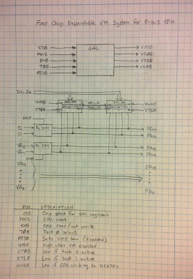

Some time ago I looked into building a MMU for an 8-bit CPU like the 6502 and concluded that it would be a job best suited for a CPLD or FPGA. However, the problem was nagging at me for some time so thought about an extremely simple, but expandable system based on off-the-shelf logic chips and came up with the following four-chip solution (more if you replace the single GAL with discrete logic):
Simple Expandable VM System
VA15..VA0 ("virtual address") are the 16 CPU address lines. PA17..PA0 ("physical address") are the 18 physical address lines. D7..D0 is the 8-bit data bus.
The schematic is missing a few details, but the basic idea is, I think, fairly clear. To summarize:
Four 16K pages are mapped into 256K of physical memory for two separate tasks (unfortunately a necessary compromise for simplicity's sake). One task would ostensibly be the supervisor task and the other would be a user task. The MMU is disabled (1/2 of the 74HC244 is used to accomplish this) when the system is reset and remains this way until the operating system switches it on. A 74HC670 4x4 register file is used to manage the mapping for each task. Two tasks are supported in this system thus two HC670s are used. Finally, a GAL is used (a 16V8 is probably adequate) for the glue logic in order to keep the chip count down. It could probably be replaced with 2-3 standard logic chips but as I haven't worked out the exact input/output relationships yet I'm not exactly sure.
Since the GAL will have additional inputs available, the chip select line can be replaced with appropriate physical address lines and address decoding combined with the simple VM system in order to further reduce chip count. The key to the relative simplicity of the design is the dual ports on the 74HC670. It is unfortunate that nothing larger than 4x4 is available in the 7400 logic family.
Once upon a time there were some nice single-chip options available for this problem in the form of the MC6829 and the 74LS610 but I don't think those parts are generally available any more (if I'm wrong, please let me know as I'd love to get my hands on a couple of them).
My intent in presenting this outline here is not to present a complete tested working system (at least not yet) but rather to simply present the idea and hopefully generate some discussion about it. I noticed a couple of earlier threads on MMUs but didn't see any concrete designs other than suggestions to use a 65816 and rely on its segmented architecture (no thanks), or find a MC6829 or 74LS610 somewhere and use it.
The 74HC670s have a relatively low propagation delay which is typically under 15 nS so the impact of this particular design on the maximum system clock frequency should not be too bad.
It is a job best suited for one of those devices. Aside from the consolidation of a lot of logic into one device, any reasonably good MMU scheme using discrete hardware is going to be slow and bulky. Your design is using 74HC hardware, which is no faster than 74LS. Readily available CPLDs and FPGAs are usually 10ns pin-to-pin or faster.
I noticed a couple of earlier threads on MMUs but didn't see any concrete designs other than suggestions to use a 65816 and rely on its segmented architecture (no thanks)...
The 65C816's architecture is not segmented. It's banked, and the banking aspect is primarily a concern with executable code, not data—wrapping PC will not increment PB. Yes, direct page and the stack are confined to the first 64KB of memory, and some vector code has to be in that range as well to handle interrupts, but even that could be dealt with with sophisticated programmable logic. Data accesses can go anywhere in the addressable range without fiddling with DB, so they are generally bank-agnostic.
In any case, if the idea is to create a protected execution environment there will be much more to it than giving programs a nice, warm place to sleep. In that respect, the '816 has a sizable advantage over the 65C02. This is not to say that it can't be done with the 65C02, only that you will be moving mountains to plant a tomato garden.
The only delay of any real consequence in my design is that of the HC670 -- which is according to the datasheet has a propagation delay which is typically under 15 nS. Good enough for me. The GAL is available with a pin-to-pin delay as low as 5 nS, though it would not be a limiting factor in this scheme.
I think we had this discussion before with regard go implementing a UART on a PIC. I can't say that I'm unhappy with my results.
In any event, the purpose for this MMU is not just for a 6502, it is for other 8-bit CPUs with a 16-bit address bus like the 6309/6809 as well. The above MMU is also capable of providing a protected execution environment. Since all chip selects in the system are derived from physical addresses the mapping can be arranged by the O.S. so that only task 0 will have access to hardware devices. Task 0 will be the supervisor process.
While there is much to be said for working with FPGAs, I'm not trying to build a product here so I'm not concerned with making the best use of available technology in terms of performance, cost, or efficiency. Instead, I'd like to build something simple and understandable. You know, like the 6502 itself. Something that doesn't require sophisticated tools with steep learning curves to master, something that can be used to assemble a working computer on a breadboard over a course of a few evenings in order to learn and play with concepts. The GAL is a bit of a quandary, but it can be replaced with discrete logic chips if desired.

The '612 can be found on Ebay in both LS and HCT. Currently the '610 can also be had in LS.
I am working on a scheme to put up to 512K inside a VIC-20 using a 74HCT612. The Mapper will be used slightly differently from as intended. Any 8K chunk of memory can occupy any of VIC's eight 8K Blocks (except BLK4, where I/O is, and BLK0, which is shared with the Vid controller), including "shadowing" of the System O.S. and Basic Interpreter ROMs. Any 8K of RAM can be Write Protected and banked with any external memory, if present.
Since the '612 has 16 Map Registers and I'll need only 8 at any given time, I should be able to change the entire map by changing a single bit in a separate Configuration Register, which already exists in a modification I did decades ago. Another bit in said config. reg. would disable Mapping until auto-starting code in an EEPROM in BLK5 initializes the '612 registers.
Another possibility is to use a dual-port RAM, which shouldn't be as hard to find as a Memory Mapper. I abandoned this idea because it seemed pricey considering that only 16 locations out of 1024 would be used.
In lieu of the '612, I suppose one could use an EPROM to emulate the '612's behavior. The fastest EPROMs currently available (e.g., the AMD 27C256-55) are well beyond the performance requirements of a 1 MHz machine like the VIC-20. Even faster is the Atmel 27C256 PROM, which is rated at 45ns (I have one in POC V1 right now). Also possible, I would think, would be synthesizing the function of the '612 in a 22V10 GAL.
The trouble with using old silicon like the '612 is performance tends to be lackluster, fanout may be weak and the available sources may be dubious in nature. In particular, buying chips off eBay runs the risk of being sold a counterfeit.

Thanks! Just found a couple of them there. Performance is disappointing (75 nS worst case access time) but it should be adequate for speeds up to 4-5 MHz assuming one uses relatively fast memory with it).
That is a bit different from what I had in mind, but it makes sense if you want to maintain compatibility on a retro system that was never designed to be used with an MMU.
That is more-or-less what the 74HC670 is. You still need some additional logic to go with it to build an MMU, but that's the heart of it. Which dual-port RAM were you looking at?
