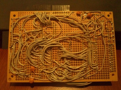

Good afternoon everybody. Well, thanks for your reply. I'll show you some of the projects...
a) Another W65C02S serial-comm board... (Utopia 3 - internal name, hehe...):
Top view:
W65C02S Utopia 3 board (top view)
Bottom view:
Utopia 3 board (bottom view)

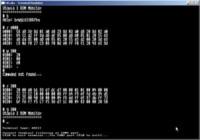

b) Views of the ROM monitor:
Initial screen:
Rebooting the computer...
Entering some commands:
(some commands are r: read memory; w: write memory; g: jump to address, etc.).
The serial comm is configured at 600 bps to feel how an old terminal/teletype feels...
(continue on next post...)

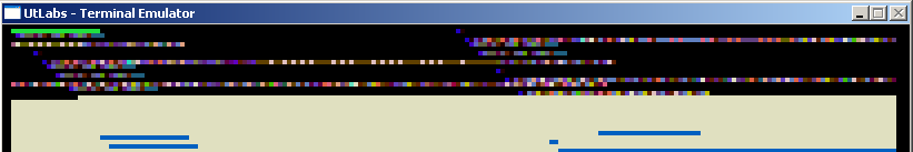

Well, let's continue with the serial terminal. I'm writing this serial terminal software because I think it will be cool if a terminal emulator could show text/colors/graphics like an Atari/Commodore/Acorn/Spectrum computer. These are its (actual) characteristics:
a) 3 modes of text: mode 0 (text with 1 foreground and 1 background colors); mode 1 (text with foreground/background colors and black background for zones where there is no text); and mode 2 (text with foreground/background colors attributes for each character at screen).
b) 4 modes of bitmap graphics: modes 3 to 6 with 16/256 colors/pixel.
c) Control characters (for configuration of the terminal via serial port).
d) Definition of bitmap fonts of 8x8 pixels.
e) Development with CodeBlocks (MinGW) + Allegro 4 (graphics library) for Windows (I think it could be easyly ported to GNU/Linux).
Photos:
50 column mode:
Text color attributes:
Graphic mode pixels example:
