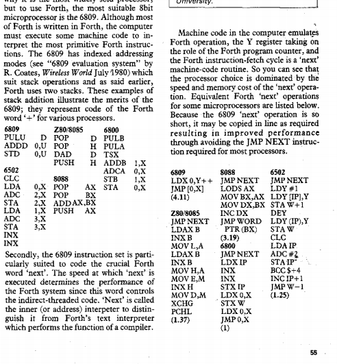

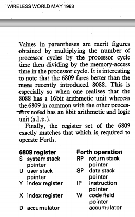

In 1983 the UK magazine Wireless World published a computer kit project followed by three articles about the Forth language. It's a 6809 machine and was intended to run Forth, although I don't suppose there's anything very Forth-specific about the hardware - it has 8k ROM and 16k to 48k of RAM. The author, Brian Woodroffe, does have a quick look at available CPUs and picks the 6809 as being a particularly good fit - it can do a fast NEXT. See the bottom of the third page of the first article and the top of the sixth. In fact, let me paste it here:
