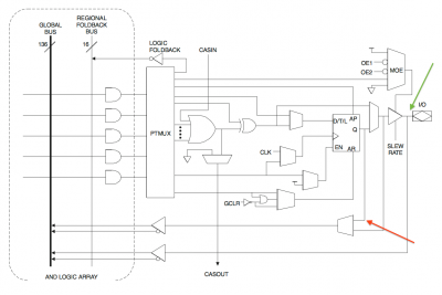

by cbscpe
Hi Garth,
the first I get with your search terms is the download page for WinCUPL from ATMEL. I searched a lot in various search machines and any combination of cpld, atf150xx and wincupl shows more or less the same information.
Macro Cell
Macro Cell
Perhaps a picture of what I want shows what I want to achieve. I have a registered cell and I want to feedback the output Q (red arrow) to be used internally but still I want to be able to read the state of the register via the tri-state buffer (green arrow), which of course requires that the MUX between the tri-state buffer selects the path from Q.
Generally speaking, I'm looking for a manual that explains which extension must be used to select a given path or set a specific MUX. According to the help this is the default. But it's not working. And the extension to force the default (.dfb) generates a warning.
Peter
