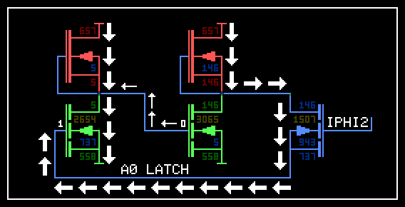

If t2654’s gate terminal is pulled high, it is turned on before power source is able to detect the ground source through t2654’s n-type channel. The hole charge flows from the power source onto node 5 and the electron charge flows from the ground source onto node 5 while the current is flowing on node 5 toward the ground source from power source because depletion transistor’s n-type channel and t2654’s n-type channel are “closed” or “turned on”.
The t3065’s gate terminal is able to detect the high current on node 5, but the high current weakens to become low current in causing the t3065’s n-type channel to be “opened” or “turned off”.
If t2654’s gate terminal is pulled low, it is turned off before power source is unable to detect the ground source because t2654’s n-type channel is opened. The hole charge flows from the power source onto node 5 and no electron charge flow from the ground source onto node 5.
The t3065’s gate terminal is able to detect the high current on node 5, but the high current cannot weaken to become low current in causing the t3065’s n-type channel to be “closed” or “turned on”.
I am not certain how I can better explain these words in writing. Please explain how hole charge, electron charge, and high/low current work on any node.
I drew my diagram. The moving white thick arrow is the high current and the moving white thin arrow is the low current. You will be able to have an idea what I am saying.
Transistor Diagram.png (4.55 KiB) Viewed 2506 times

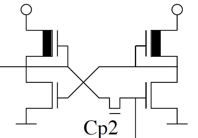

I drew a better schematic than before. Each transistor has four ID numbers. Four ID numbers are drain terminal, gate terminal, source terminal, and transistor. The first drain terminal’s ID number is on the top. Second transistor’s ID number is between drain terminal and gate terminal. Third gate terminal’s ID number is between transistor’s ID number and source terminal. Fourth source terminal’s ID number is below the gate terminal.
The transistor’s ID number is colored in dark yellow.
The gate terminal’s ID number is colored in dark blue.
Both drain terminal’s ID number and source terminal’s ID number are colored in either dark red, dark green, or dark blue.
Notice that the top depletion transistor’s drain terminal does not have the plus sign in circle, but it only shows a horizontal line on the power source. I chose to omit the plus sign in circle in order to save the pixel space due to very large diagram.
All the ID numbers are needed in case if you make mistake to identify the wrong transistor in drawing the big schematic. My schematic looks very neat and clear as long as it is much better than I made my efforts to draw my own schematic and it did not look good in the past.
The color is painted in dark because it is annoying for you to read the ID number while looking at each transistor. When you sit little farther from the monitor, you will be able to see each transistor without noticing the ID number. When you want to read the ID number and compare it to visual 6502 schematic, you sit closer the monitor.
There are some node names across the schematic.
Transistor Diagram2.png (5.01 KiB) Viewed 2506 times
Please comment what do you think my schematic.

Re: Do 6502 microprocessor support negative voltage?
Bryan Parkoff wrote:
It's true that depletion mode transistors are always on, but it may be worth noting that they are more strongly on when their gate voltage is higher. Therefore they are slightly more power efficient than resistive pullups, at a given speed.
If five voltage or zero voltage is applied to the depletion transistor’s gate terminal, then the depletion transistor ignores the request from gate terminal while it is always turned on permanently until the 6502 microprocessor is turned off by the power supply. Why did visual 6502 show depletion transistor when it is turned on in orange node and turned off in yellow node?
Indeed, logically a depletion mode device is always on. Electrically it is always conducting, but the current is modified according to the gate voltage. Visual6502 is operating at a logical level, but of course to make even a simple inverter simulate correctly it's necessary to model the depletion mode device with some subtlety - it must pull up, unless there is an active pull down.
I think your schematics would be easier to read if you used a conventional symmetric three-terminal symbol for the FETs. See Balazs' work, and the snippets on the visual6502 wiki.
Let me try to understand what you're saying about the ALU. You mention:
- transistor t2654 whose gate is a0 and which is the pulldown of a simple inverter
- node 5 which is the output of the inverter
The idea of an inverter is that a high input causes a low output. A high input will turn the pulldown transistor on, which will dump any charge on the output node to ground, and will also sink the remaining current from the pullup, which is now weakly on. When the input is low, the pulldown is off, and the pullup's current will charge up the output node.
When describing the static situation in an NMOS circuit, it's enough to speak of what voltages are on which nodes. Currents can be ignored, as they only play a part in any switching behaviour. That's because NMOS transistor gates are capacitors, and once charged up or discharged the transistor is either on or off.
- transistor t3065 whose gate is node 5, the output of the above-mentioned inverter
As it happens, this is also the pull down of a simple inverter. But electrically that's not entirely obvious, because the output of the inverter goes through two pass gates: one (t1507) is acting as the feedback path for this storage element, and the other (t2363) is acting as a tristate control to connect the output of this storage element to the Special Bus.
It is a challenge to automate the identification of each transistor's role, as a pulldown or a pass transistor or tristate. In fact these roles are not always local properties, but they can usually be determined when taking into account the control logic.
I notice you mention hole charge and electron charge. I don't think that's useful! You only need to speak of high voltages and low voltages, which correspond to charged or discharged capacitors (aka transistor gates.) You only need to speak of currents when you are speaking of transitions from high to low or vice versa.
About your second diagram: that very shallow and compact cross-over is not a good idea. I think you should group the transistors according to the logic gates they form, and put space between them. It should be more obvious that we have two logic gates on the left side, and that they are cross-coupled. The cross-over angles should be 45 degree slopes. Make sure you use space to help the eye see where the boundaries are and which things are closely related.
Hope this helps.

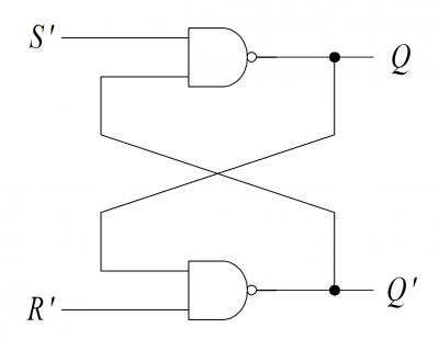

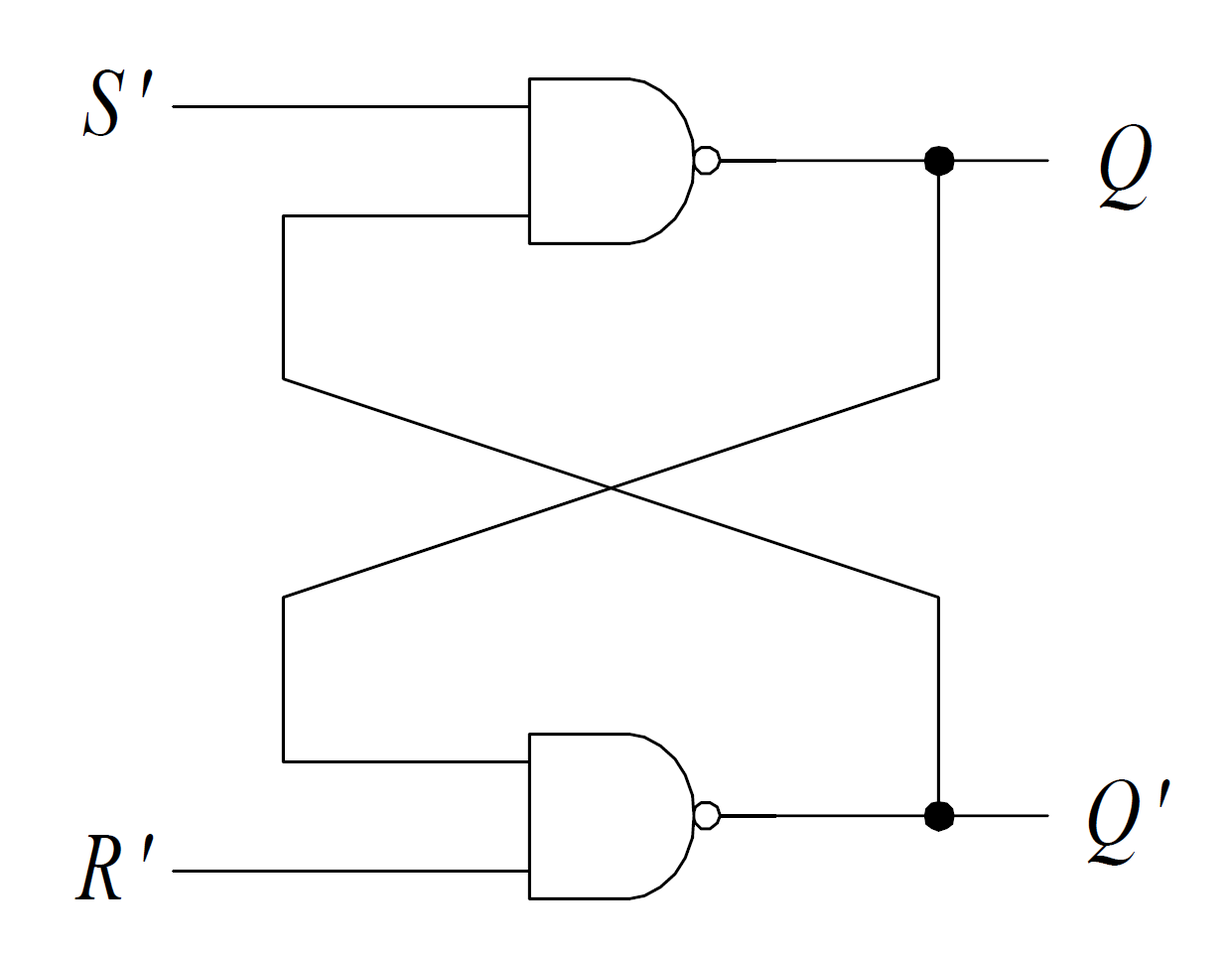

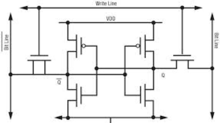

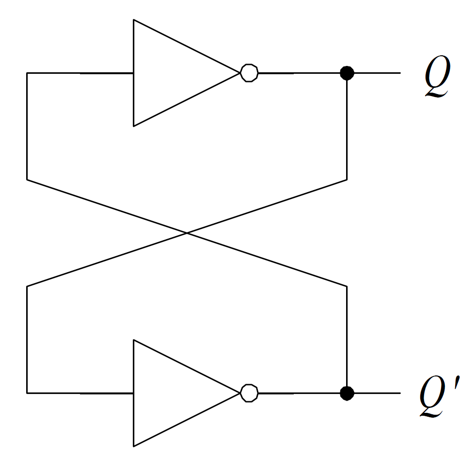

I am not sure what you are referring two logic gates on the left side. Are you talking about two inverters as latch? Look at two diagrams below.
First Latch:
Second Latch:
Which first latch or second latch diagram do you like? I prefer "second diagram from previous post I created myself" because you suggested: power is on top, ground is on bottom, input is on left, and output is on right.
Accumulator register has two inputs and two outputs. I should group two inputs as they treat to be feedback from special bus and node 146 as output from second inverter. I group two outputs as they treat to be tri-state control. I group two inverters as they treat to be latch.
Two inverters do not have SR latch. What do you call latch? Buffer latch?
If you like either first latch or second latch diagram, why did SR latch of NOR / NAND logic gate symbols show first NOR / NAND logic gate symbol on the top and second NOR / NAND logic gate symbol on the bottom by cross coupling?
Compare two diagrams of buffer latch and SR latch to my second diagram on previous post as first NMOS transistor symbol on the top and second NMOS transistor symbol on the bottom by cross coupling.

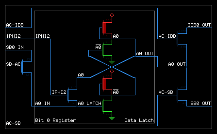

Please look at my diagram. I made some changes according to your suggestion.
What do you think? Is this diagram big enough? Do I need to add little more details like "Input Enable", "Output Enable", and "Clock Enable"? Do you expect that more labels on the diagram is more readable?
Bryan
Hi Bryan
I strongly prefer the symbols used in your attachment latch2.png - they are simpler, and less visually distracting, than the symbols you're using now.
I do prefer the new cross-over angle and spacing!
Yes, I think it would help to label functions like clock, enable, reset and so on.

My question is not answered. I asked what latch is called for accumulator register since it does not have SR latch. What is the name of latch? Do we call buffer latch?
Some logic gate symbols include transistor symbol. The transistor symbol is treated as a switch because buffer tri-state symbol can't be used as it has five transistors. Do you know if there are other symbols rather than showing transistor symbol on the logic gate symbols?
Hi Bryan
yes, I do prefer the new cross-over and spacing, but I still don't like the transistor symbols. They are too cluttered.
The A register storage elements are clocked D-type latches, I think. They have an enable and a clock. But there might be a more accurate name.

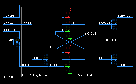

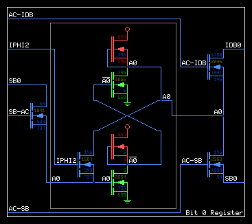

I will like to hear your feedback about the third version of schematic. I made few changes. I added more descriptive labels. My diagram looks better. All the identifications of nodes and transistors are in very dark color.
Can my question please be answered? Are you able to read dark color labels? Can you easily ignore them while looking at each transistor symbol? Look at A Reg1.png below.

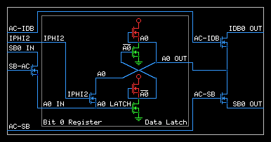

A Reg1.png (7.07 KiB) Viewed 2396 times
Do you like it? I hope anyone will comment as soon as possible.
Are you referring that the transistor symbol contains an arrow line between drain terminal and source terminal? If the arrow line is removed from the gate terminal, then transistor symbol is more readable? No more broken line in the enhancement transistor symbol and add fat line in the depletion transistor like latch2.png. I plan to draw in the second version of schematic.
Great, yes, if it's like latch2.png then I think it will be much more readable.

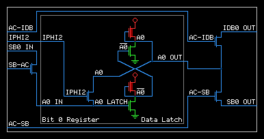

The second version of schematic is on A Reg2.png below.
A Reg2.png (5.59 KiB) Viewed 2396 times
What do you think? Do you like color as red, green, and blue on each transistor?
I made an effort to save space by 50% Look at two diagrams below.
A Reg3.png (4.61 KiB) Viewed 2396 times
A Reg4.png (4.32 KiB) Viewed 2396 times
Which is better do you like A Reg1/2.png or A Reg3/4.png?
Hi Bryan
the simpler transistors in images 2 and 4 are much better.
As for the dark labels, no, sorry, I can't see them. Only with the monitor turned up painfully bright and with 300% scaling can I see them. Bear in mind that I'm in my mid-50s. Well, early 50s. As we age much less light gets into the eye.
But trying to label everything everywhere is probably not a good plan - knowing what to exclude can be as important as knowing what to include. As a simple example, you have A0 appearing twice - where it is made, and where it is used. That's redundant when the wire between them is relatively short.
On your second post: you like to connect all the pulldowns to a single ground. I think this makes for more clutter and makes the shape of the pulldown tree harder to see. Separate grounds is visually simpler, and exactly the same electrically.
On the transistor colours: maybe it helps to use a different colour for pass gates, but blue is a bad choice I think, if you are going to use colour at all, because it's the same as the wires. Maybe yellow would be better.
